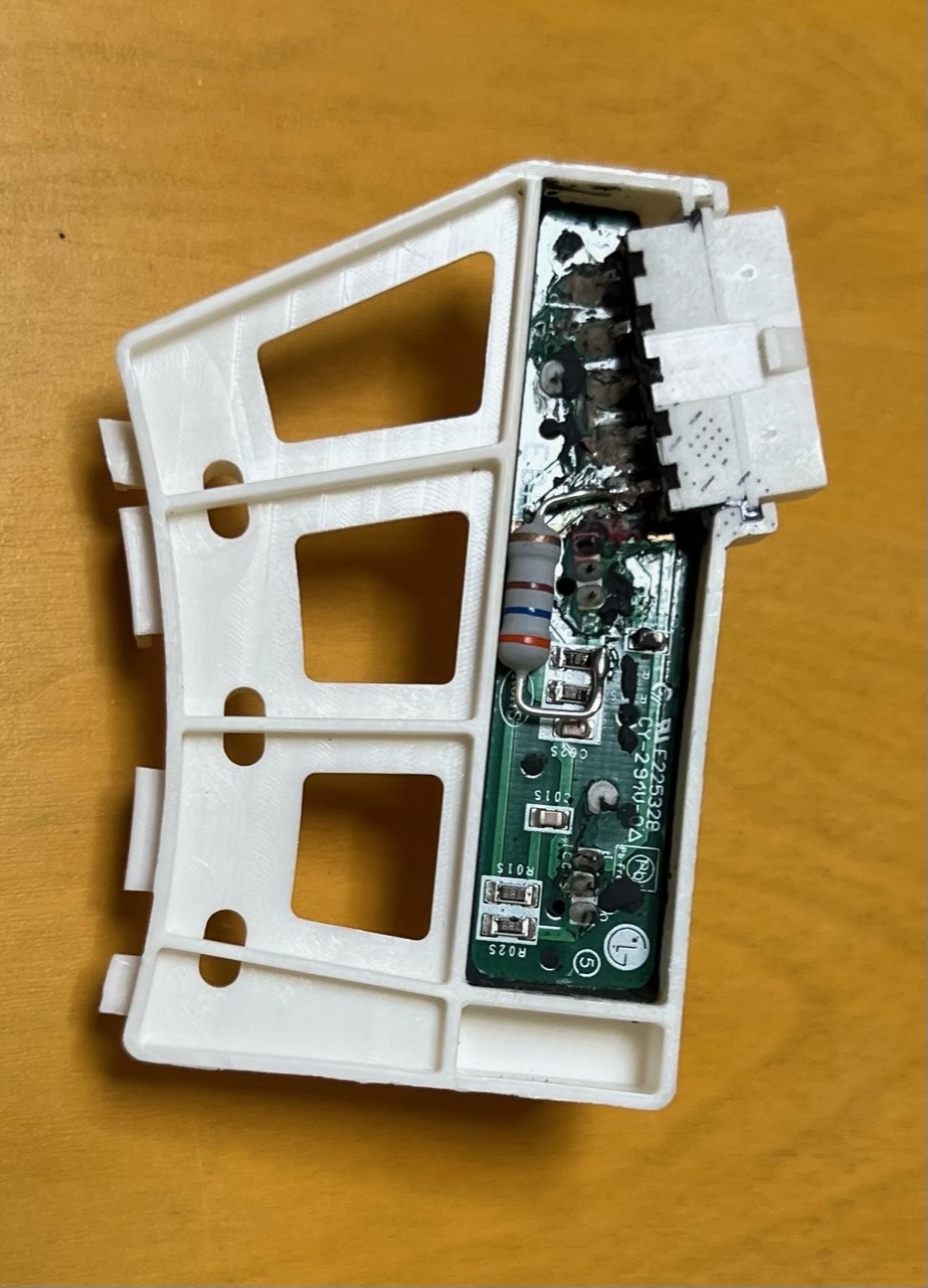

Hall effect sensor for an LG washing machine. Two 680 ohm SMD resistors failed open. Since they were in parallel I just replaced them with a 1/2 watt 360 ohm through-hole resistor from my junk box. I didn't bother removing the old ones, though I probably should have.

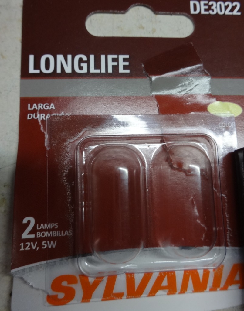

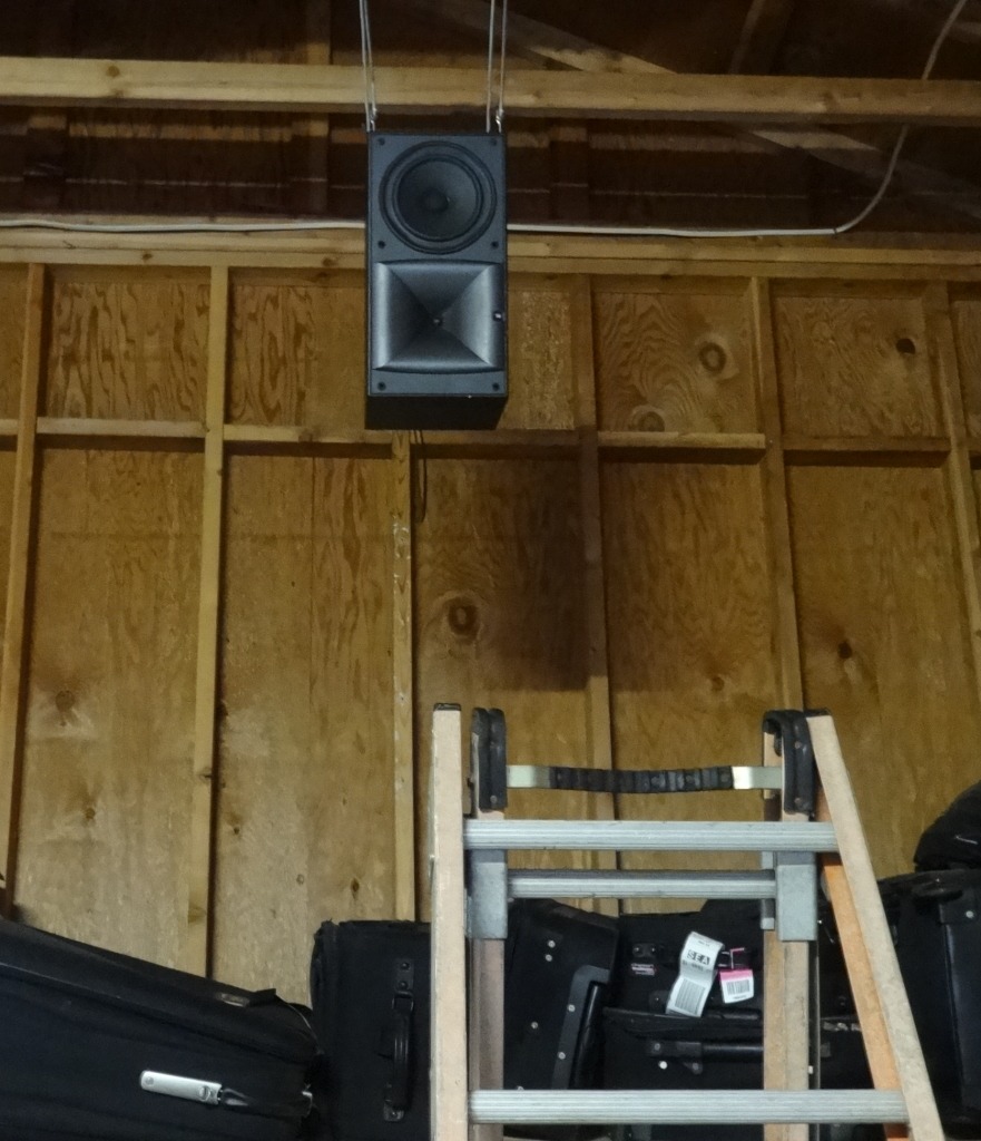

Finally replaced the tweeters (Had spares on hand for such an event) in my garage rafter hanging HLS 610s. I didnt take them down to do it...
Tools used;
Modification Components;
With a little luck, I wont be going up there again anytime soon. I choose the 5W @12V lamps for tweeter protection; could have selected the 12 Watters. They play correctly now and the Rane amp sounds fine driving them. I was tricked into believing the Rane had an issue, as I had apparently blown the tweeters just previously to unboxing it and connecting it up. Very humiliating for me from all angles -

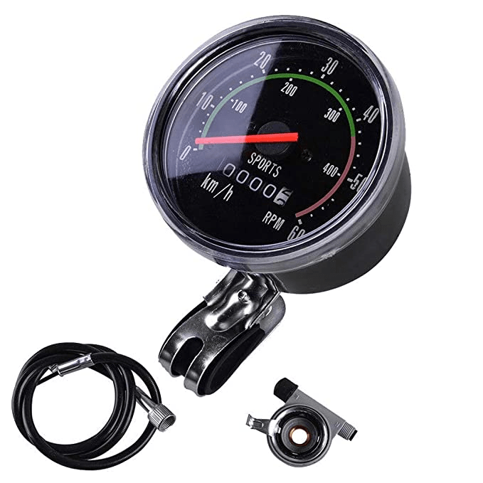

Hee hee! I remember those from when we were kids! They were kind of a status symbol. 😎 (I think I bought mine with some of my newspaper route money.) There was a noticeable drag on the front wheel from the gear/ cable system - I do prefer the modern magnet/ reed switch approach, even though those old ones looked cooler!
Actually, most new analog motorbike and car meters are 270 degree or less sweep electric meters, not connected mechanically to the wheels or whatever.
Mostly moving magnet, I would expect, more rugged.
So if you want to, should be easy enough to make an analog display meter with electronic signal from the sensor.
You will need electrical power, of course.
Looking again at the gauge above and wondering about the redline, which appears to be 43 km/h, or maybe 350 RPM? I wonder how they arrived at that. Anyway, that rounds to 27 MPH, which I exceed somewhat regularly (albeit briefly) on my ancient but well-maintained Schwinn Varsity road bike; so thanks for making me feel like an old bad-*** this afternoon, heh. Think I'll go for a ride... 😛

LG should have stuck to making tvs only. The minute they decided to keep my food cold and clean my clothes,
they very quickly started to clean out my wallet..,.
I don't totally agree (no offence 😉. I've got a LG washing machine, made in 2001. I changed a few parts since, like water pump, shock absorber or Hall effect sensor (routine maintenance), and it still works strong. Not all washing machines of that age still work I think. And they are really simple apparels to fix ("make it simple, stupid" things). That's my experience, though.
