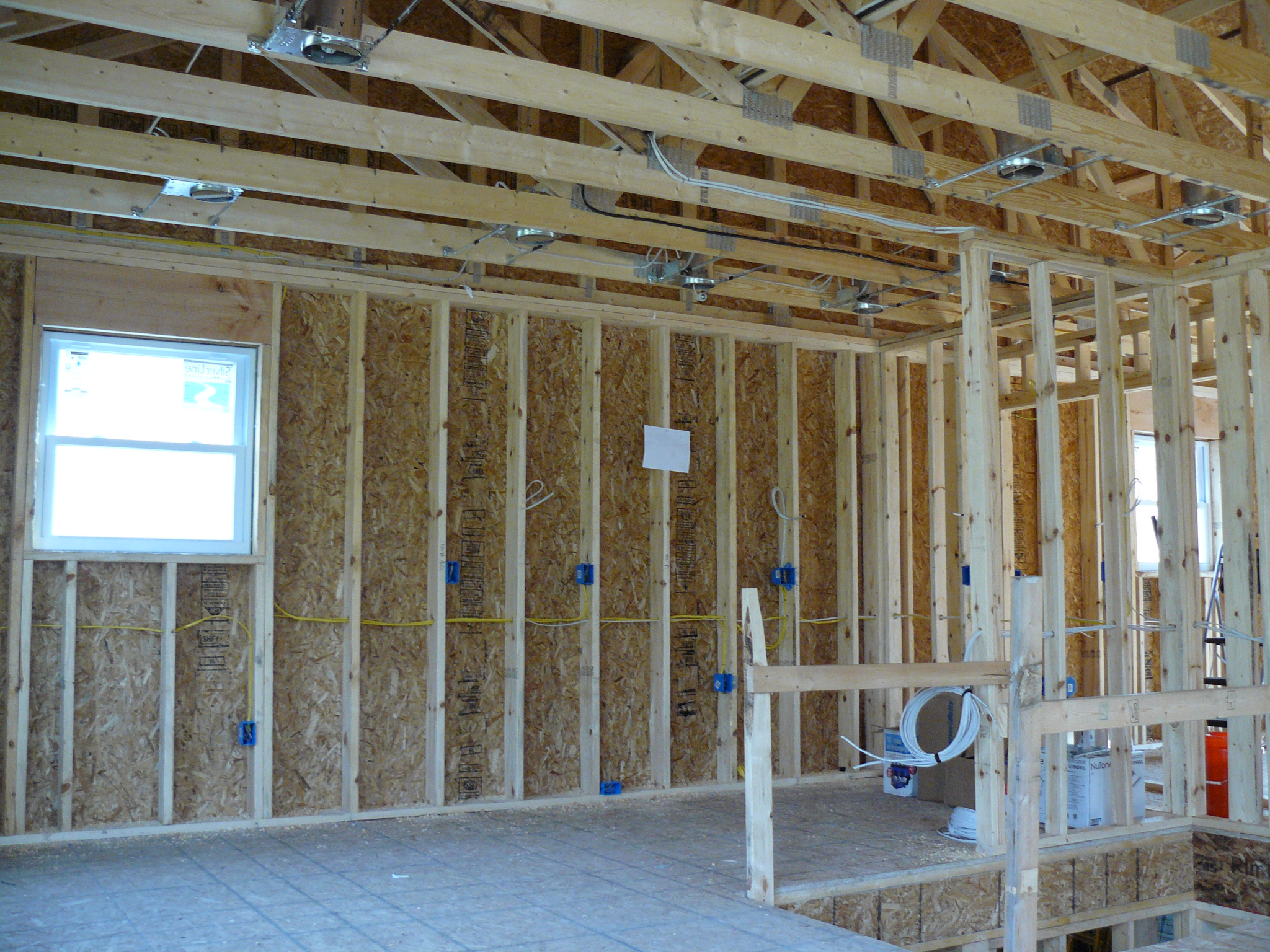

No EMT here in residential. And according to my electrician friend, EMT is a pain in the butt.
Still, they use EMT in my building, and it made running fibre optics a lot easier - they just pulled it through where the copper was.
Residential looks like this here:
I've heard it claimed that Chicago code requires EMT so the Union tradesmen are guaranteed work. I've installed EMT in a few houses including my own, and it is definitely a skill. You have to know all these rules, use benders and reamers, it's not DIY friendly. I have all the tools to do electrical jobs; benders, cutters and reamers, wire strippers, several Fish tapes, hole cutters, hammer drill, and more.
It's a good thing I think, because it's too intimidating for amateurs to tackle. It's a terrible thing when unskilled people mess with wiring.
I can tell when Uncle Joe messed with the wiring, because it'll be wrong. There are so many things that unskilled electricians do wrong!
By the way, the wiring you show requires skilled technicians to install it properly too. You're not supposed to just fish the wire through the walls, although that's what Uncle Joe does. You're supposed to install nailing plates so a nail can't pierce the wires. You're supposed to install the wire in a predictable way so the drywall guys know where the wire is. And finally, it has to be wired correctly!
Never heard of nailing plates being required here, either.

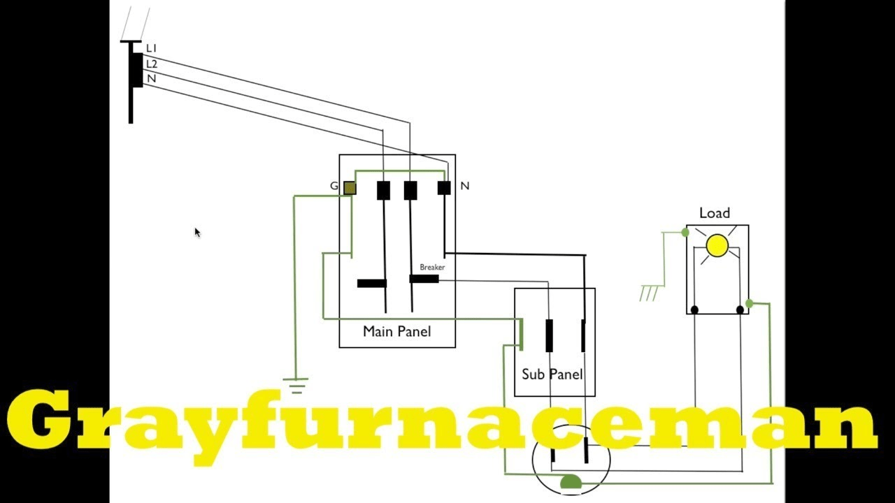

"And, in the USA the ground and neutral are tied at the panel. "
This is an absolute NO NO in France.
No neutral and ground connection in the house or appartement.
There is such connection in the electric grid usually at the last distribution transformer but you are not even supposed to know about it.
At the house it might have few volts between neutral and ground, this is not a fault.
Here neutral is a centre tap on the transformer that feeds the house and it's (only) bonded at the service (first panel) like in this diagram.
Here transformer ground and neutral are connected.
Three or single phase plus neutral is supplied to customers, who need separate earthing, pit or chemical compound...which is latest practice.
No split phases, 220V nominal phase to neutral.

I think US and Canada do the same about this ground and neutral connection. Connected at the house panel.
Correct me if I am wrong.
Europe does not follow this.
Using pipes as ground is another questionable safety issue. Definitely not recommended in Europe now days.

North American and European electrical service are different. Both are grounded differently, and both schemes work if implemented correctly. Other than that, grounding is basically the same all across North America (or it's supposed to be). The important issue is where the ground and neutral are connected together. In North America, that is the way it's supposed to be done. It is very important to be consistent about that.
Whether to connect the ground to a water pipe of a grounding rod is an important consideration. Some buildings have multiple service panels and a complicated grounding schematic. These have to be connected to an appropriately sized grounding rod, no exceptions. Residential can go either way, depending on what's available for grounding. It's no secret that plumbers have screwed up service grounds before. I've actually seen the ground wire blatantly disconnected after plumbing was done. But most older houses are grounded this way, including mine.
Also, the "neutral" wire in North America on the pole is grounded to actual ground at every few poles. Since a typical scheme will have only one "neutral" wire at the pole but multiple phases and also a high voltage feed for transformers, and they all use the same "neutral" on the pole, there can be significant voltage drop across the neutral wire and of course this can be a source of noise "in the line" that audio designs have to deal with.
