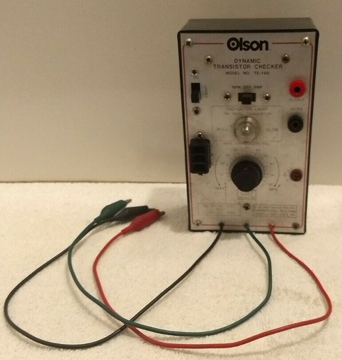

And I still have my old Olson transistor tester, still works, but sitting unused up on a shelf, dusty.

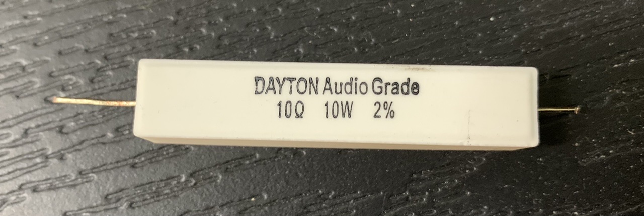

It wasn’t a cheap resistor at all, it was so called high-end “Audio Grade” quality. I bought it for another purpose, but it ended up in the position between chassis and audio ground.
To be honest, I’ve seen quite a few ceramic wirewound resistors blown over the years. Some turned browd or dark gray and were still OK, some drifted and some opened up.
The replacement resistor will be a better, ruggidized type.
Regards, Gerrit
I've had cement resistors open and look fine like yours, and I've had them crack into pieces but still test within spec. There seems to be no pattern, but "cheap" resistors from the hardware store will take an overload that makes them incandescent. It was 47R/5W and was dropping 150V.

Out of curiosity, crack it open and inspect the inside guts.
Something tells me it might have a 2 watt molded inside (china)
Because I've also seen caps of all types labeled "audio grade" and inside is a tiny crap cap.
