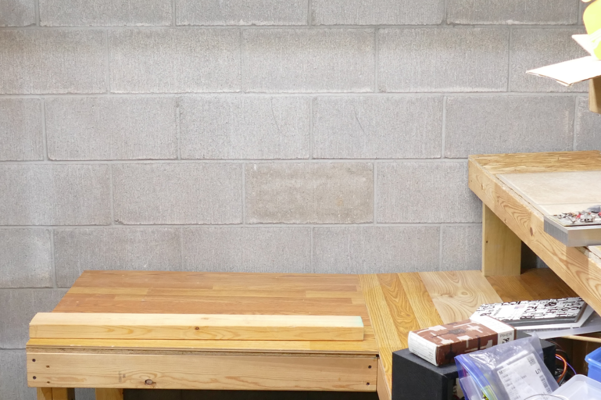

What did I repair today? My workspace, or part of it. More work tomorrow.
I climbed up on my work bench to reset the Comcast box (the white thing) and noticed a lot of wobble. I built my benches out of 100% recycled material about 7 years ago. The bench was bolted to the equipment rack (the tall grey thing) which was bolted to the other bench, part of which is seen on the lower right. All was stable until I pulled all of the equipment out of the rack to fix the sig gen on the bottom of the stack. With me on top of it I realized that everything could come crashing down real easily and the bench had about 500 pounds of stuff plus me on it.
I removed everything from the bench, dragged it out and added the two diagonal braces that should have been there all along.
During this work I noticed a bit of a problem with the other bench. It will be tomorrows project. Leaving a couple 90 pound HP8642B signal generators on the bench for about a year will do this.
No electronics work will occur until I put everything back where it belongs......assuming I can find it all.

My bench used the heaviest shelf bracket system Menards had for sale, with brackets ever 20". Seems to be pretty solid even with a couple hundred pounds of equipment on it. If it ever starts sagging then I'll rebuild it out of strut.

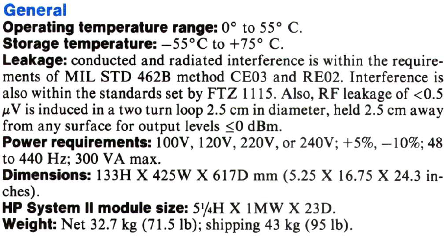

Is an 8642 really 90 pounds? The ones I have at work have all been in racks or on carts for their whole lives, so I've never actually lifted one.

According to HP, 95 lb. shipping weight, 71.5 lb. on the hoof. Close enough for Jazz.Is an 8642 really 90 pounds? The ones I have at work have all been in racks or on carts for their whole lives, so I've never actually lifted one.

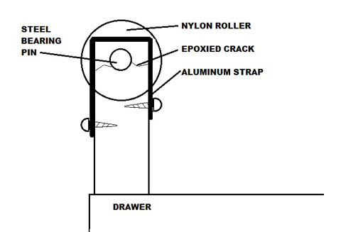

Let me clarify...
The nylon roller is fitted into a metal sleeve bearing, which is then fastened into the plastic drawer.
The break was in the plastic tab, which epoxy could weld back together.
And as I mentioned, I added an aluminum strap over the tab/break for re-inforcement, along with two screws.
It's tight and will hold forever now.
Trust me.
I did the same thing to another kitchen drawer 12 years ago, that too is holding up just fine.

90 pounds was my guestimate. As Mr_Zenith found in the manual the generator itself weighs 71.5 pounds, and packed in its shipping crate it's 95 pounds.
The old 8642's and 8644's have the lowest close in (20 KHz) phase noise of anything HP ever made up until I left Motorola in 2014. I had a stack of 1 X 8642, 2 X 8644 and 1 X 8643 on top of a metal file cabinet at work for IMD measurements at work. That poor cabinet must have been unhappy.

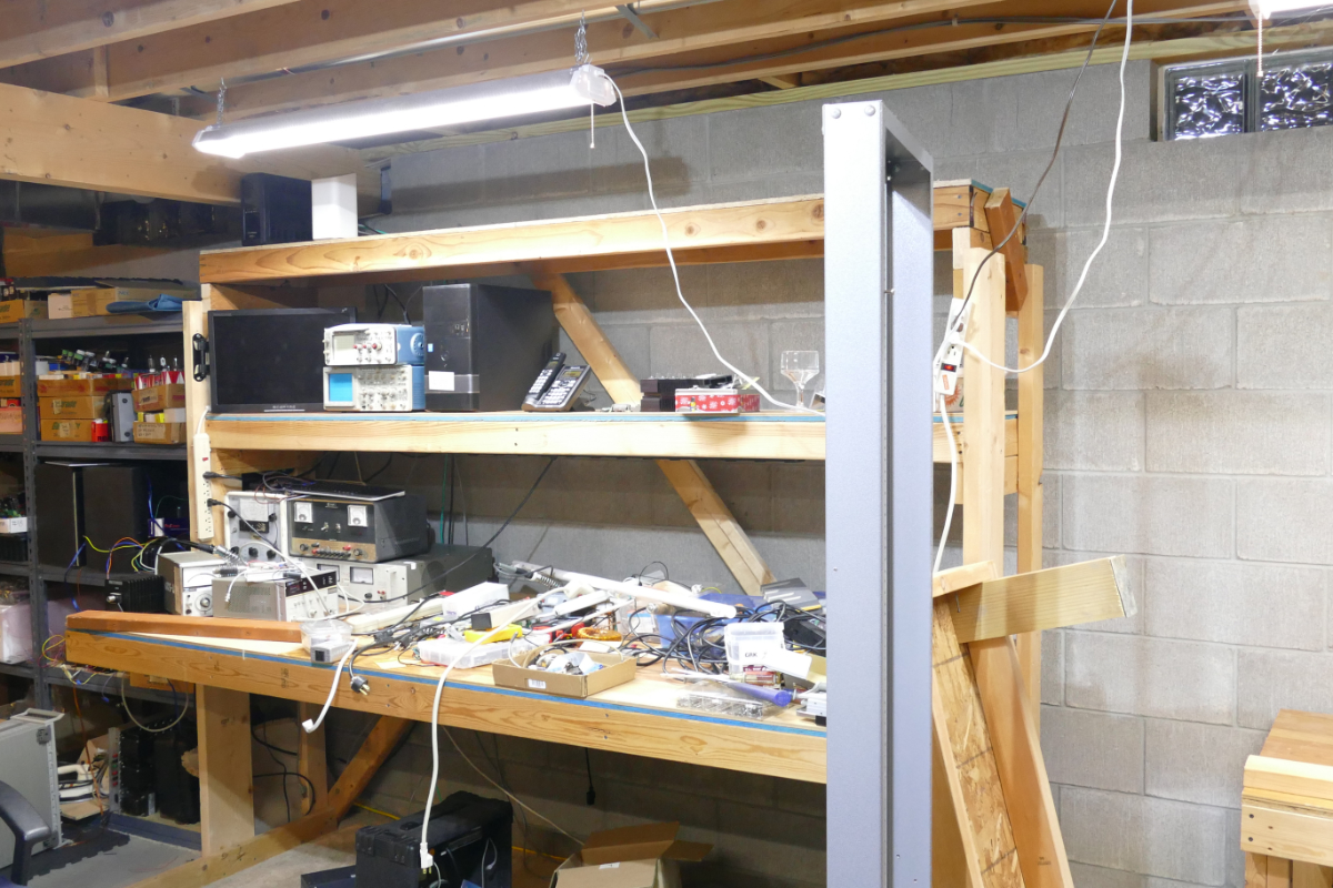

Here is the setup I had in my basement before the recent teardown. It's quite similar to what I had at Motorola. I got a bunch of dead test equipment cheap at hamfests, on Ebay, or at salvage and scrap sales and rebuilt it all. There are 5 working RF signal generators in that rack with an Agilent 4352B PLL analyzer and a computer on top. There is a HP8753C network analyzer and a spectrum analyzer on the bench.
The other end of that bench is where I work on tube amps. The HP6448B power supply alone weighs 60 pounds as it's an old style 1 KW 60 Hz switcher. It was on the second shelf with the network analyzer. The Fluke 407D and Knight KG-664 vacuum tube power supplies aren't light either. There was too much weight up high, and no diagonal bracing. With me up on the bench top it wobbled far too much for comfort.
There is another bench to the right of the rack. It had the pair of 8642B's, an RF power meter, and a HP E4406A transmitter tester. A third 8642B was up there for a while too as the three dead generators became one good one and one semi good one.
I am 7 years older and considerably smaller than when I built the bench. It was a struggle getting those two heavy items down off the second shelf, so I am working on a new layout to keep the heavy stuff where I can get to it with my feet on the floor.
Not to mention wiser. It's good you're taking care of this now while you still can. Not only are you rearranging the stack o' stuff for future access, you're keeping the rack from, er, racking (that's the actual term). While that seems obvious now, sometimes things like that seem to get lost in the interest of expediency - like your move from Florida (don't ask me how I know). Benches made from scrap "two-by" lumber can be immensely strong if proper attention is paid to the joints and bracing. Otherwise things can go south in a hurry once they begin to lean.

The epoxy joint basically held it in place until you did a mechanical joint, making the epoxy superfluous.
Exactly what I would have done, if my time spent on lathe was too much...
But drawer slides are $1 and on here...
Oh, trust me, that epoxy will hold tight, plus it insures that the roller will stay in proper alignment to ride in the metal guide/support track.
This is above the drawer, supporting the rear of the drawer, not the typical "underside" drawer slides that you must think.
That looks like a good repair to me. As long as the bearing pin hole isn't wallowed out (and the epoxy probably helps with that), the weak point is the joint between the hanger and the drawer proper. There are probably bumpers or other stops present to prevent any force from being transmitted there.

The bearing-pin is solid, a thick steel rivet-like affair into the vertical thing that cracked of 1/4"thick plastic, which is integral to the (molded) plastic drawer.
The bottom face of the roller rides in a steel U-channel just under the countertop.
The bottom of the drawer itself glides on two fixed nylon glides at the face of the cabinet opening.
It's one of those "soft self-closing" types of drawers.

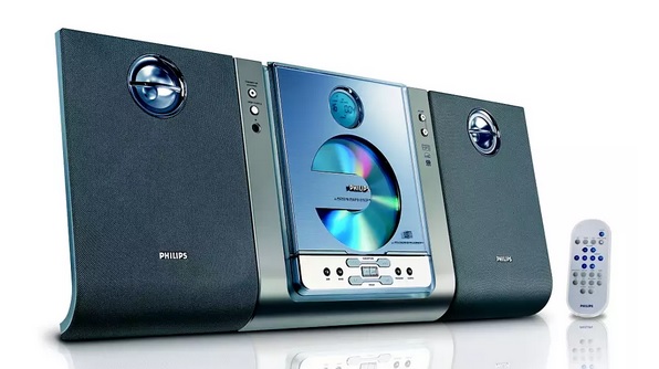

Today's repair was a Philips tabletop CD-Radio system for my neighbor.
The sliding CD door wasn't lifting, and he was using fingers to help it up.
Not a good thing.
The motor drive loading belt was slipping, and since this unit is 17 years old, it was time to blow out the dust and replace the small belt.
Took me an hour..... like new again.

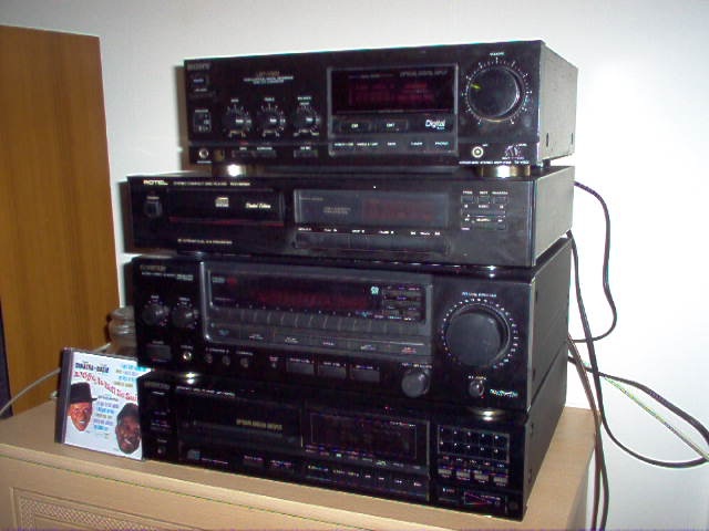

I was thinking of buying this 20-y-0 heavy Kenwood KR-V6060 Amp and DP-1100SG CD off my neighbour. The two at the bottom. £30 each we thought?
Amp was dreck, worst thing I have heard lately. CD had a bent and sticking drawer which I fixed, but nothing special.
Told him to give them to the nearby Charity shop. Amp now on sale there at £50. CD an outrageous £150. Beats me.
