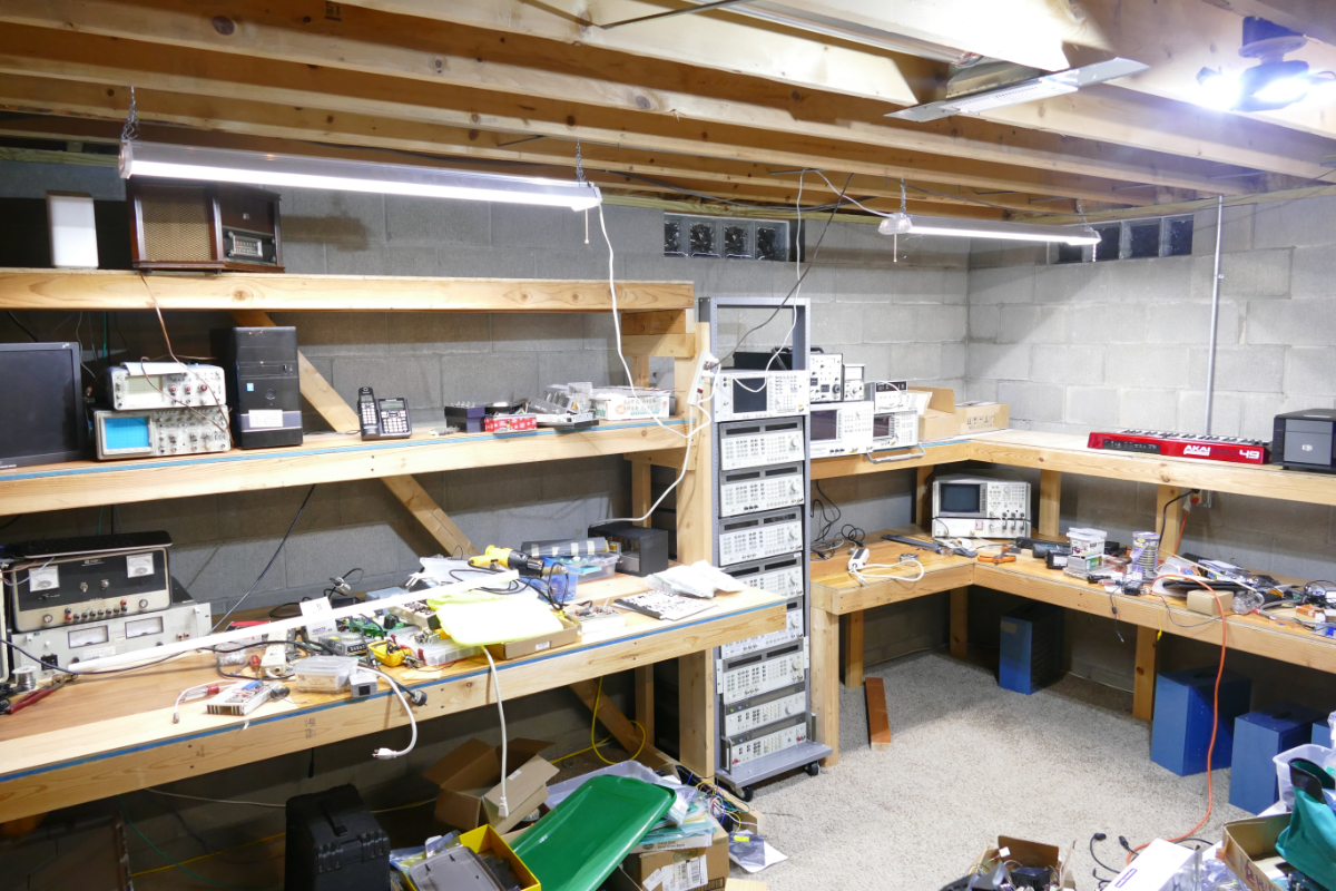

The quick "fix the workbench" moment has snowballed into a rebuild the whole basement lab kinda thing.
As of now the original bench is fixed, but I'm still moving stuff around to get things where I want them. It will be used mostly for tube stuff and other large or heavy things.
The old "leaning tower" equipment rack got some bracing....so I could stuff more equipment in it. It is now bolted to both benches as well.
The corner bench got it's shelf raised several inches and some extra bracing added for better load management. The short side, the rack, and the corner is for RF work. The long side and the Ikea table next to it (not visible) is the synthesizer lab where analog, digital, and mixed mode sound generation experiments get turned into synthesizers or modules.
The bench tops and shelves are both covered in random samples of hardwood flooring, hence the different colors. It has gotten scratched, but it takes a beating. Hey, it was all free.
There are also two large benches from a school lab. I got them for $20 each. One is currently unused but will probably host a 3D printer. The other is where stuff gets assembled and soldered.
There are also two more Ikea tables, all oddballs from their clearance section. The long skinny one hosts an old Roland JV1000 music workstation from the 1990's that's been waiting for me to rebuild it for several years. The roll around table is still unassembled. I'm not sure what I'll do with it.
If you're going to pull everything back, then I recommend you put a sealer on those porous blocks. I recommend this. Drylok White Latex Waterproof Sealer 1 gal - Ace Hardware It's a basic white finish, rather industrial in appearance. I have painted over some of it with conventional latex interior paint with no problems and it looked really nice.
I had a "leaning tower" of my own and it collapsed. One brace had snapped and the whole thing came down. It was cheap plastic and ridiculously overloaded.

If you're going to pull everything back, then I recommend you put a sealer on those porous blocks........I had a "leaning tower" of my own and it collapsed. One brace had snapped and the whole thing came down. It was cheap plastic and ridiculously overloaded.
The benches are already back in position.
When we had the house built I discussed this with the builder who explained that they seal the block from the outside with two different coatings. The first is similar to Dry-Lock and the second is a thick black tar like substance. They recommended NOT to seal the inside.
Apparently sealing the block from the inside only can be real bad in wet locations like here. If water gets trapped inside a block and then freezes the block can shatter possibly causing a catastrophic event. It seems that it happened a few times over the years.
