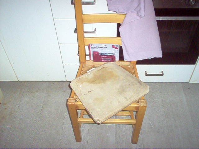

Have been busy fixing a discarded chair I found up the street rotting in the rain. I bought a staple gun last week for £2. It's paying off already. That chair is above average on timber bracing and quality, IMO. Only issue is the seat is looking a bit stained and tired. Doubtless some disinterested workman used it for painting,
If Her Majesty the Queen was visiting my humble abode for Dinner, She might have "Concerns" about sitting on it. Nothing I can't fix with a Staple Gun and an Old Violet Pillowcase stapled to the wooden seat base! 😀
You can see my plan here. How hard can it be?

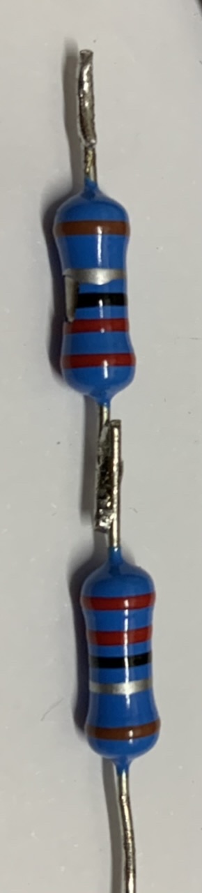

Resistors replaced
Just repaired my own tube amplifier. Two resistors of 2.2 Ohm in series both went into the megaohm range. The resistors were purchased less than a year ago and nothing strange is visible on the outside, except a damaged lacquer on the top resistor.
Only one tube of this channel was working correctly, but showing a high G2 current (KT150 tube, G2 glowing). These resistors were part of the cathode circuit.
With new resistors everything is OK again and both tubes work together as they should.
Regards, Gerrit
The resistors are too small IMHO. They couldn't handle peak cathode current and opened. I would use 5W parts there. Also, you could consider making the screen stopper larger to prevent that much current from flowing in the screen circuit? Or make the screen resistor a smaller power rating to it will open like a fuse in the case of screen current.
I'm glad your KT150 still works. I had some 6550 that never worked the same after their screens lit up.
Question is, where did the screen current go? If the cathode was in the megohm range and the screen was glowing?

Hi Koda,
Only one tube was trying to do all the work (completely out of balance), that caused the screen to lit up. With max. 100 mA through a 2.2 Ohm resistor it’s only dissipating 0.022 Watt. The resistors should eat at least 1 Watt, probably 2 Watt without problems. G2 is fed from UL-tap with 1K2 10 Watt with 600 VDC B+.
Regards, Gerrit

Hi Koda,
Regards, Gerrit
Fair. I'm used to my sweep tubes that idle at 100mA but peak over 1A... I've blew up a few cathode resistors...

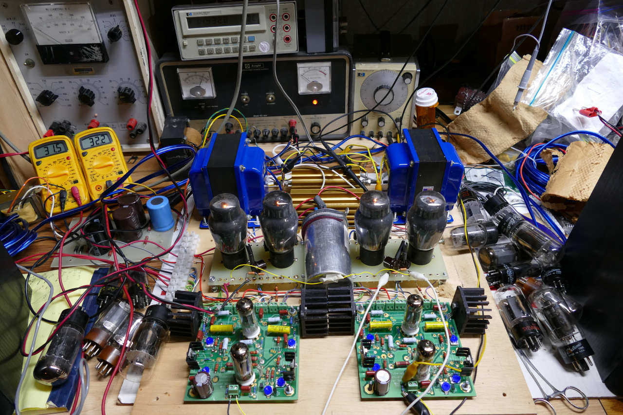

There are 1 ohm 2 watt Dales. I blew them with 6L6GA's running a little bit over spec. The tubes were not harmed and played just fine after replacing the resistors. Some over spec operation resulted in a tube arc. The blown resistors saved the tubes from a continuous arc which would have destroyed the cathode.
I have seen a similar arc resulting from a red plate runaway condition due to a gassy tube. Most new production tubes have a less that perfect vacuum which degrades faster than a well built older tube. This leads to increased grid current which upsets the bias leading to eventual runaway. Too much resistance in the control grid circuit exacerbates this problem. Pay attention to that spec.

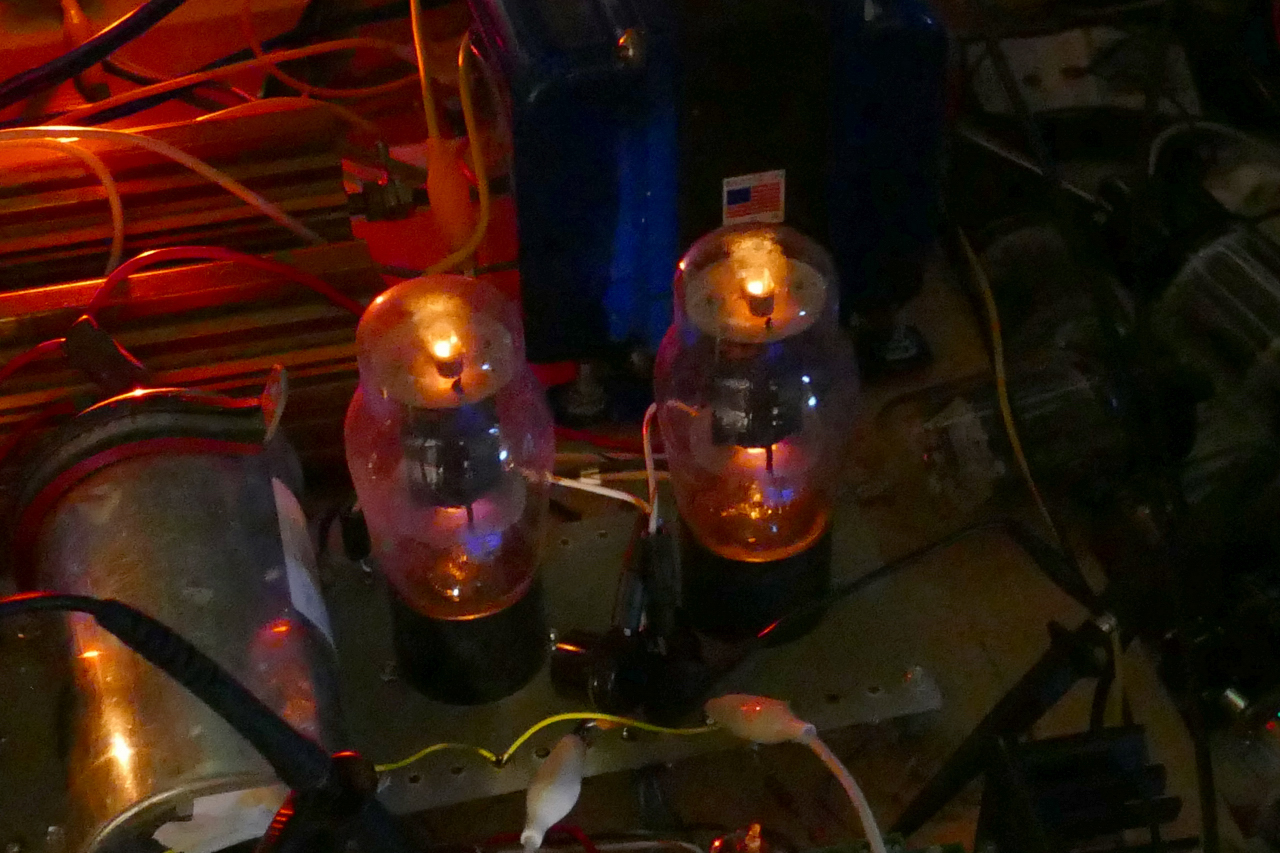

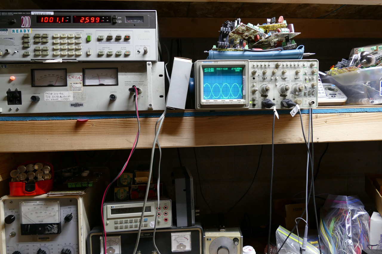

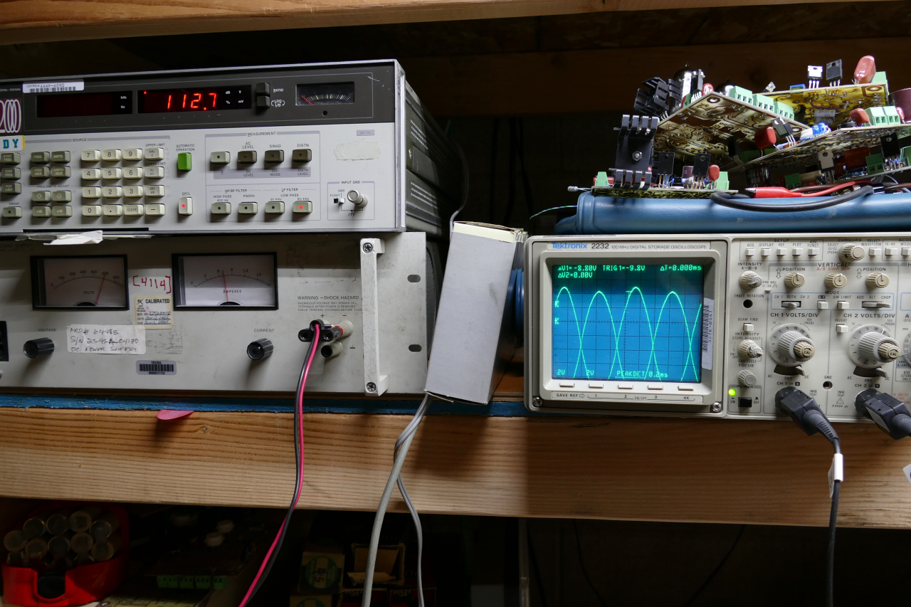

For those who may be interested the upper limit of a single pair of 75 year old 6L6GA's in AB2 is 112 watts. There is nothing glowing at this power level. This is a long time exposure, most of the light in the picture is from the pilot light on the power supply.
I replaced the resistor and tried it again. This time the other channel blew at about the same power level. I replaced the resistor again and listened to the amp for a few days before moving on to different tubes from my "junk" collection.
The last picture shows the setup with older 6L6G tubes. I tested them as well, but stopped when I saw 110 watts @ 2.6% THD since these are nice tubes and I didn't want to risk them.

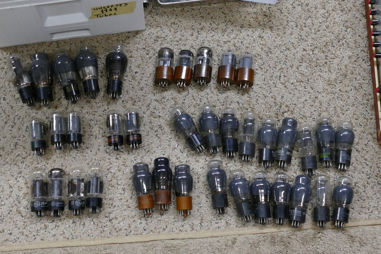

These are all used tubes collected from various sources over 30+ years. The test conditions were as stated a bit over spec. B+ supply was 540 volts with cathode bias. There was about 525 volts on the plates of the tubes. The current meter on the power supply shows about 675 mA for all 4 tubes at 110 WPC. The OPT was 3300 ohms. Mosfet drive to the grids allows some serious AB2 with the control grids seeing +45 volts at the edge of clipping. Screen grid voltage was 300 volts.
Running some tubes in AB2 can get near sweep tube power levels, but for slapping the speakers around with authority, nothing beats the peak current capability of sweep tubes, and AB2 is not needed....or wanted.

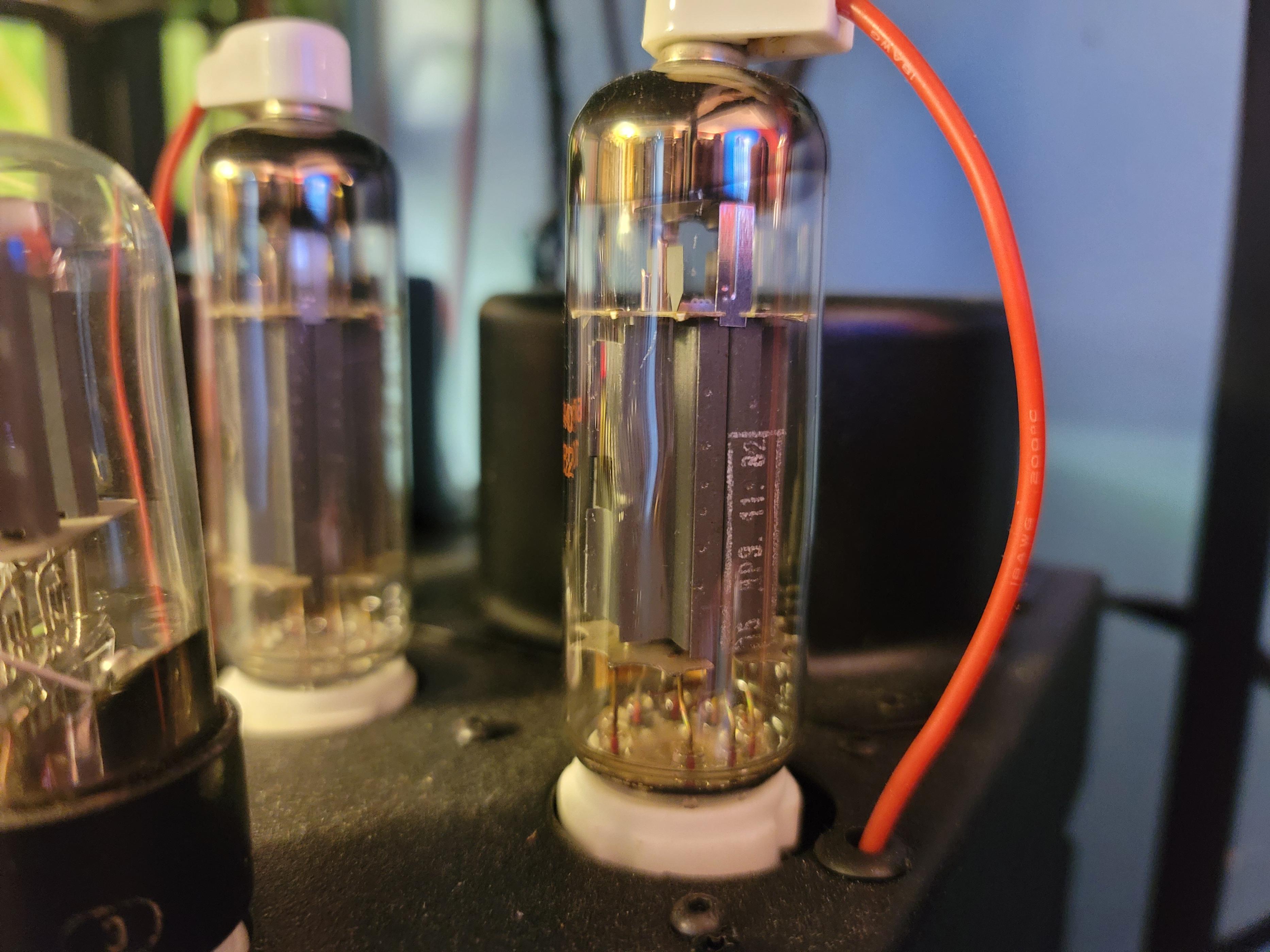

So I've been running these 6P44S tubes at 320V/80mA (~26W Pd) for 3 weeks and I've just noticed the glass is deforming...
Should I just leave them and see what happens or replace them with 6P36S? 😀
