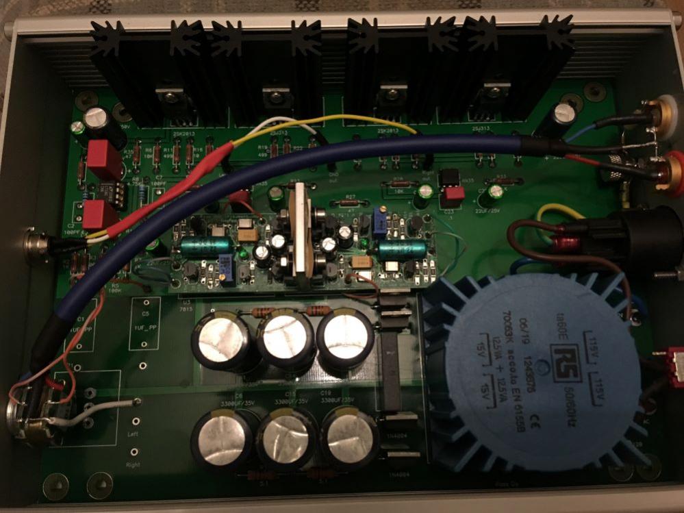

I finally found time to swap out the OPA2604 in my WHAMMY with the Burson V6 Vivid. I've probably got about 10 hrs of listening in by now. I went the route of swapping out the 220uF/50V caps with the Rubycon 150uF/25V caps. Being conservative with $70 chips, R35/R36 47ohm resistors were pushed up to 100ohms. I thought the OPA2604 produced an extremely satisfying WHAMMY. I like WHAMMY with the Burson V6 Vivid even more. The difference is not earthshaking to my aging ears. The Vivid is, however, crisper, faster and more impactful, but most importantly, more lifelike. Vocals seem closer to being in the room, a plucked string has that same presence. I would have been very happy with my stock Whammy, but I'm glad I made the swap for the V6.
I think we're in the area of personal preference here. Vivid may be too Vivid for your ears. I should point out that the differences I note above may not be fully attributable to the V6 either. I am listening to a very different system than I primarily used with the OPA 2604 in place. I switched from Audeze LCD-Xs and, more recently, the new LCD-1s, to a 20 year-old pair of DIY desktop speakers based on a Madisound kit which employs Vifa drivers. It's also the first time the ACA has come into the system due to the need to drive speakers. The Whammy and ACA seem to produce quick responses and perfect control of the speakers. Maybe that's the V6 Vivid's impact. The biggest change I can hear is how well an old pair of nothing special speakers can portray an almost "you are there sound."
The whole chain was Tidal running to a RP4/Digi + Pro --> Schiit Modi MB --> Whammy (V6 Vivid)--> ACA --> Vifa DIY speakers. This has become my new workbench system and I'm quite happy with it. Not rolling anymore op amps...

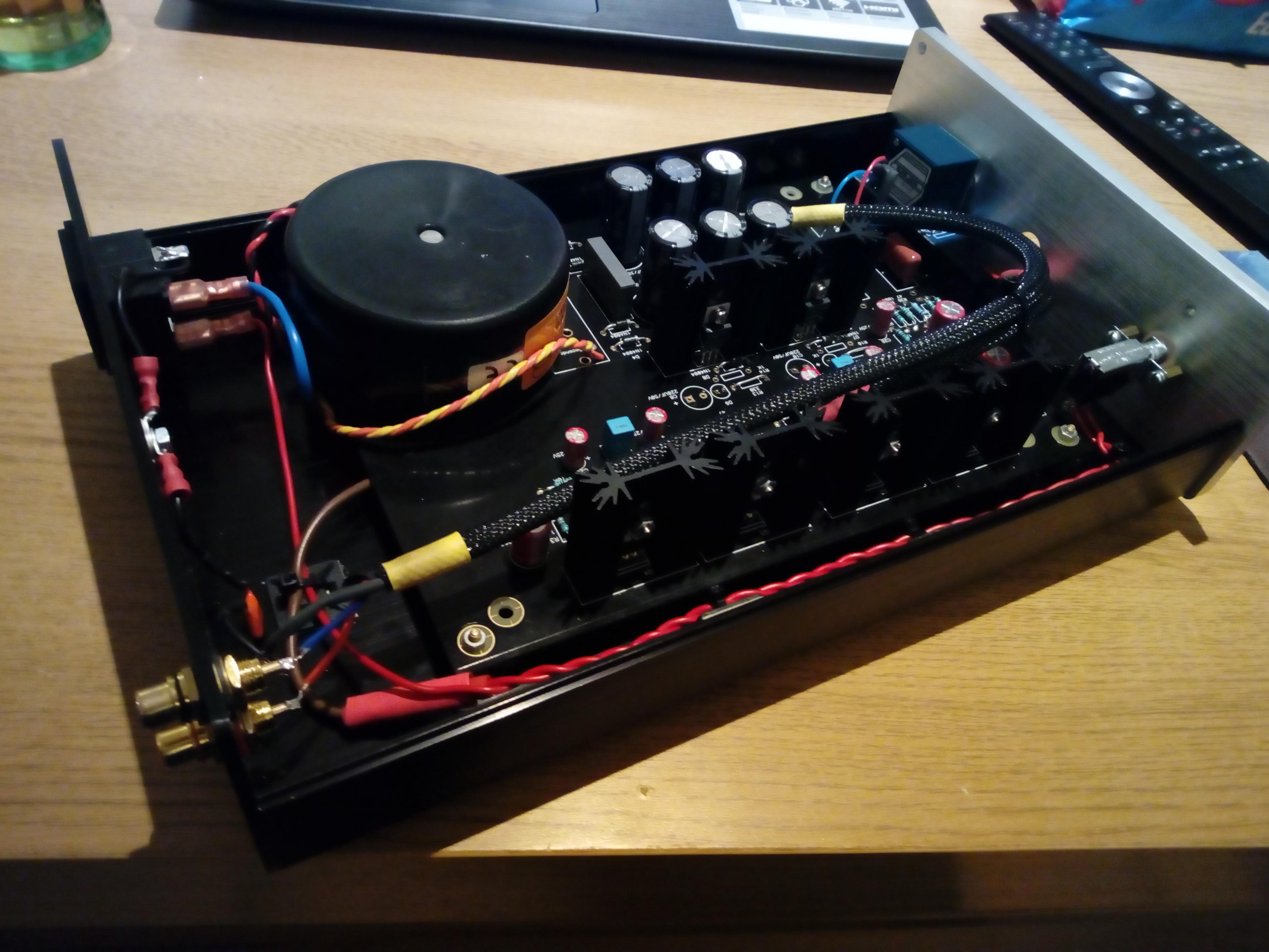

Here's my contribution to this awesome thread. Been listening for about half a day. High-res Tidal.
WOW. What an amp! Totally addicted. Stock opamp sounds great to me. Can't wait to mess around with them at some point. Made some mods from the kit mostly about space and power switch on the front for convenient desk use. Shorty caps near the opamp for access.
Gonna A/B this with Wayne's 2018 Pre—See which Wayne I prefer for phones!
Mine is dead quiet—really happy about that. I did use shielded cable per the build guide. Loudest part is the pot wires which I decoupled from the board—probably to be avoided if possible. I could tune the amp dead silent with careful routing. And I did have to ground the pot body to star. Pretty good hum without it. Had to do that with Wayne's Pre too. Wood fronts?

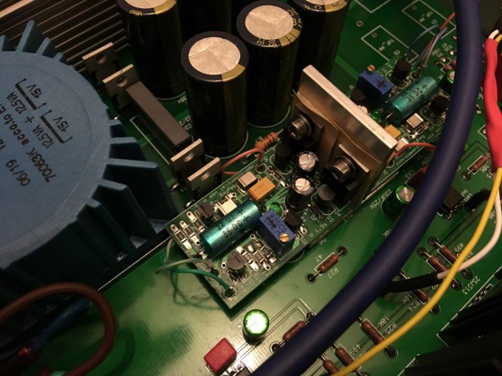

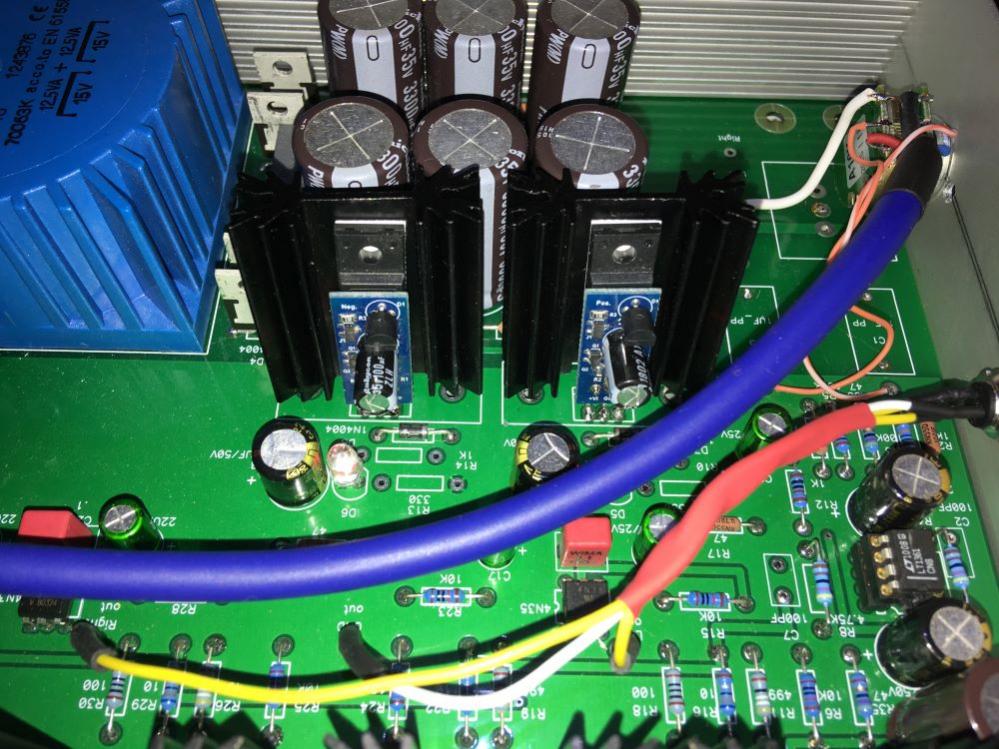

Should be of interest to Greg here, but I stuck in a pair of XEN regulators from the SLHPA kit and they work a damned treat. In this case I haven't removed the LED or 220uF cap yet, no issues, both rails are at around 15.8V. Running moderately warm.

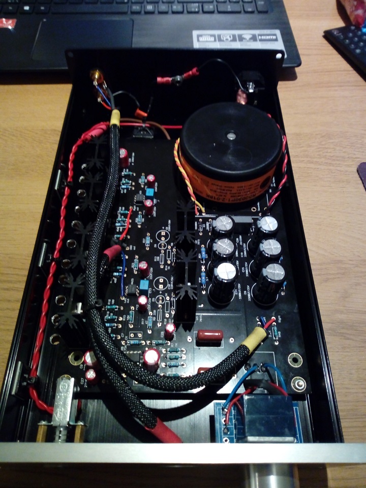

Mark is correct—Galaxy 230x230—his link is to a 1U. I TRIED to make the Whammy in a 1U, but the transformer from the store kit is too tall, and there were several other issues. I built it in a 2U, which in the end is actually fine—even though I really like to make everything as compact as possible.
2U Link
The amp has some presence in the 2U. I like it. And yes the front is custom, spalted beech veneer I cooked up. Not a huge fan of all aluminum everything all the time... Did have to ground the pot as I mentioned earlier though.

Removed all regulator stage components and managed to squeeze in a pair of SuperTeddyRegs that were begging for something to do, very good regs in the right application and they are working well here it seems.
The good thing is that the output can be dialled in perfectly on both rails, each running at a steady 15.5V. They do get warm but the T section aluminium they are mounted to is quite small and needs a bit more sinking to dissipate. Not sure how to do that right now. The whole assembly is simply fixed temporarily with blu tack to the board.
Now, I wouldn't say these are night and day better than the XEN regs but the music is very good indeed. Unfortunately I really need the XEN regs to go back into the SLHPA when I rebuild it (getting very sidetracked with this excellent Whammy sound.) So will maybe try and copy the XEN regs on perf board using TH parts.
