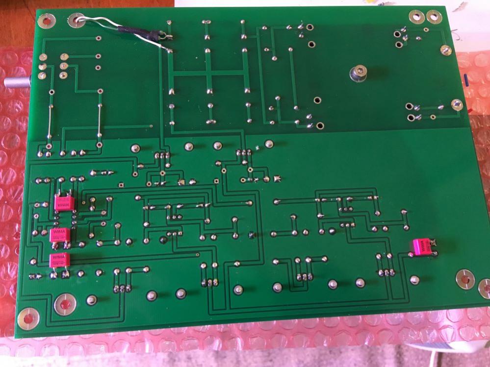

Hey Greg, yes mate this is the second time building the Whammy and on this board I spent a good few hours with a plain 20K pot before trying the Xfeed with a 10K Alps.
Now the Xfeed is very subtle, don't worry it doesn't add or subtract from the music but seems to place the music in the front and centre but somehow keeping depth. I guess it sounds more accurate and integrated inside your head and it seems to reduce fatigue somewhat, I can listen for hours or as long as I can stand the phones on my head.
So I would say the XFeed works very well, the Danyuk passive version here (you'll be getting soon!) is the most simple version is seems, follow Patricks component values and it will work in most situations but you can tailor the crossfeed point to suit. Interestingly the Xen motherboard has very different Xfeed component values for some reason.
Zen Mod - fixed the pot squelch and noise, I hadn't screwed the front plate properly! The pot was not connected to the chassis earth! Once this was done, no problems.
So running with 1K for R39/40 inputs, 10K for R4/R8 and no compensation caps yet, might try some 47pF.
While I was under the hood, I added some extra 0.1uf MKP decoupling caps to C1/C3 and C9/C28. Everything sounds very good.
My favorite op-amps it seems are two LT1028. Slightly better maybe than OPA627BM.
