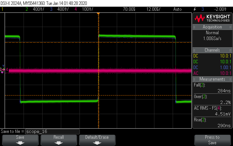

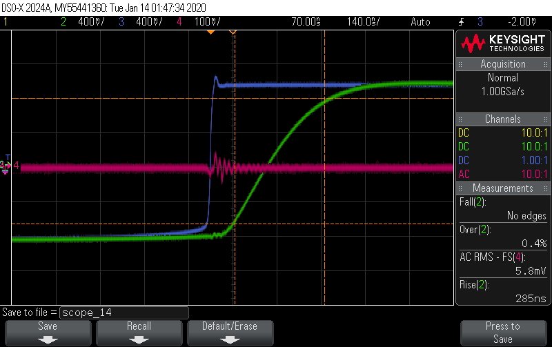

I had access to a scope at work and measured a 10kHz square wave on my Whammy out of curiosity:
Generator signal - Blue (it has a spike which seems to pollute things a bit)
Headphone amp output - Green
Op Amp Vcc+ pin - Purple (AC coupled to see noise)
I am happy to see no ringing even with the quite fast op amp OPA2107 and without compensation cap. Apart from that, does this measurement look fine to you?
The amp sounds amazing thanks again for the design.

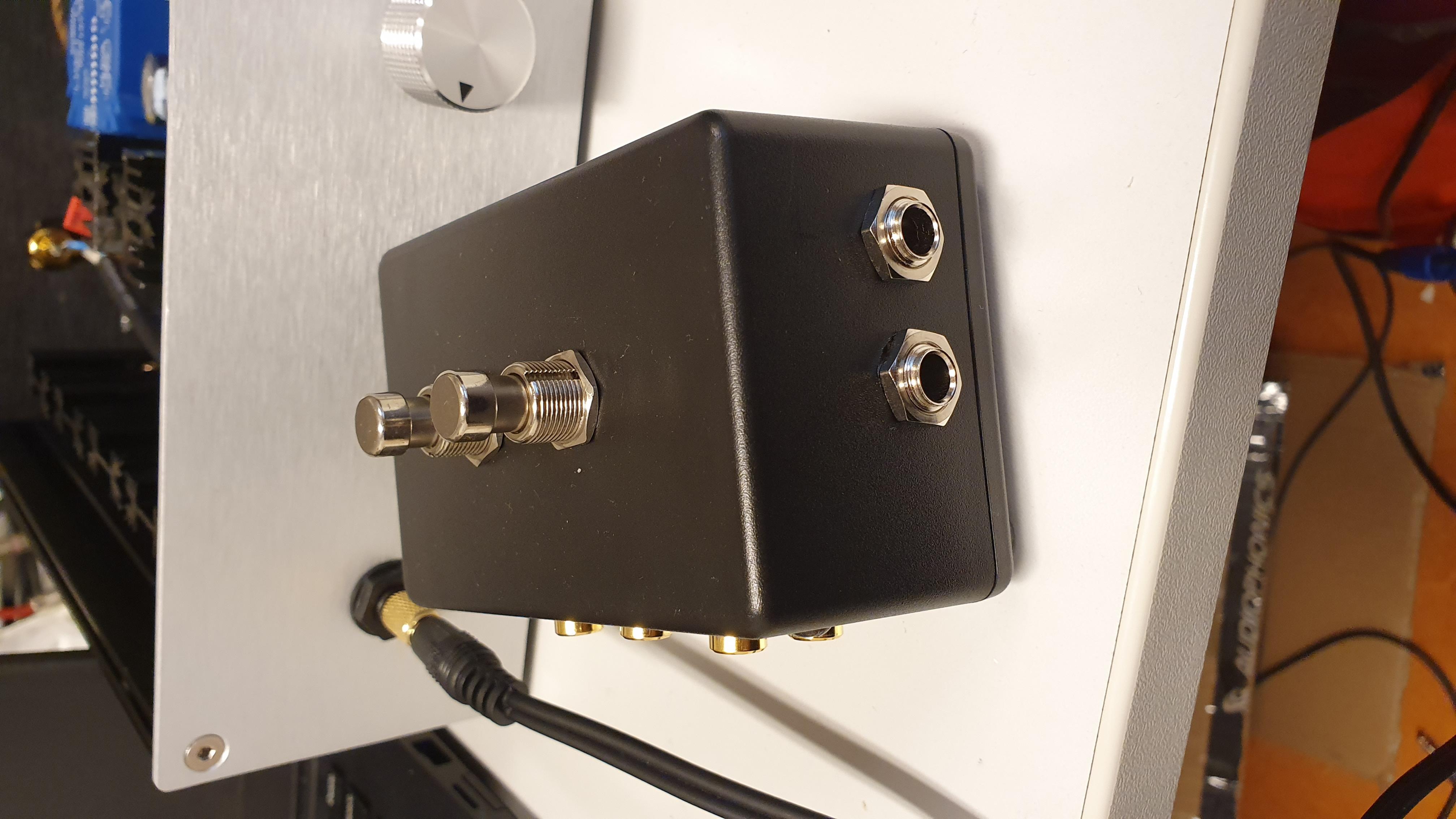

Actually, I am starting a series of Objective Vs Subjective measurements and will develop in a separate thread. I and built an ABX box to be able to blindly switch sources/outputs via guitar pedal push buttons:
This way I'll keep a fixed Atom reference and play around with Whammy components until I cannot improve it anymore.
The Whammy is blindly audibly better than a JDS Atom headphone amp, which is reassuring :), but the ABX box is lossy, the amp sounds better without the box in between.
