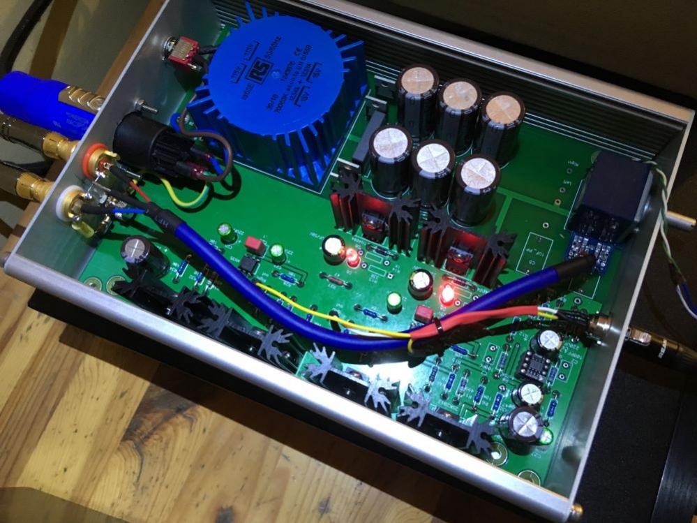

I'm getting some funky numbers coming out of my opamp. The measured voltages are as follows..
(1) .43 V (8) 16.63 V
(2) 14.8 mV (7) -7.08 V
(3) 13.8 mV (6) 15.2 mV
(4) -16.61 V (5) 13.9 mV
What could be causing this 2OUT (pin7) voltage? I've switched out the socket and tried different opamps that I know are working on a second Whammy that I put together.

I am going to assume the negative feedback isn't making it back to the op amp or pin 7 is open circuit. Pin 7 is the output of the second op amp, with pin 6 being the negative feedback. If both channels aren't working... I don't really know what the issue would be. Could be a lot of things.
Wow...
So.. uh... turns out I mixed the GND with one of the other channels (TIP/RING) on the jack.
So it would appear that I was actually picking up signal in that channel from the ground - along with the capacitor in line with the GND IEC and maybe that was acting as a filter essentially? I don't have a chassis yet as I'm awaiting the diyAudio chassis.
Not sure exactly why I was hearing a filtered output in that channel when it was wired to GND tho...?
Either way, I feel pretty dumb right now... that's what I get for working on it late one night after some drinks.

Since yesterday, I have an issue on my Whammy that was otherwise sounding great and rock solid:
After testing different Op Amps, left channel seems to be about 12dB lower than right channel. Only connecting the left RCA and increasing the volume seems to give proper performance.
This happens with different Op Amps, and I see the corresponding DC of each Op Amps on the output.
I tried on a different headphone amp, and got proper channel balance.
I noticed that some 0.7v remains for a very long time (2mins+) across the Vcc+/Vcc- of the Op Amp after shutting it down. I only noticed this now, meaning that I swapped Op Amps with this voltage. Maybe some surrounding components got damaged in the process?
Any idea on where to start troubleshooting?

........look for a broken soldering point (pressure at the socket can damage the points)
It works again! I had to heat up the track real close to get it to stick. I do not know why but those nichicons UES are the only ones that gave me thus kind of issue.

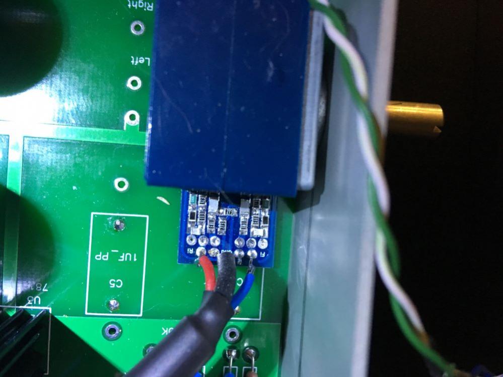

I am using EUVL's Danyuk Xfeed module on the 10K pot, the pins of the pot stick out from under the Xfeed PCB to locate in the Whammy pin holes. So no fancy wiring, the signal goes into the Xfeed and out through the existing tracks to the circuit.
Have you compared Whammy without/with the xfeed? People seem to like these xfeeds.
