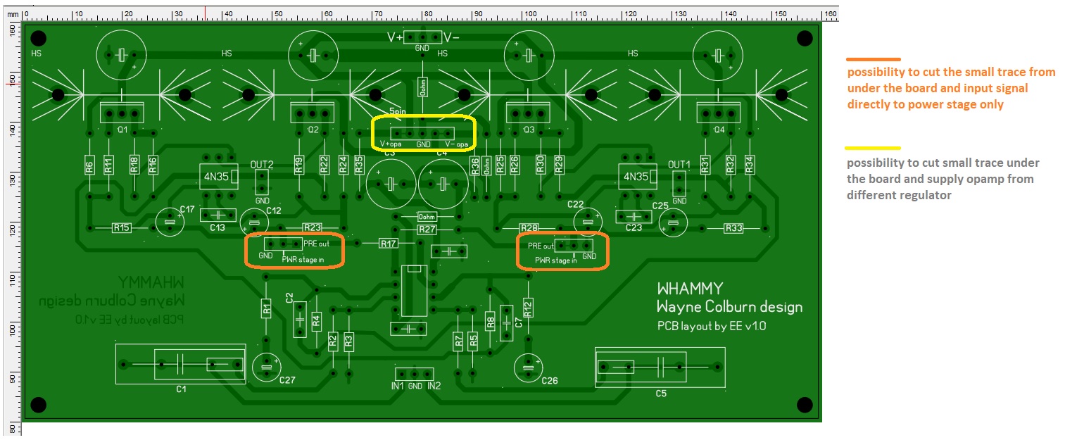

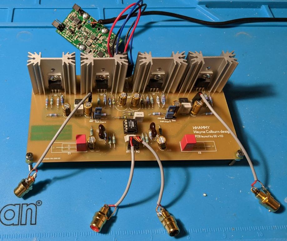

I've designed this alternate version of WHAMMY PCB that does not have the power supply / regulator section on the board.
Board size is 160*80mm single sided PCB.
If there is interest and Wayne is ok with it I can upload the Gerbers too. Or if anyone has some ideas for small tweaks then those could be considered too.
I have soldered up one unit and it's been working fine for last 2 weeks or so and instead of Headamp it's been doing a job of a pre-buffer stage for Purifi class-D amp modules.
There is always "for and against" external PSU. I have yet to measure how "clean" the original Whammy is. With integrated PSU it is nice with short power line paths if just transformer and rectifier diodes does not introduce too much hum/noise. Did you build the original and found it too "noisy"?
Now when you have decided to make your own PCB with external PSU then why not make a dual mono version where single opamps are used? ….with possibility to also make dual mono PSUs?
As for above proto - yes the power regulator is the Linear Audio Silent Switcher from Jan. I've used several of those from powering mic preamps and DAC to preamps and find them very good indeed. We've just made a deal with passive420 for a pair of SuperTeddyRegs, so then I will be able to compare to those too.
In our case me and my friend both bought a evaluation kit of Purifi power amp and that allows either using the opamp buffer stage with gain or bypass it and feed the power modules directly. Experimenting with that soon revealed that other than stock buffers can be better but such buffer needs a very beefy current capability as the power amp input seems to shine when the prior stage has lots of drive capability. We first tried with the Burson Soloist head-amp (that I also tweaked by replacing the power supply with SilentSwitcher). It was better but WHAMMY proto outdoes it.
Also we are just starting to experiment with different opamps - for now the OPA2134 I used gave a very nice balance as is, but some other candidates mentioned here are on the way as well as Burson ones.
Tomorrow will hopefully give some time to actually try this one out with headphones to see what it can do with my old but still good AKG 701-s

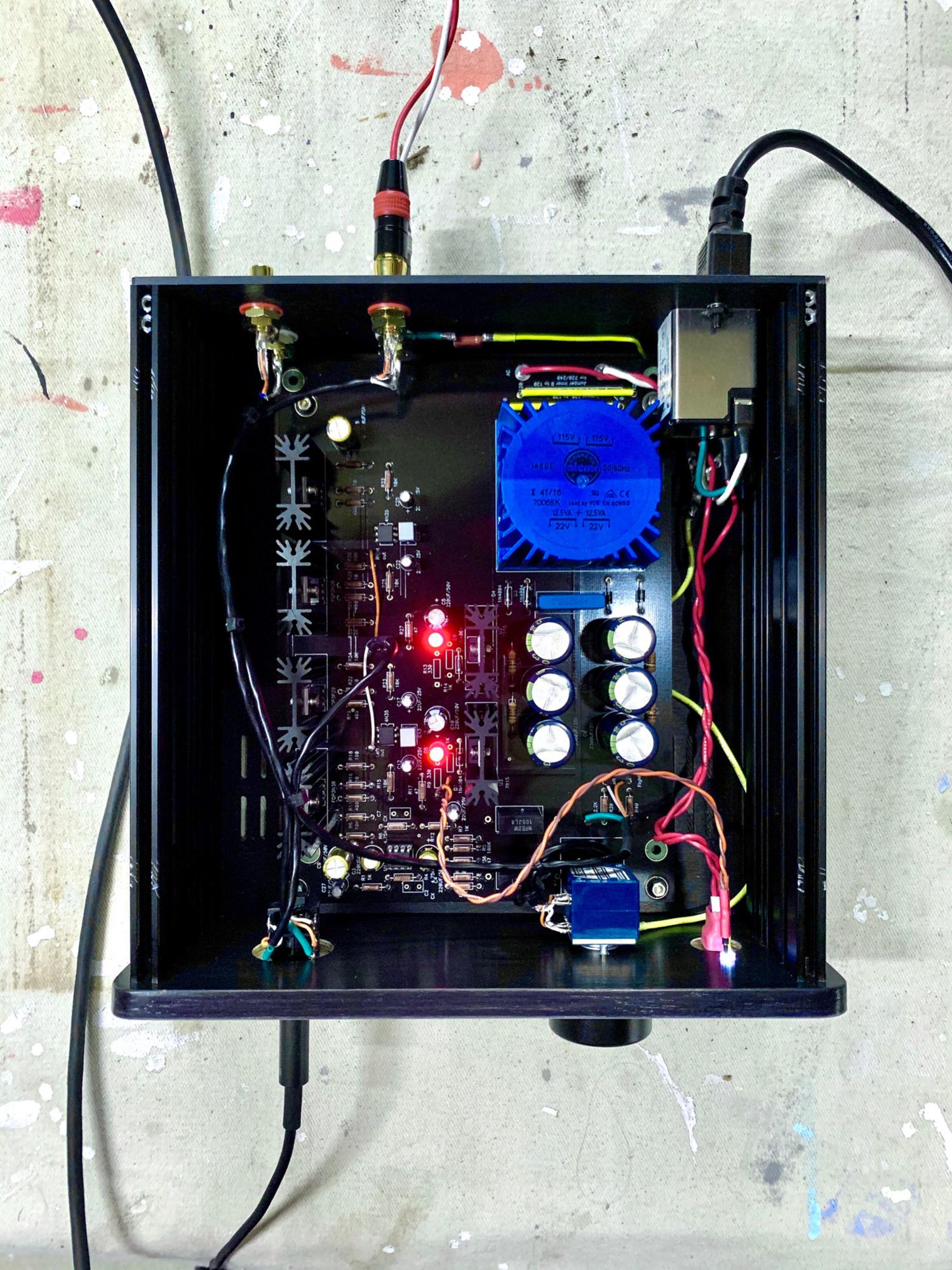

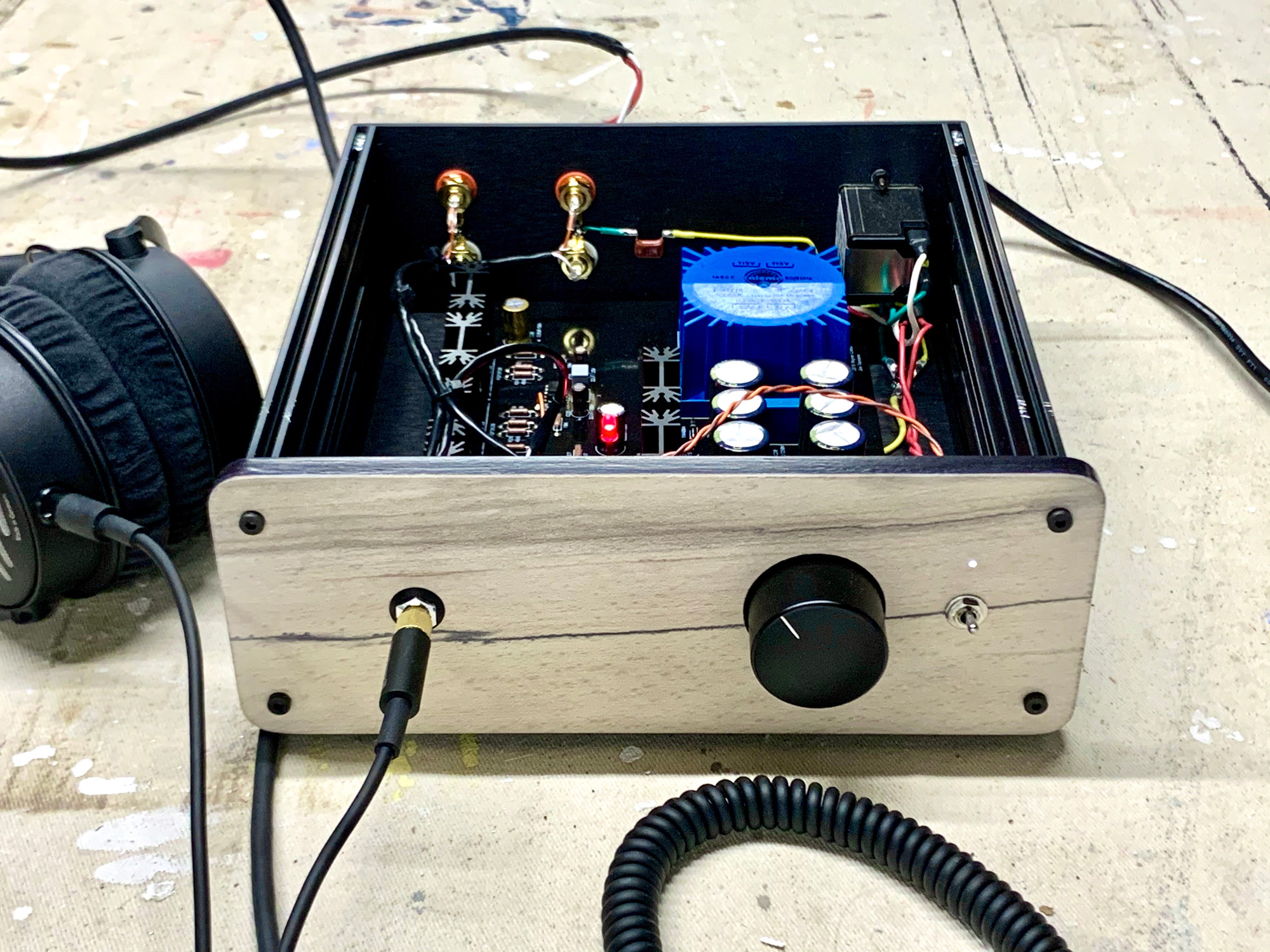

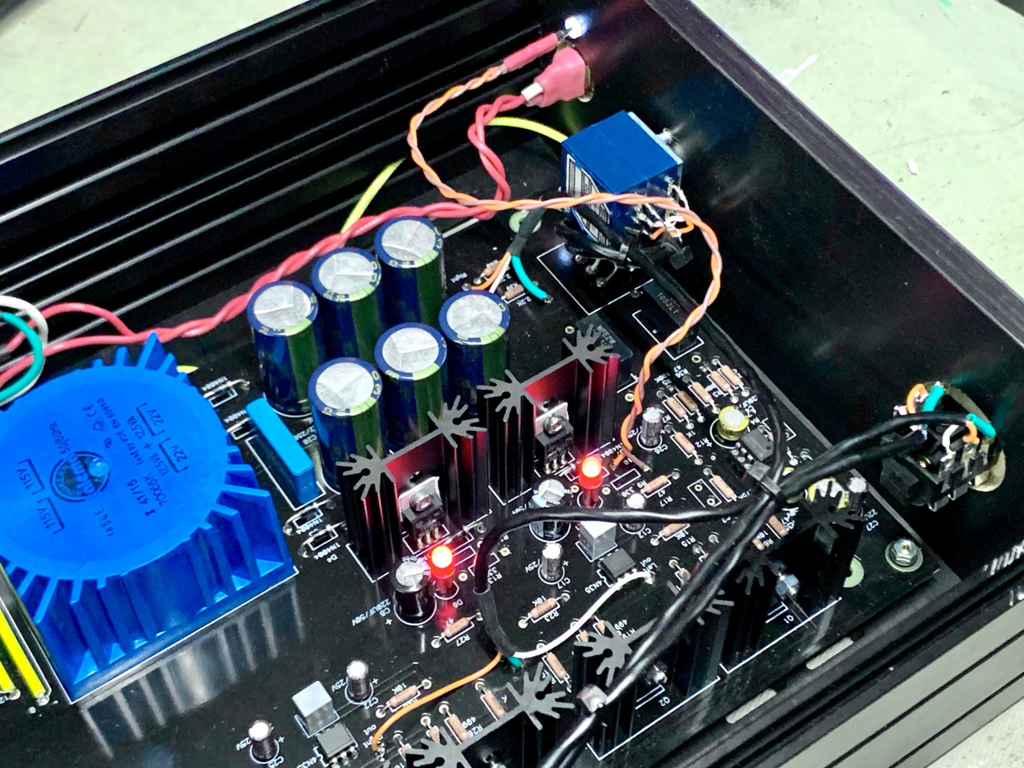

Here's my contribution to this awesome thread. Been listening for about half a day. High-res Tidal.
WOW. What an amp! Totally addicted. Stock opamp sounds great to me. Can't wait to mess around with them at some point. Made some mods from the kit mostly about space and power switch on the front for convenient desk use. Shorty caps near the opamp for access.
Gonna A/B this with Wayne's 2018 Pre—See which Wayne I prefer for phones!
Mine is dead quiet—really happy about that. I did use shielded cable per the build guide. Loudest part is the pot wires which I decoupled from the board—probably to be avoided if possible. I could tune the amp dead silent with careful routing. And I did have to ground the pot body to star. Pretty good hum without it. Had to do that with Wayne's Pre too. Wood fronts?
Thanks Wayne for this awesomeness! There are some REALLY nice builds up here.
