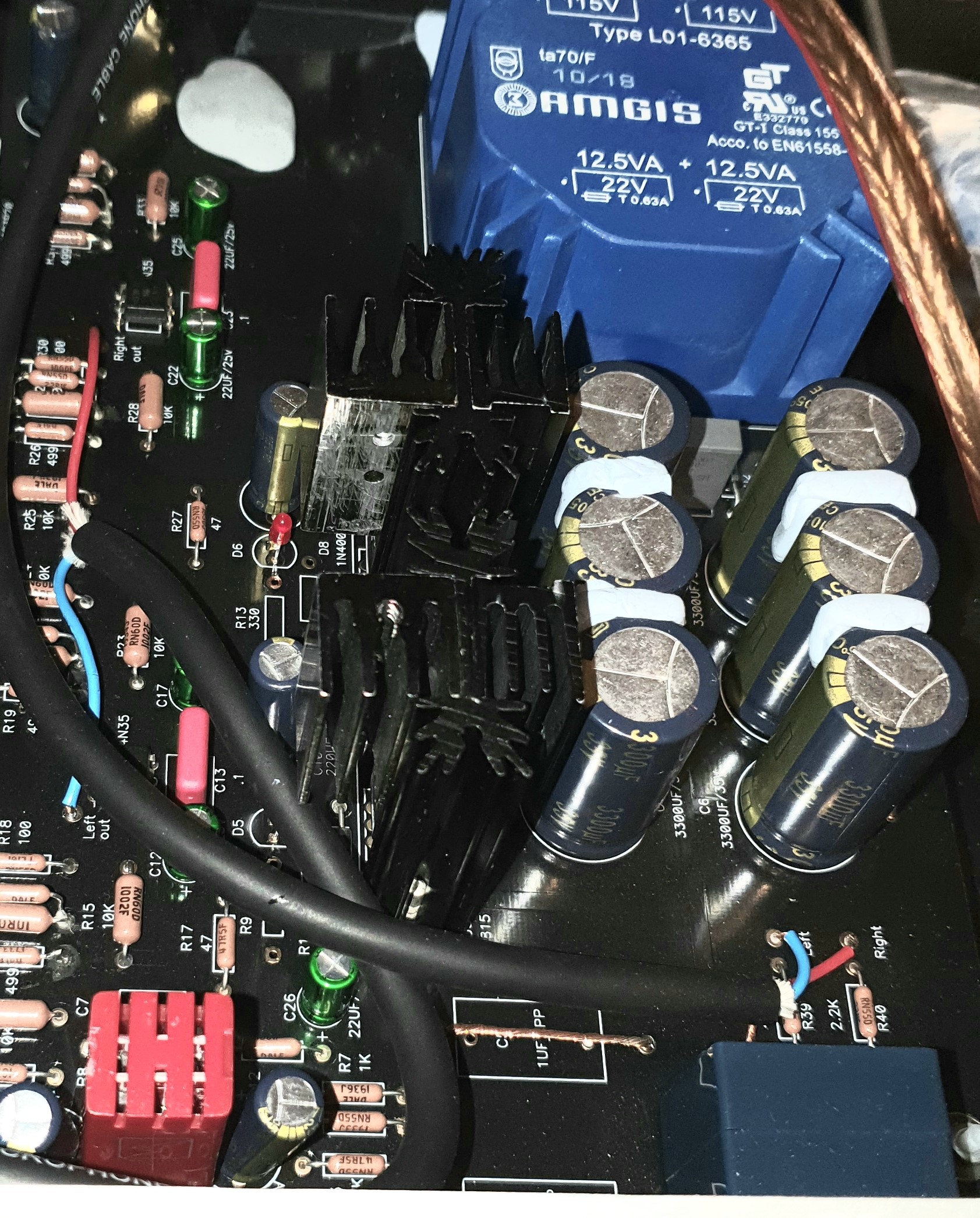

Personally I beefed up the heatsinks quite a lot, especially for the regulators:
As for the board, it sits on a HiFi2000 23x23cmx8.3cm case, and is elevated from two plastic "bolts"of plastic of 5mm each, which are then screwed throught the bottom place of the chassis.

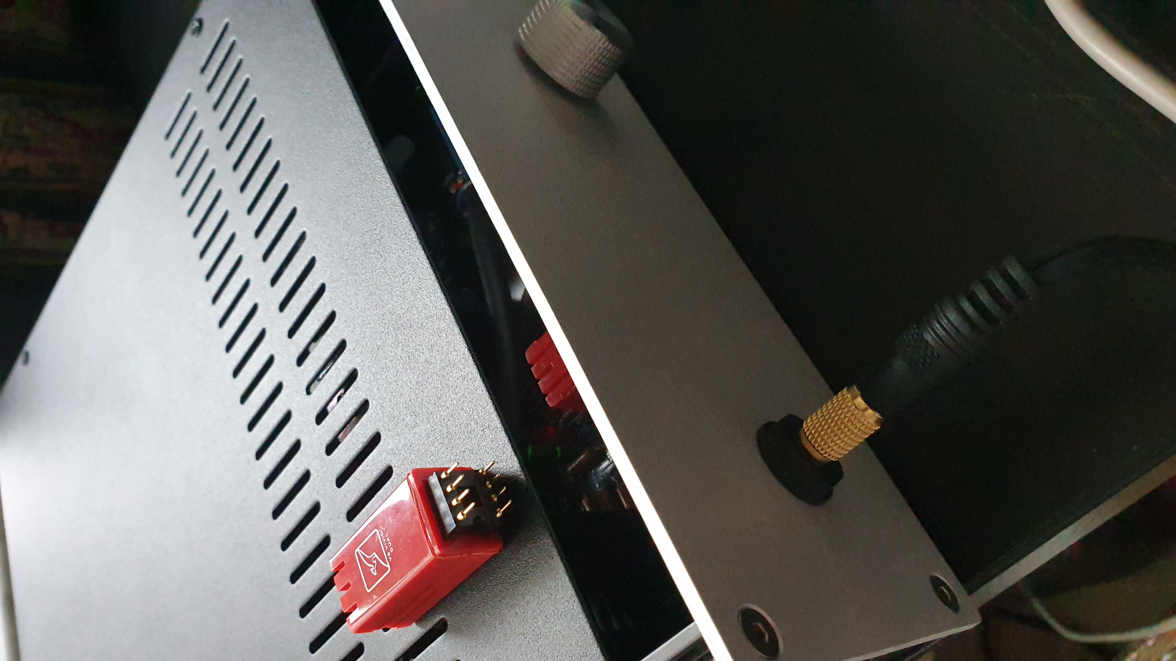

I received Burson V6 vivid and it's now burning in. First 2 hours of out-of-the-box listening differ a lot from the hour 24, so I will refrain myself from giving feedback until I reach at least 150h.

You can pull off the socket of the Burson so you have a contact point less.
Don't know why they come with a socket on....if it is a transport protection or maybe just a "free" socket for use in a PCB.
I did for the one that is in 🙂
Yeah i assume uts a free socket, otherwise it would be difficult to swap.
