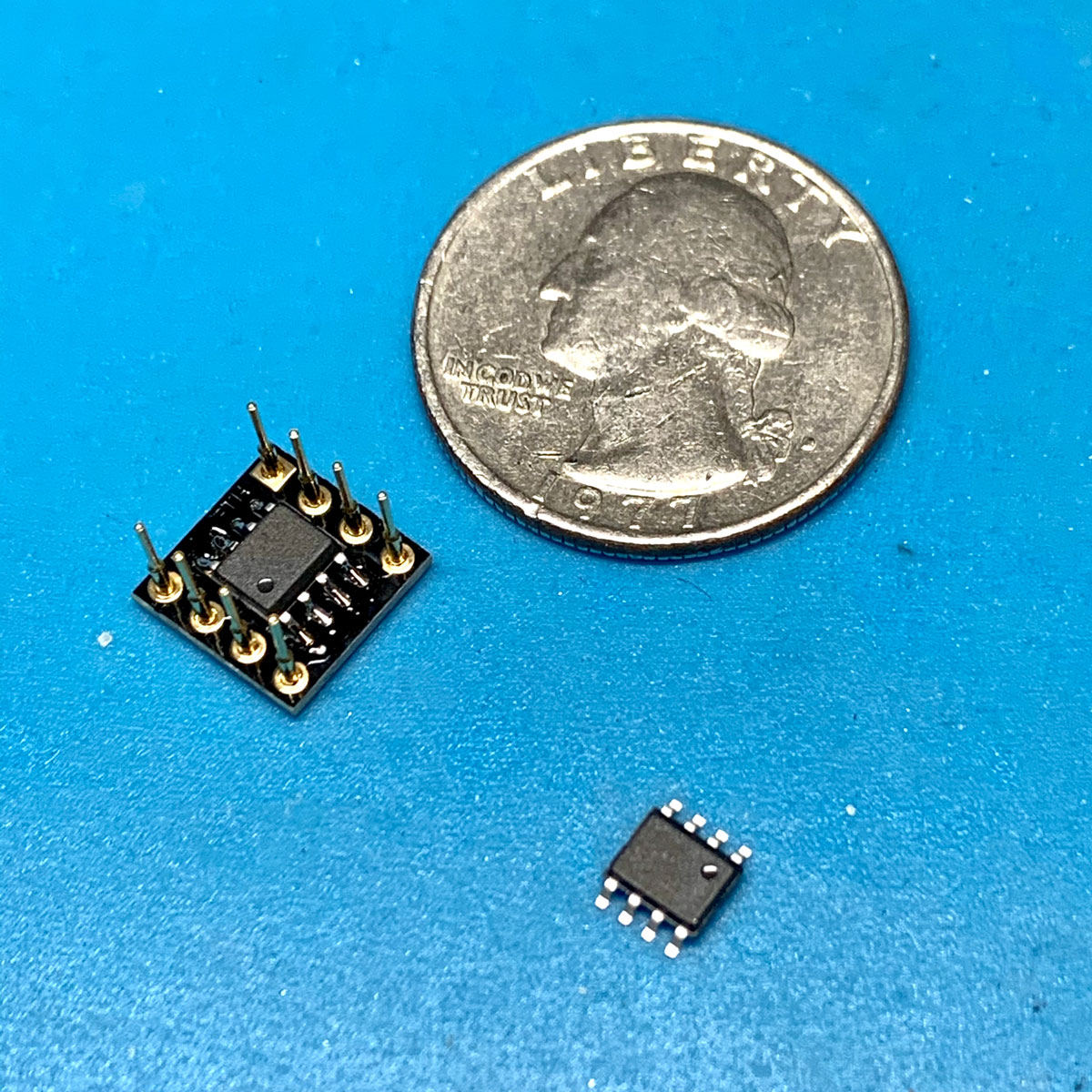

Yes you would need two of them and some BrownDog adapters. I was just pointing it out as the price is good compared to buying at Mouser or Digikey, if you are interested in trying out the OPA627. I have 2 in my WHAMMY right now.

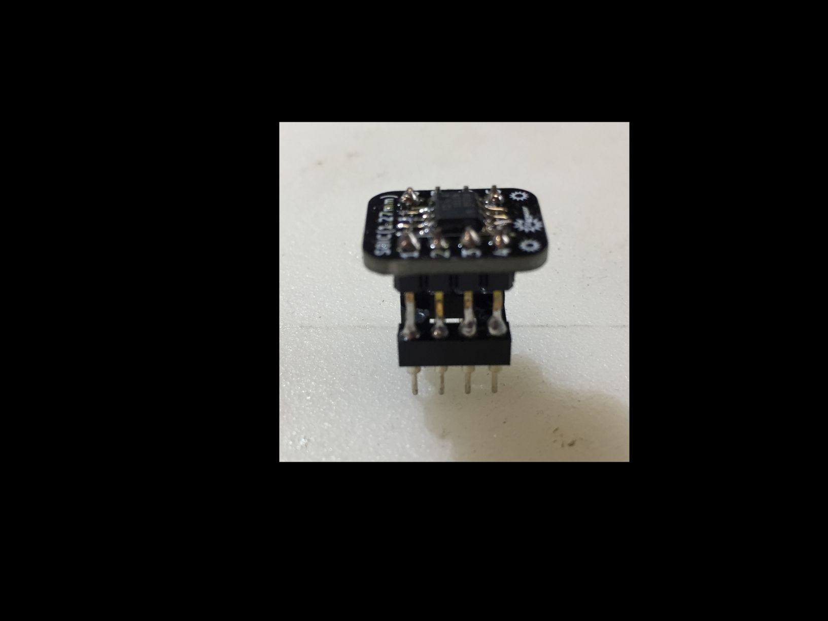

I used some of those adapters. You can solder two single OPAmps (I think it is SOIC-8?) on one DIP-8 (top and bottom). Nice possibility to use single OPAs in the WHAMMY.

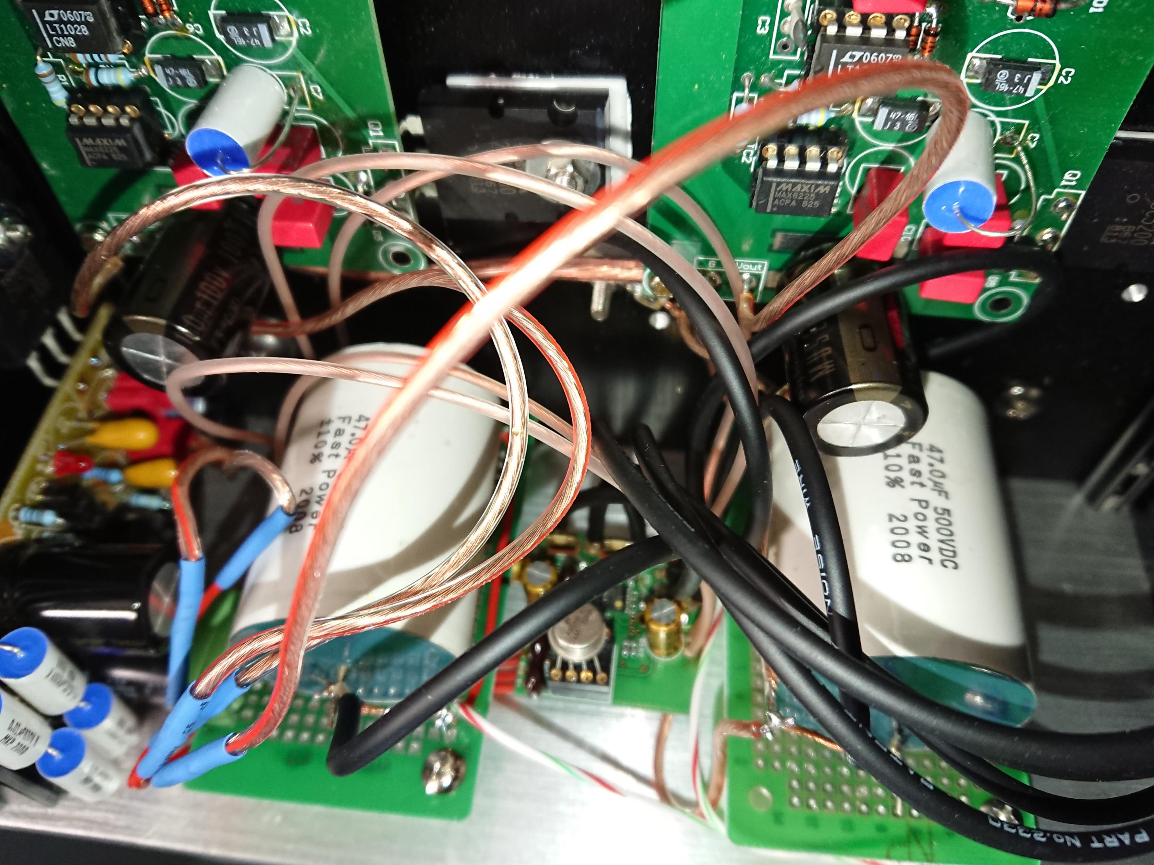

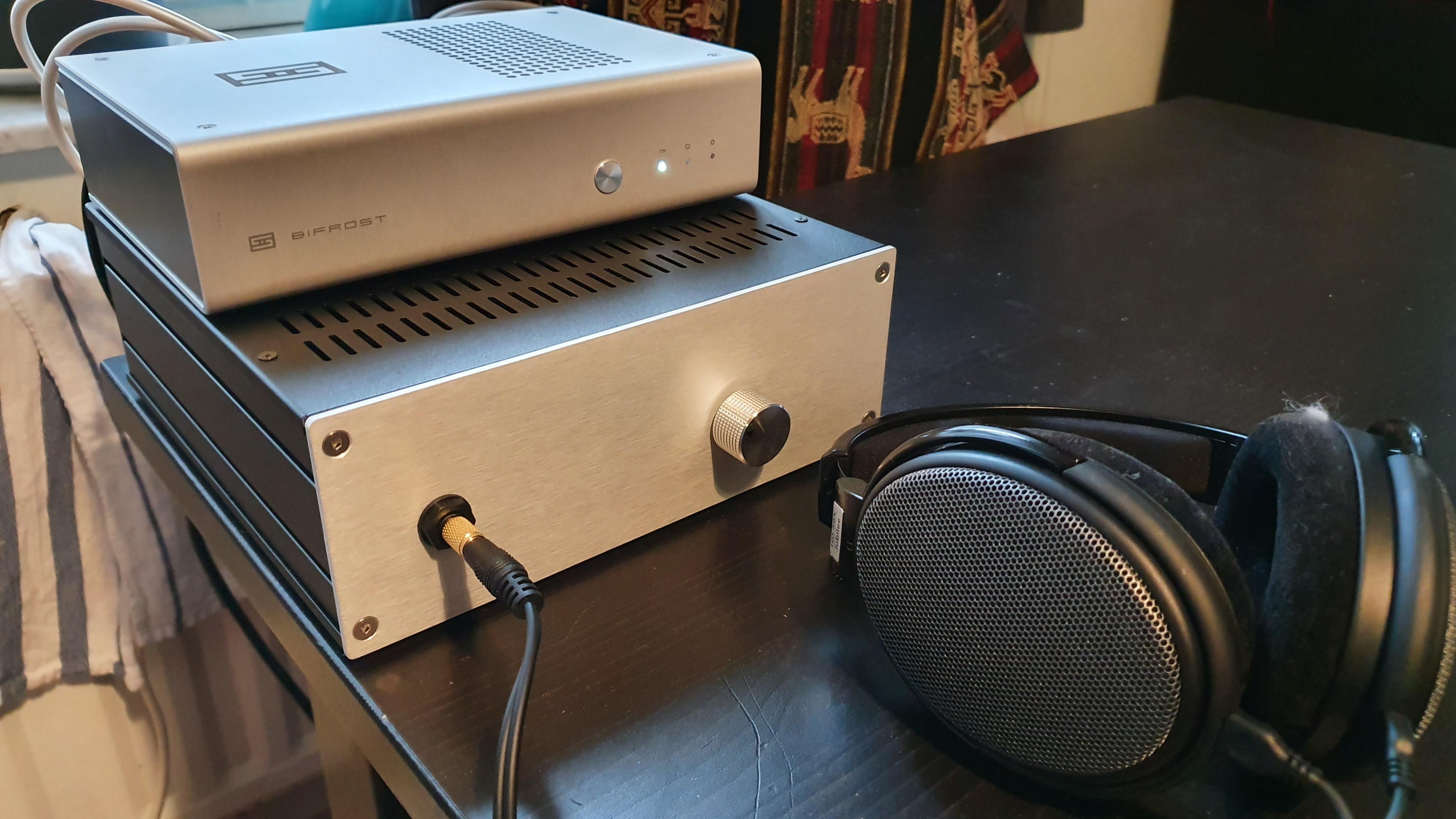

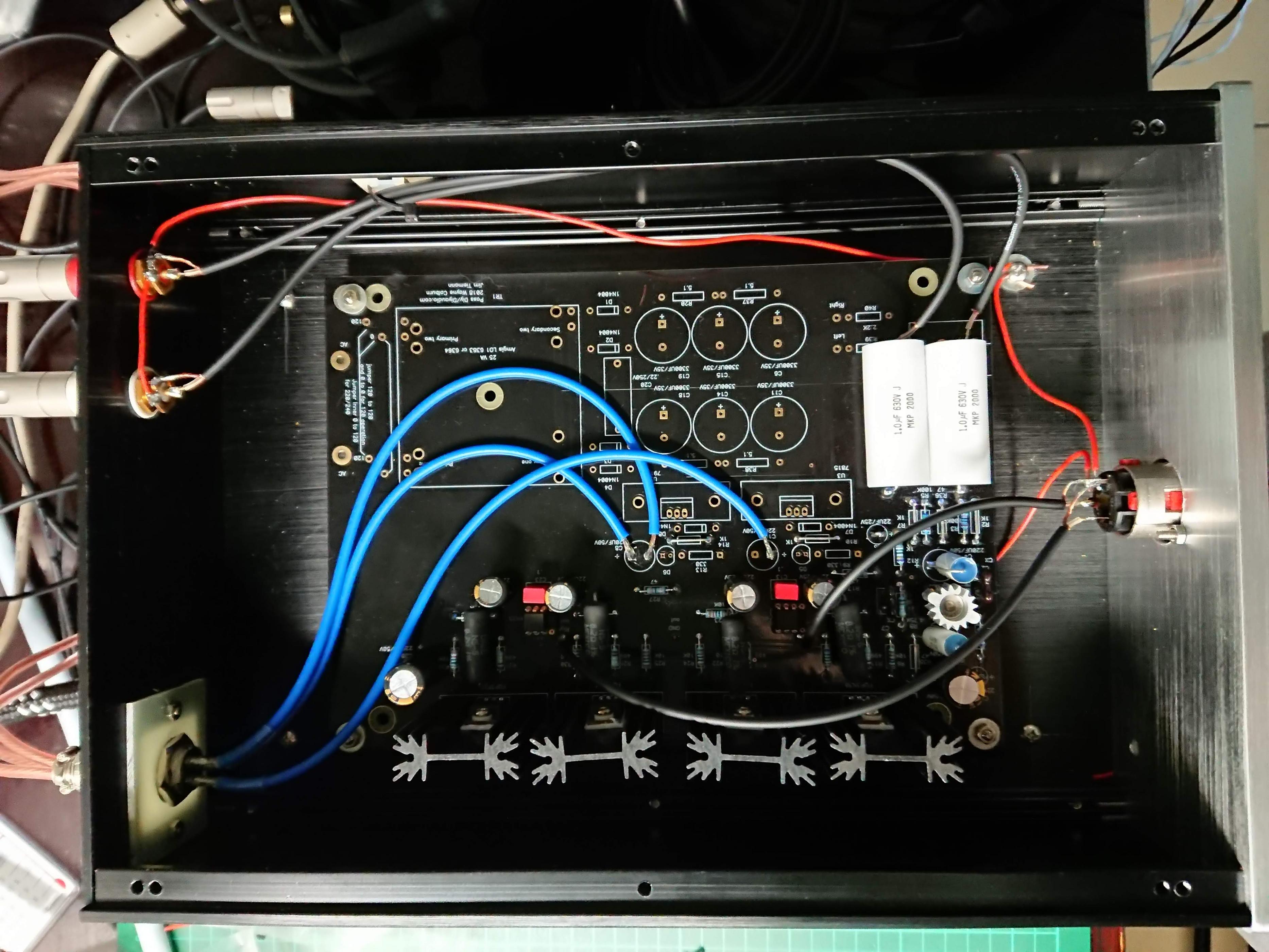

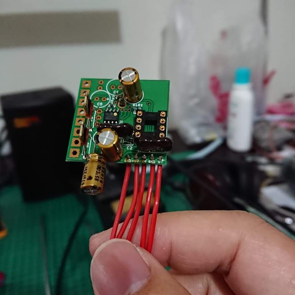

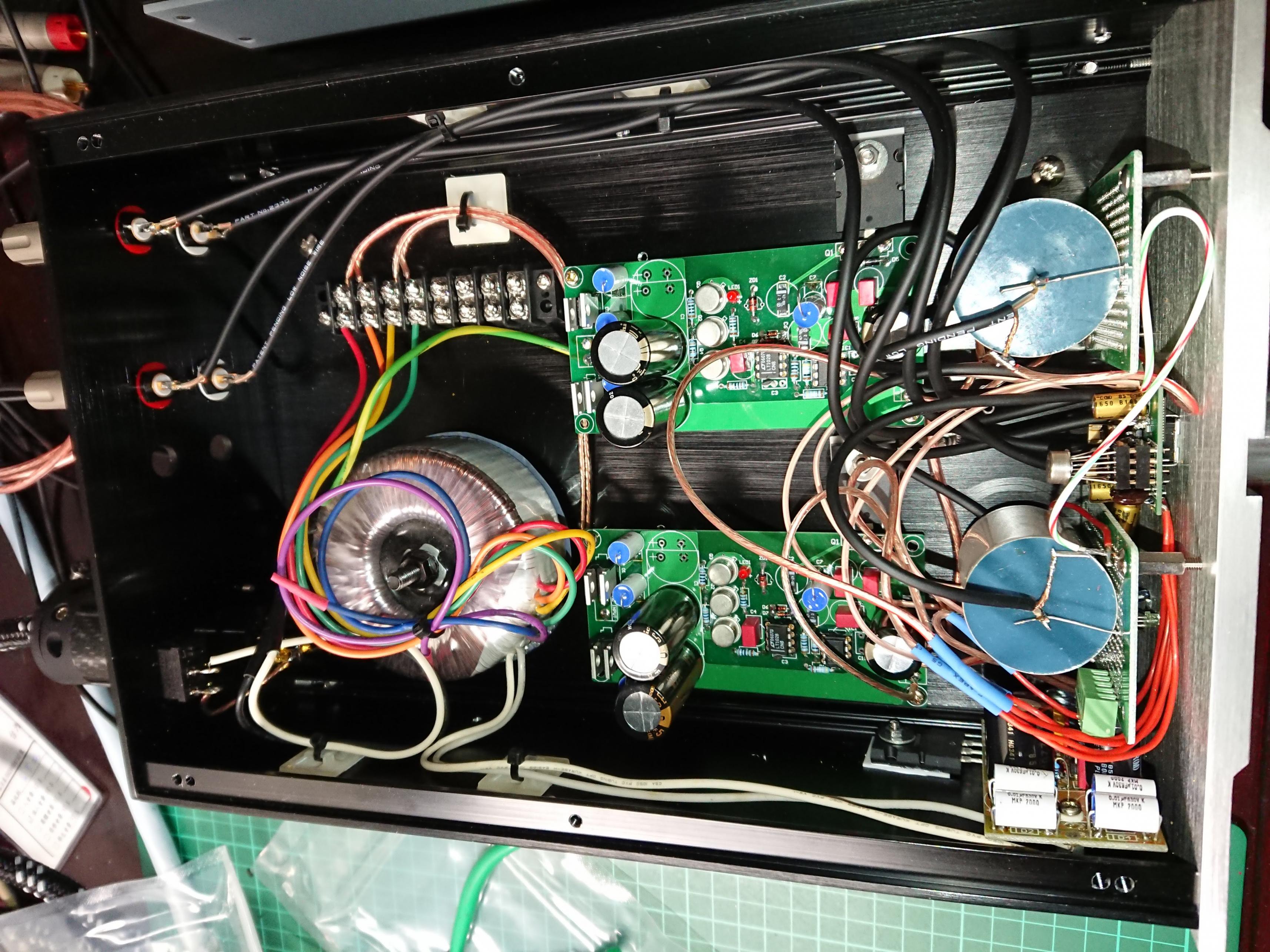

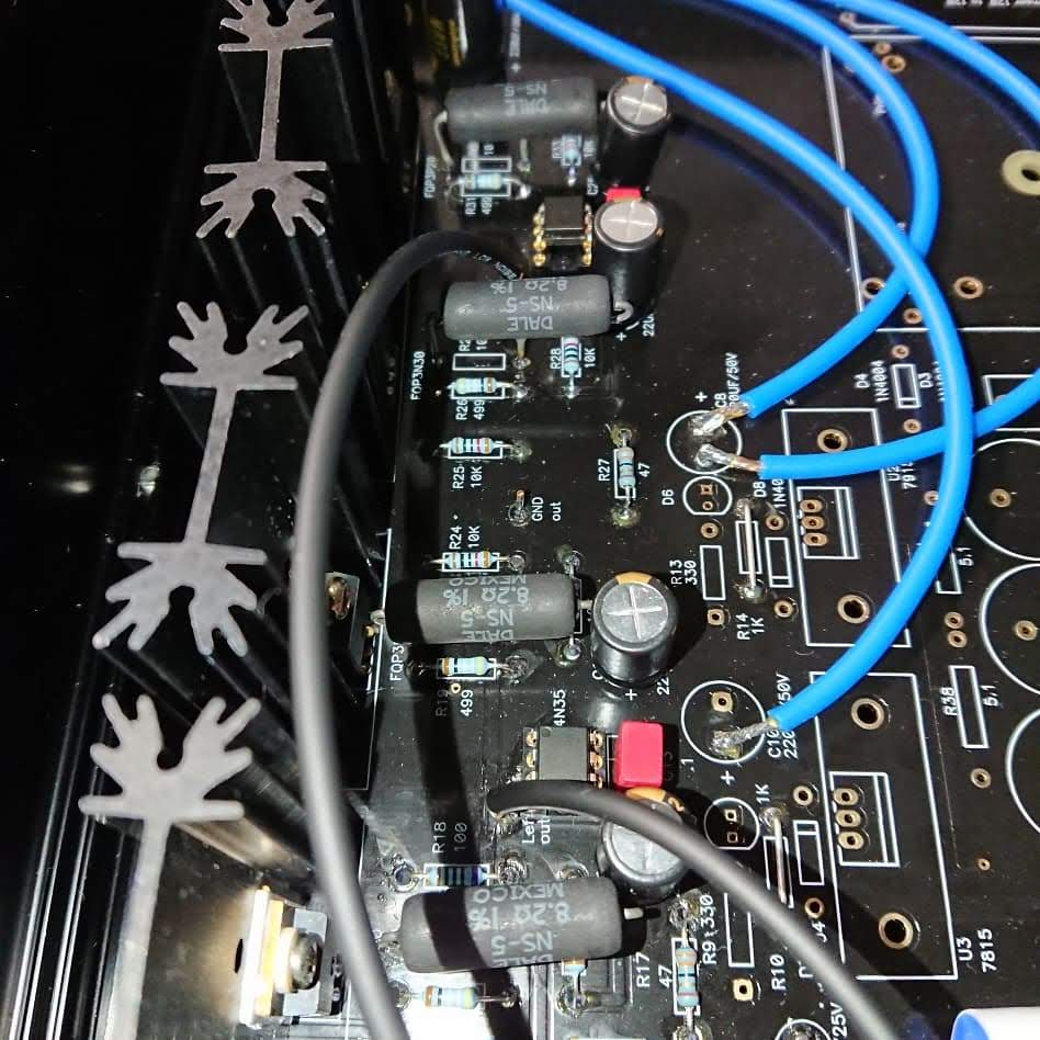

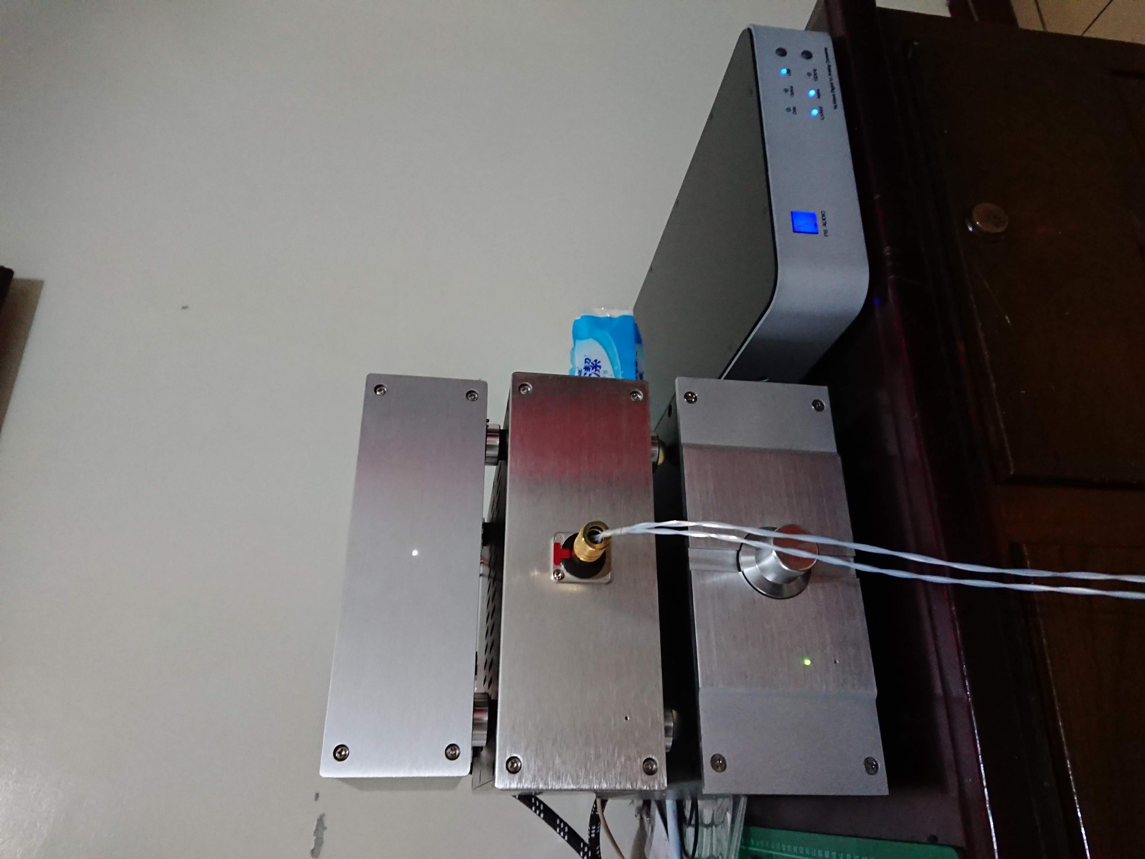

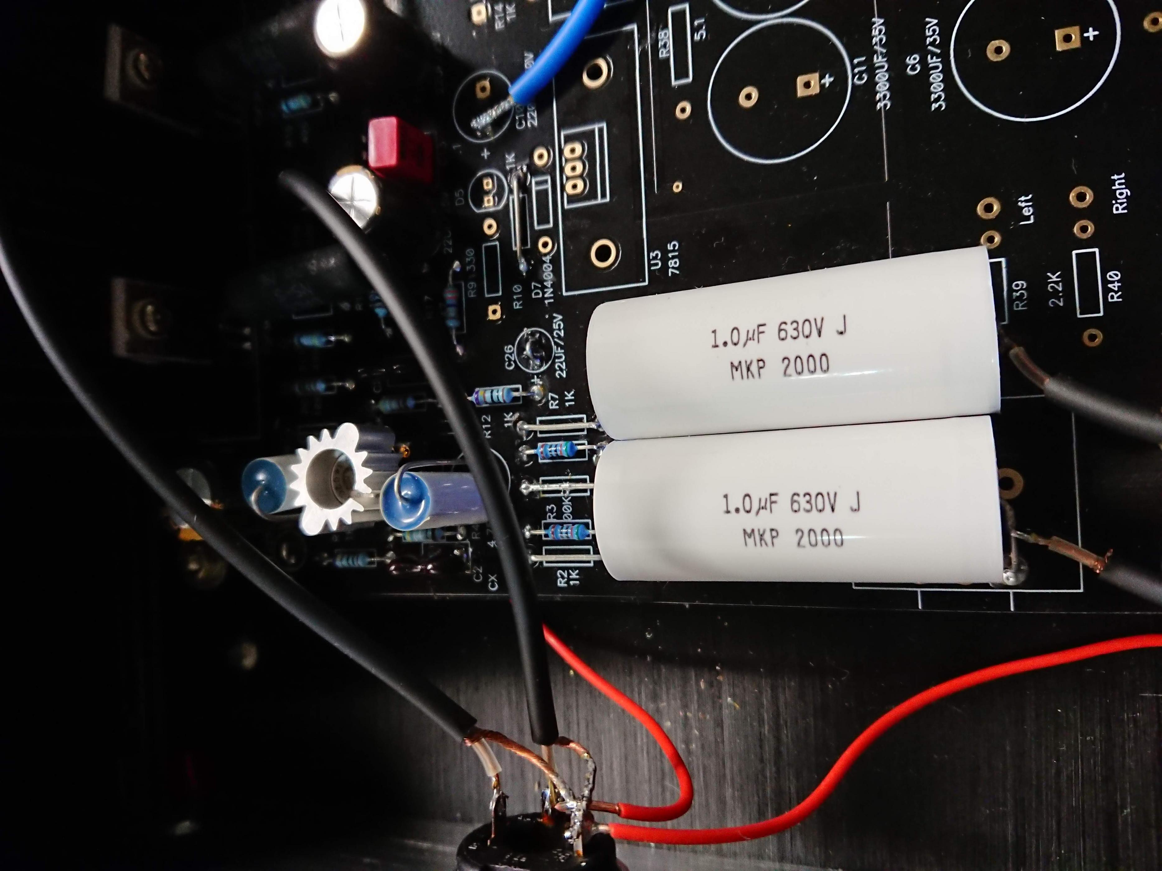

Hi~ Guys,
I just finished my Whammy headphone amp.
I use some good stuff that I can get, and the most awesome idea is that I used separated PSU. The amp use op 833 and IRF610/9610 with bias resister Vishay Dale NS-5. And more, I use Muses 72320 as the volume control and it is made as individual unit with some good stuff, like T2575 , CDE Mica capacities, MKT input capacities, and op LME4562 .
Enjoy the pictures.
Enjoy the pictures.

SOIC to DIP8 dual converter pcbs. 40pcs for ~$9
40pcs Dual SOIC to DIP-8 Convert PCB Adapter SMD Narrow New Version - DIYINHK

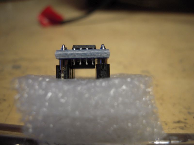

I've listened to almost all the opamps in this forum except the Burson and the single channels. For overall great sound that is wonderful with all my different headphones, I prefer the OPA1612, only available in SMD package. I believe this is the most current design in the TI OPA series of opamps. A noticeable improvement over the OPA2134 and I prefer it to the much more expensive and older design OPA2107.

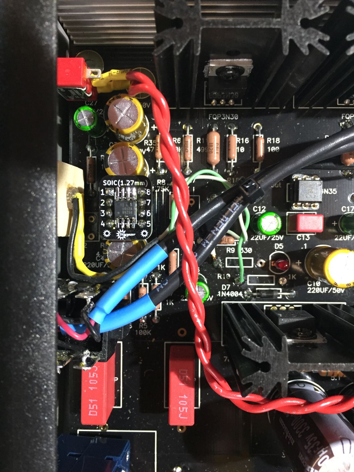

I found it well worth the hassle of adapting. I used tall square header pins soldered to the top of an IC socket to raise the adapter board above the electrolytic caps.
