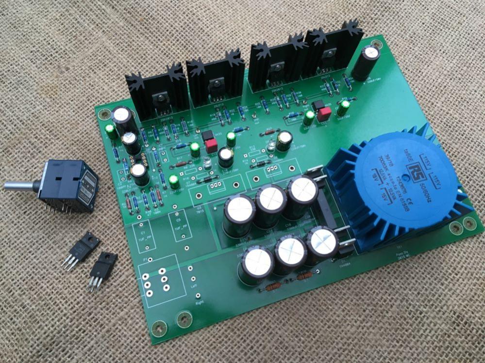

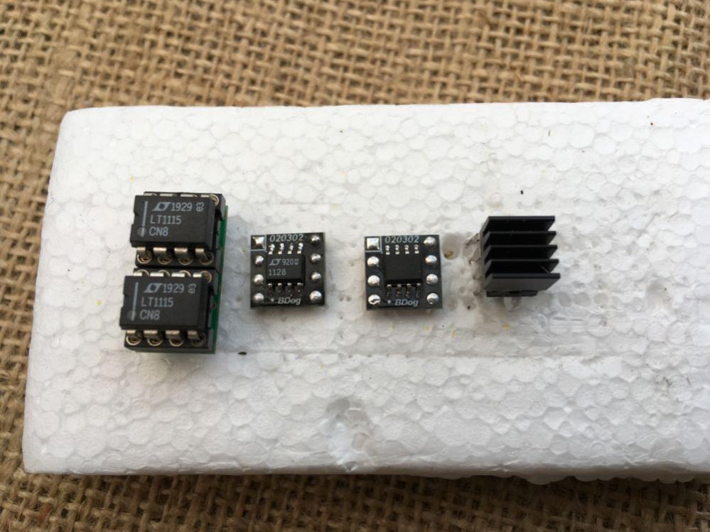

The last few days I have been trying a few new op amps, all mono's on dual adapters: LT1128 / LT1115 / AD8597
So far I really like the LT1115's and AD8597's. All offsets look good at just a few mV. My rails are on the limit really at 16.9V & 17.1V so they do get a little warm to touch.
One tip for people using Brown Dog adapters is to solder the tops of the press fit pins to improve connection.
