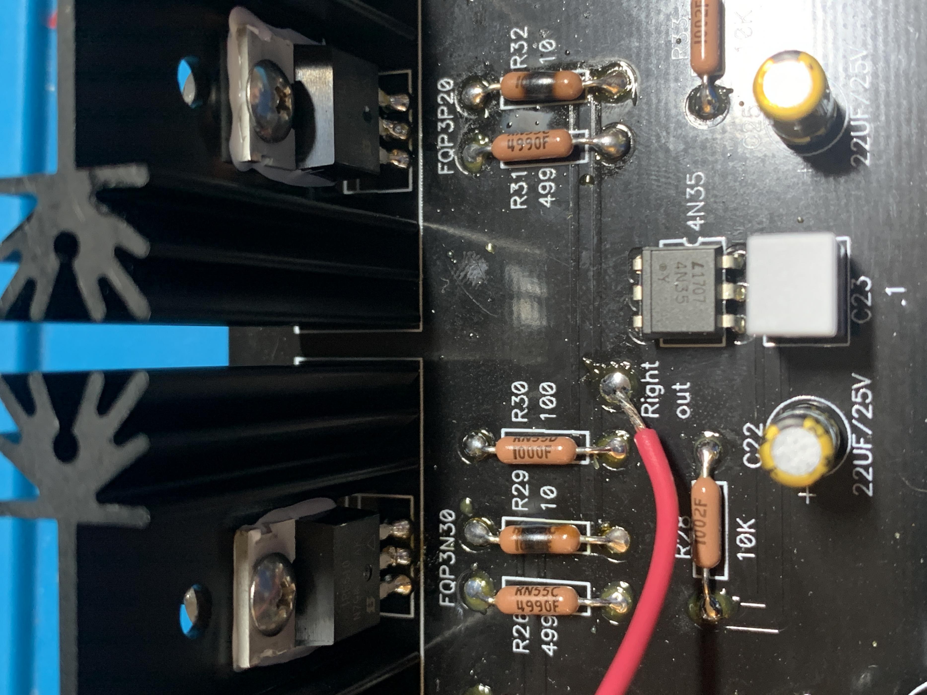

Complete noob here. I've only done the ACA kit so far before trying this and that was pretty easy and went together with no problems.
I noticed smells and smoke when increasing the pot and it looks like my R29 and R32 are burning up. I'm pretty sure my PSU voltages are correct (around 16.9 for + and -). I've taken other measurements, but am not really sure what I am doing. I know that the 4N35 is supposed to regulate voltage to 1.2 and that should be detectable on those R29 and R32 resistors. The left channel, which seems to have no issues tests a constant voltage at R16 and R22 of .57 and -.53. But the voltages measured at R29 and R32 are much higher and moving around all over the place.
Anyone have a hint for where to look? Thanks in advance.

You are pulling a LOT of current through the output pair. Thats why the bias resistors are burning up. You appear to have the proper resistors in the area where we can see them.
Look for solder bridges, stray crumbs of wire, that kind of stuff on both sides of the PCB. Also make sure nothing is shorted to the mosfet screw.
I noticed the lid came uncomfortably close to shorting on the top of the heatsinks, so I went ahead and isolated them all. I was worried about minor lid flex causing shorts.
That is a potential cause. If you want the best cooling and don't want to use electrical isolation, you could possibly isolate the underside of the lid instead with tape.
It is an IRF610 ….same I have in the kit. It is placed correct. I don't think we can see the cause of the problem in the picture.
