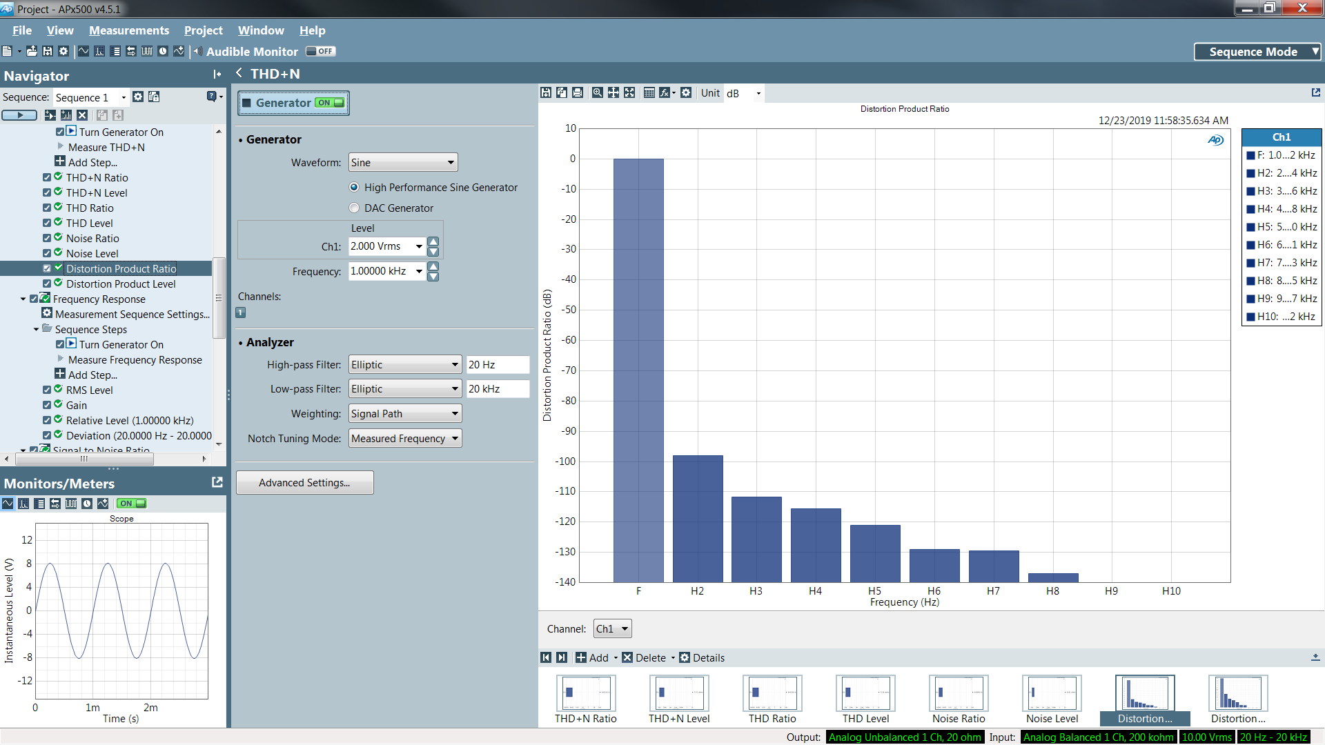

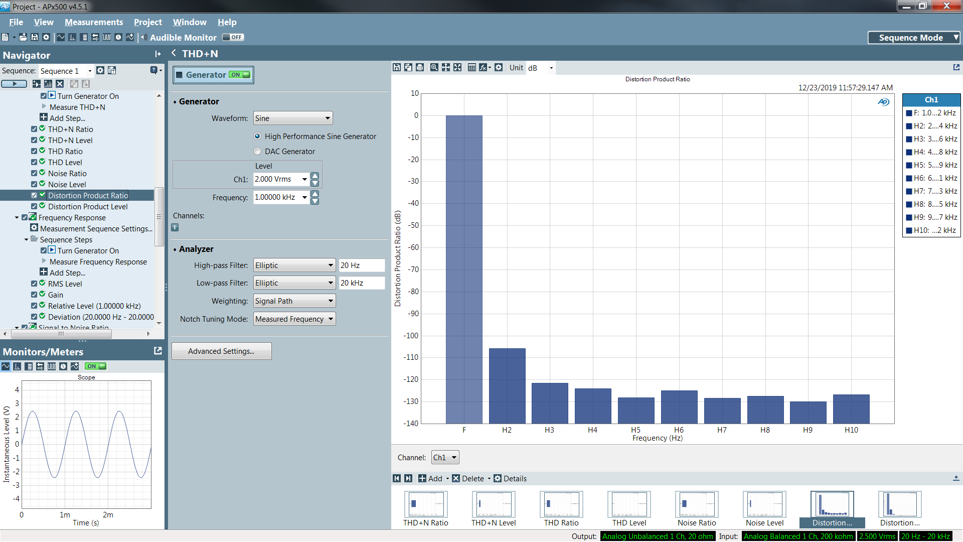

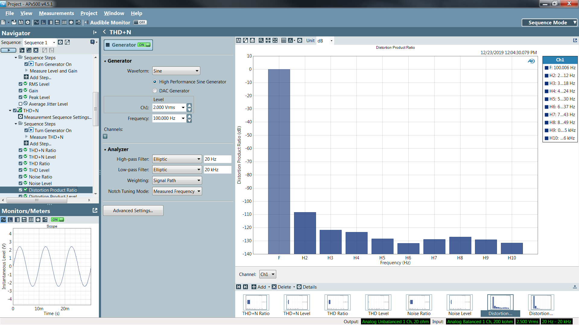

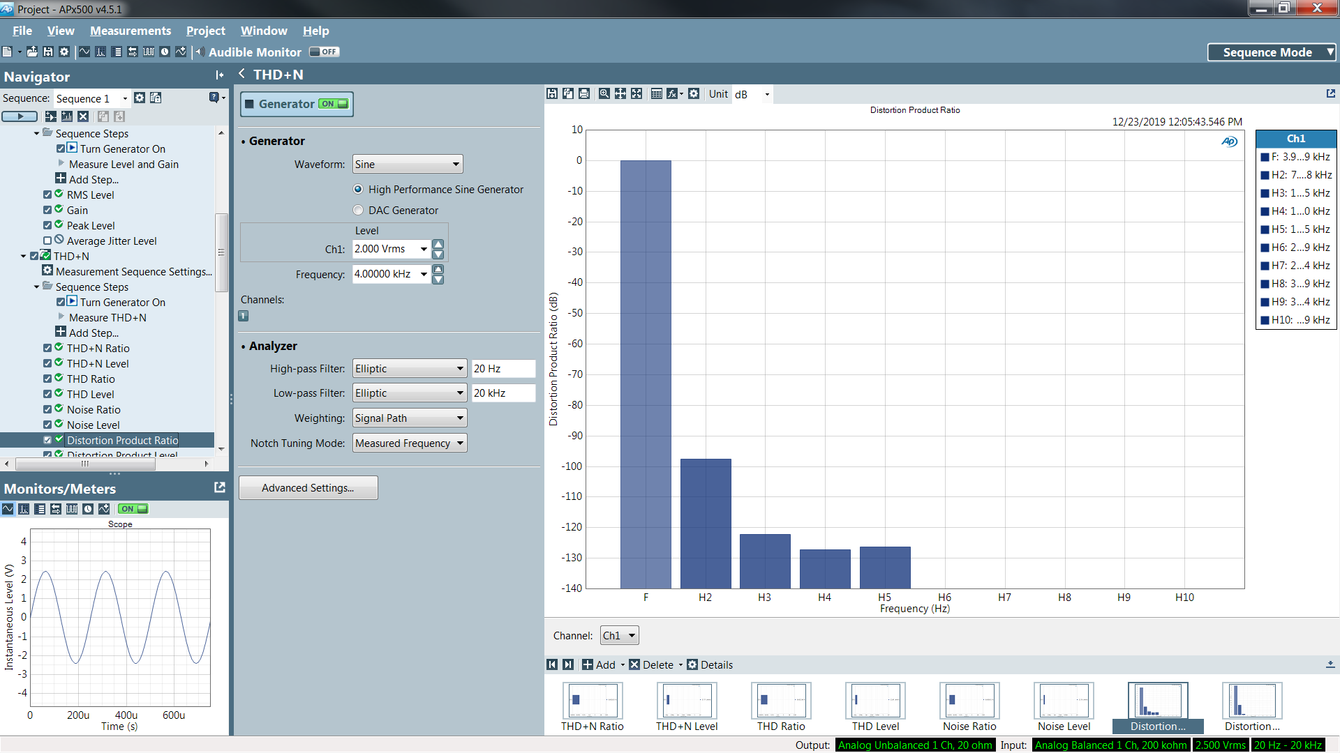

Hi all,
I have been having some fun in trying to learn how to use APX555 and will present my first newbie measurements below.
Tested Whammy config: 22V transformer ; IRF Mosfets; 6.8Ohms output resistor ; OPA2107 Op Amp, 150Ohms load.
I can confirm that the distortion is mainly 2nd harmonic, with an intensity that nicely decreases with harmonic order.
This profile also seems to be consistent among frequencies. (tested 100Hz,1k,4k). Most testings done with 2.5 and 8Vp output.

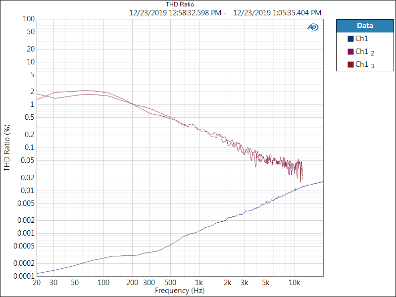

The "THD Ratio" figure (measured at 8Vp) is interesting as it shows the Headphone Output (blue), and the Op Amp output (red/purple), which shows that the Op Amp has to compensate more in low frequencies, and does not seem to be able to correct much higher than 10k (due to MosFet input capacitance maybe?), which, seeing the THD+N numbers, is fine. I recall seeing a constant THD=f(Hz) looking at 6L6 figures, so I am a bit confused.
I believe that this figure really shows how well the Op Amp works with the rest of the circuit. I'll measure again with various Op Amps... will be fun 😀

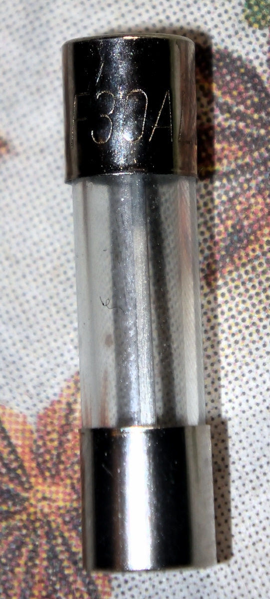

Yes, maybe I use a nail instead.
I remember I looked at it a while ago and I just thought that it must mA. I then had a closer look and the wire inside is quite "heavy" compared to what we use normally 🙂
I did not know either…..the largest I had until now was a 16A T-type (slow) filled with sand so I could not see the wire inside. Now I know how it looks like..... 🙂
Maybe other that has got the kit (my kit is rather old) should check the provided fuses used for primary. They should probably be around 30-80 mA for 240 VAC (and not 30A).....depending on bias setting.

30A ? …..at least it is a F-type.
Is it because you know I like high bias? 🙂
Does the IEC have a fuse for live and neutral? You could use the 30A on the neutral side, some countries don't allow fuses on neutral...
No, the big Schurter has only for "Live" and then a place for a spare fuse (all plastic inside). But this Schurter will be used for another future project. It does not fit the Chassis I will use for Whammy. I have plenty of fuses so I find one that fits. But a good idea for some use of the 30A fuse. In M2X chassis I use double fused IEC's.
