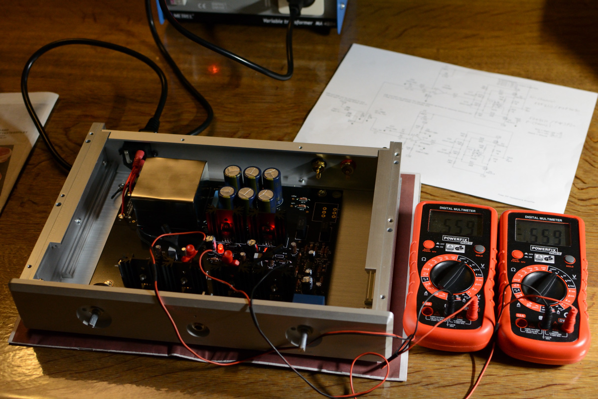

I fired up Whammy this night to check if everything seems to work as expected. I went for 7 (6.98) ohm bias resistors. The picture shows measurement of voltage drop over a bias resistor in each channel after 1/2 hour warm-up or so. 0.559V which is around 80mA bias current. Using the op amp from the kit (RC4580) which seems to have nice specs I have approx. 14 mV offset in both channel. Op amp is a BJT input type so some offset was expected. I had some sheet mu-metal on the shelf from M2X project so I wrapped the blue trafo with it. Next is to connect the connectors / pot. Will probably be done during the next few days.
I run the very same bias resistor, and with the 22vac trafo the regs get very warm, despite my 30%bigger heatsink. I suggest keeping an eye on temos if running lower outputbias resistances.
Also the trafo goes a bit warm, so shielding it will increase temps, but it should be fine.
My settled for about 54 C with open top. Will check later with top on when it is finished. Think it will be ok. The chassis is quite massive. 10mm front, 12mm side panels and top and bottom about 5mm. So it should be good at transfer heat.

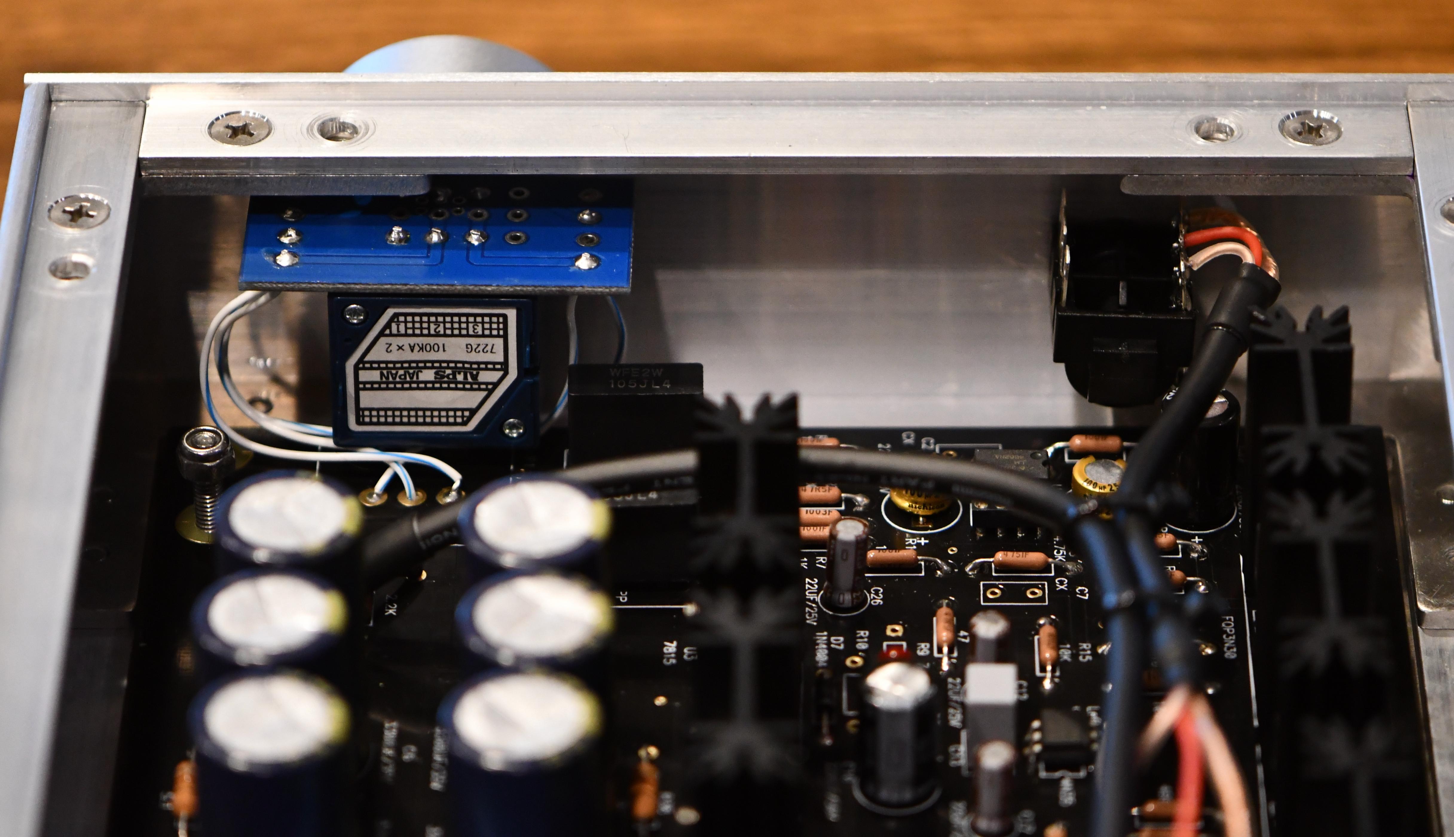

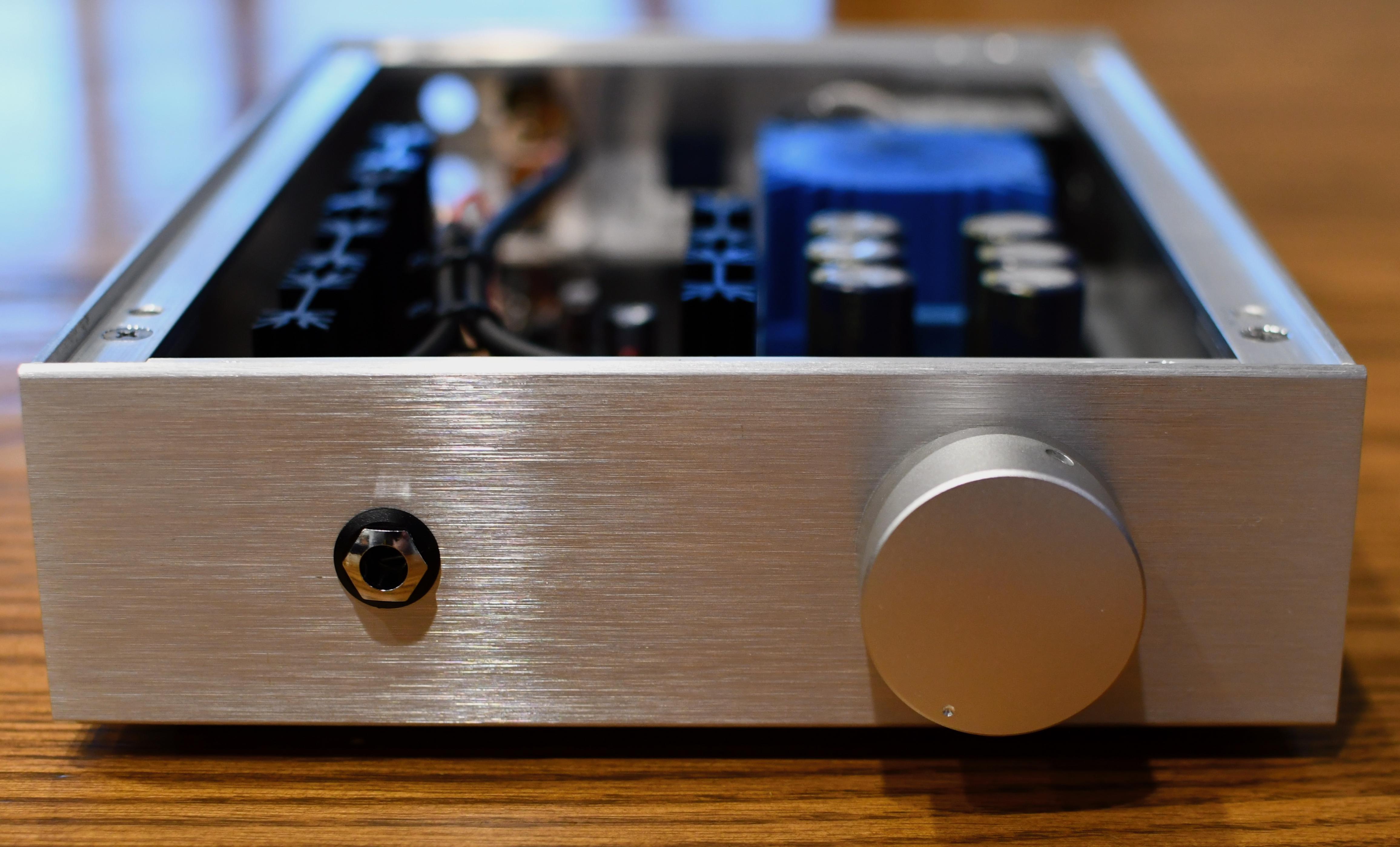

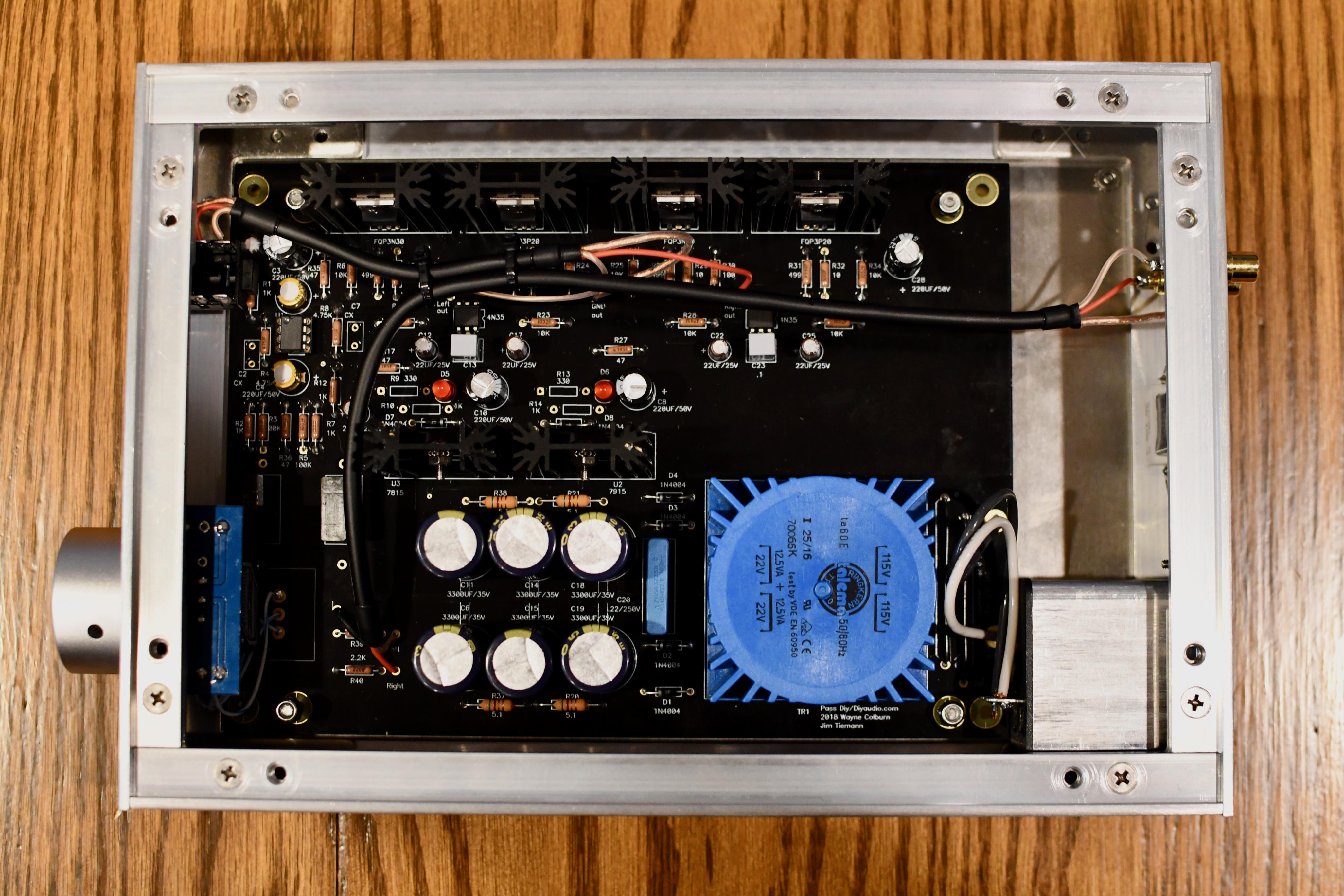

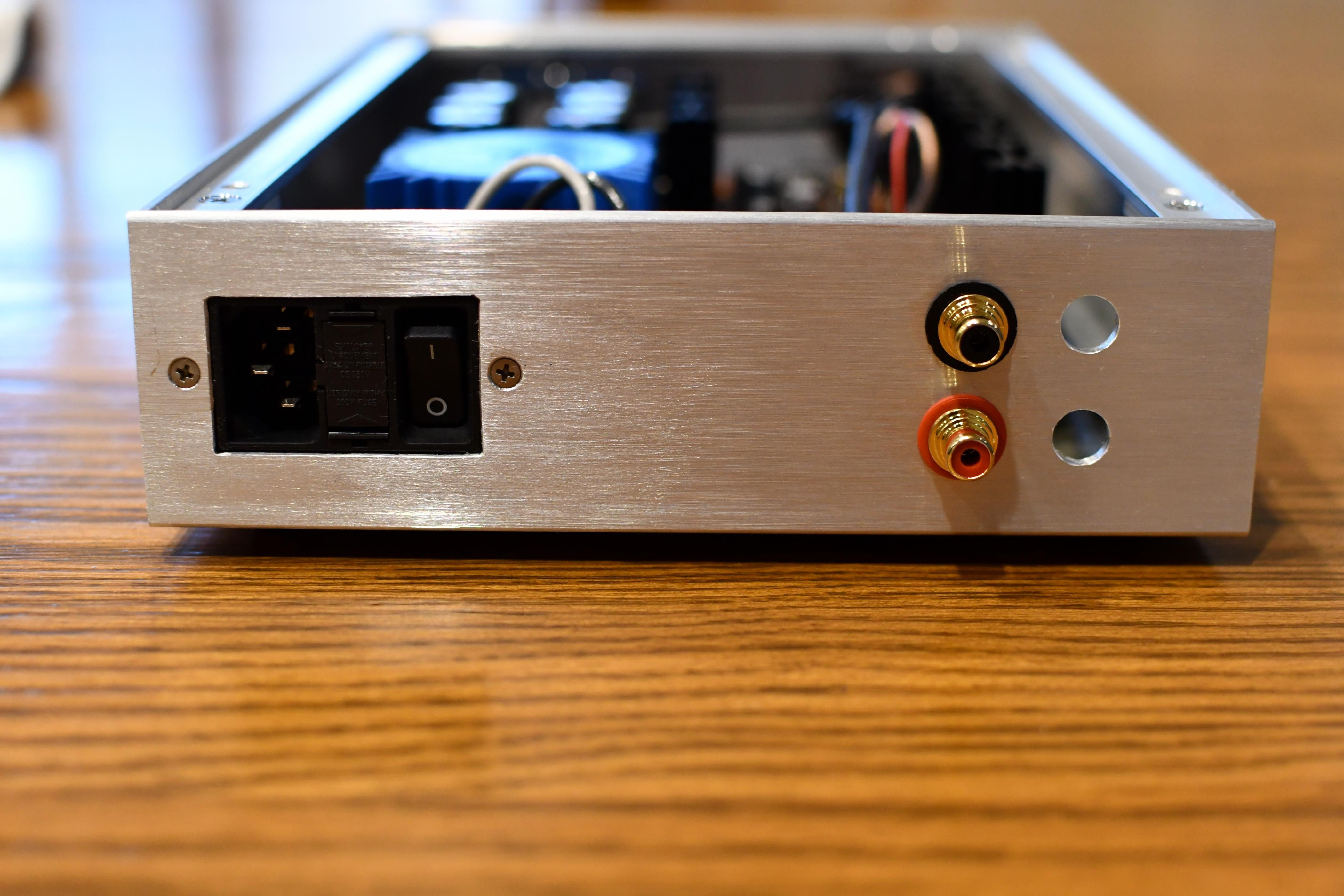

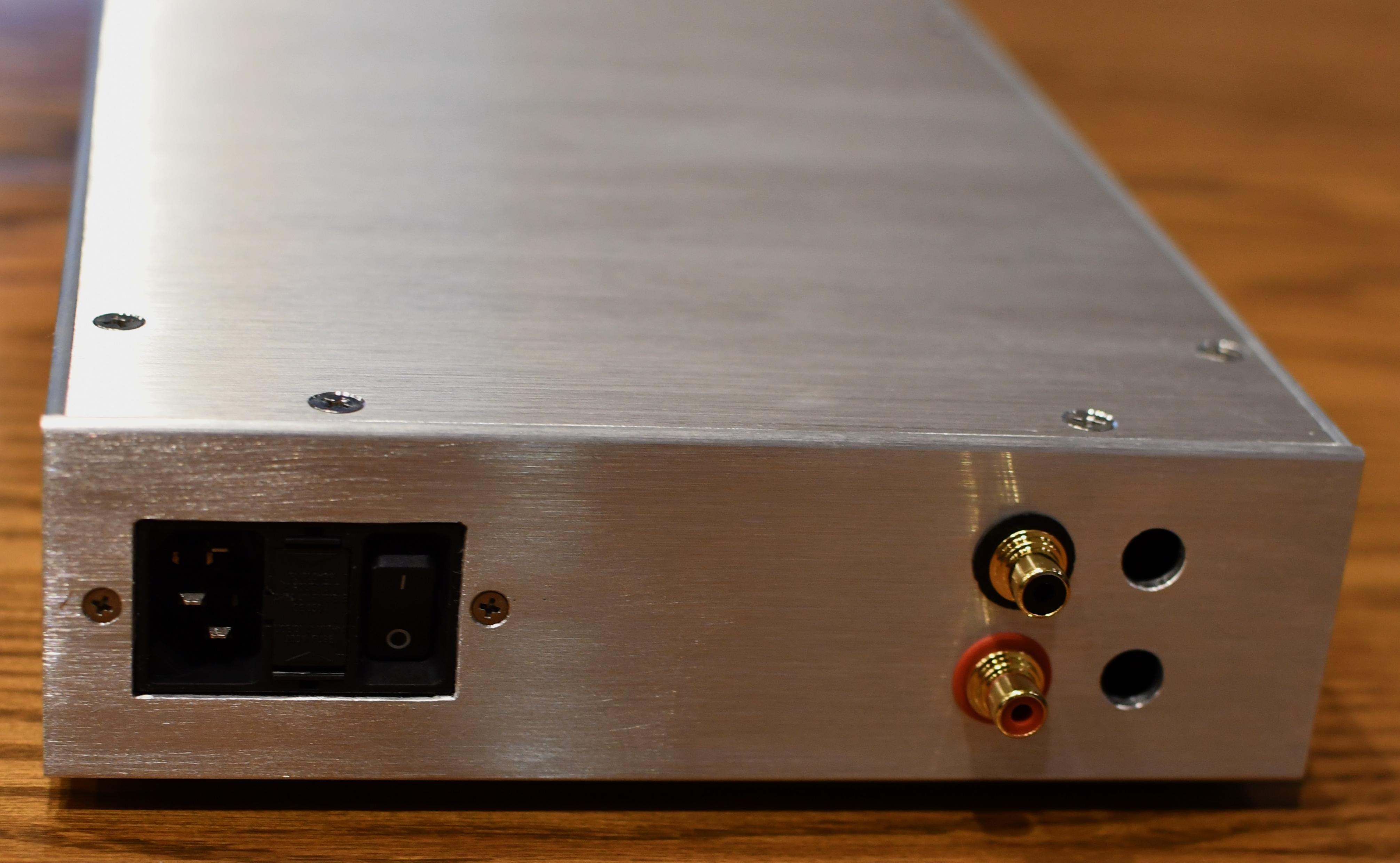

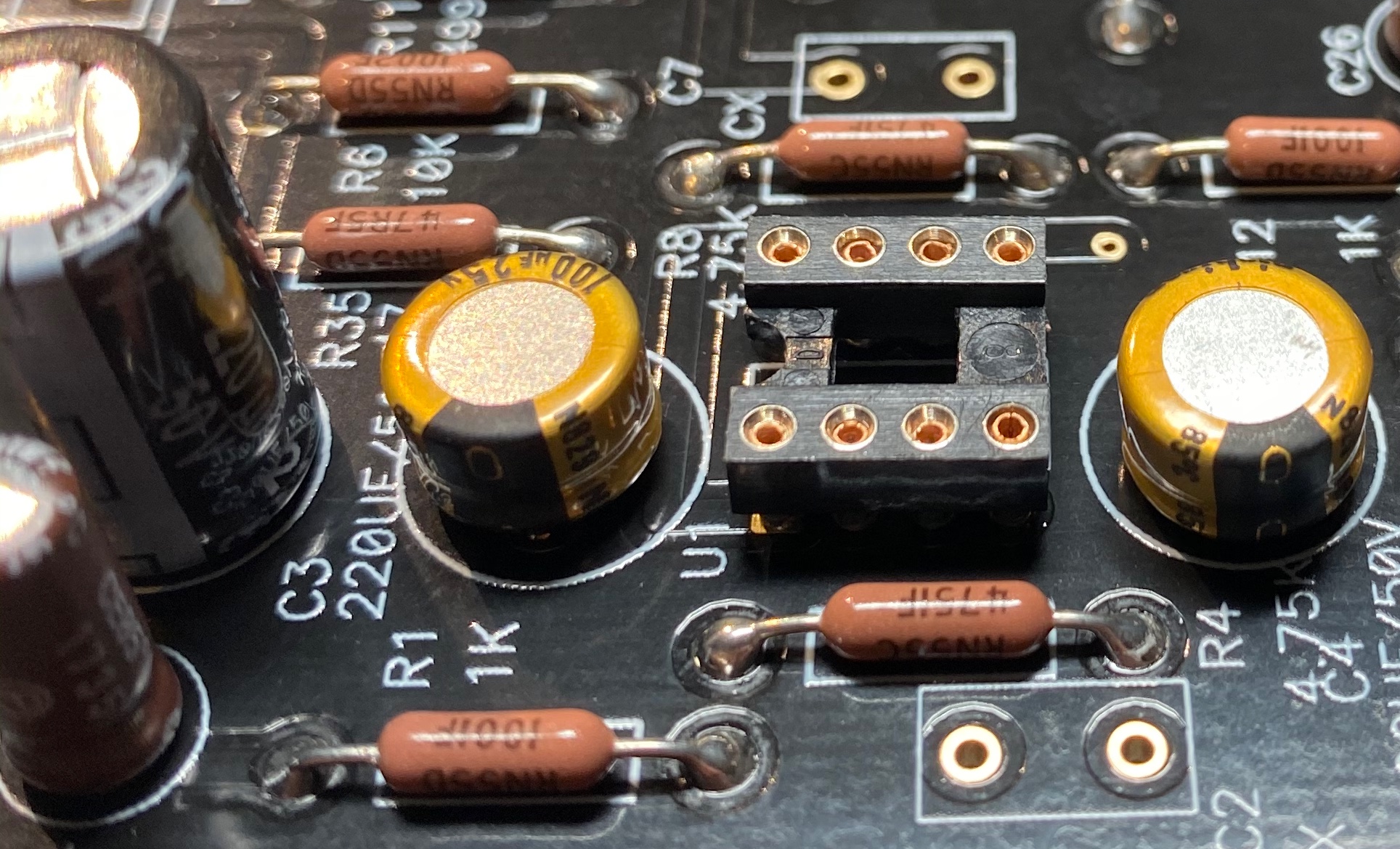

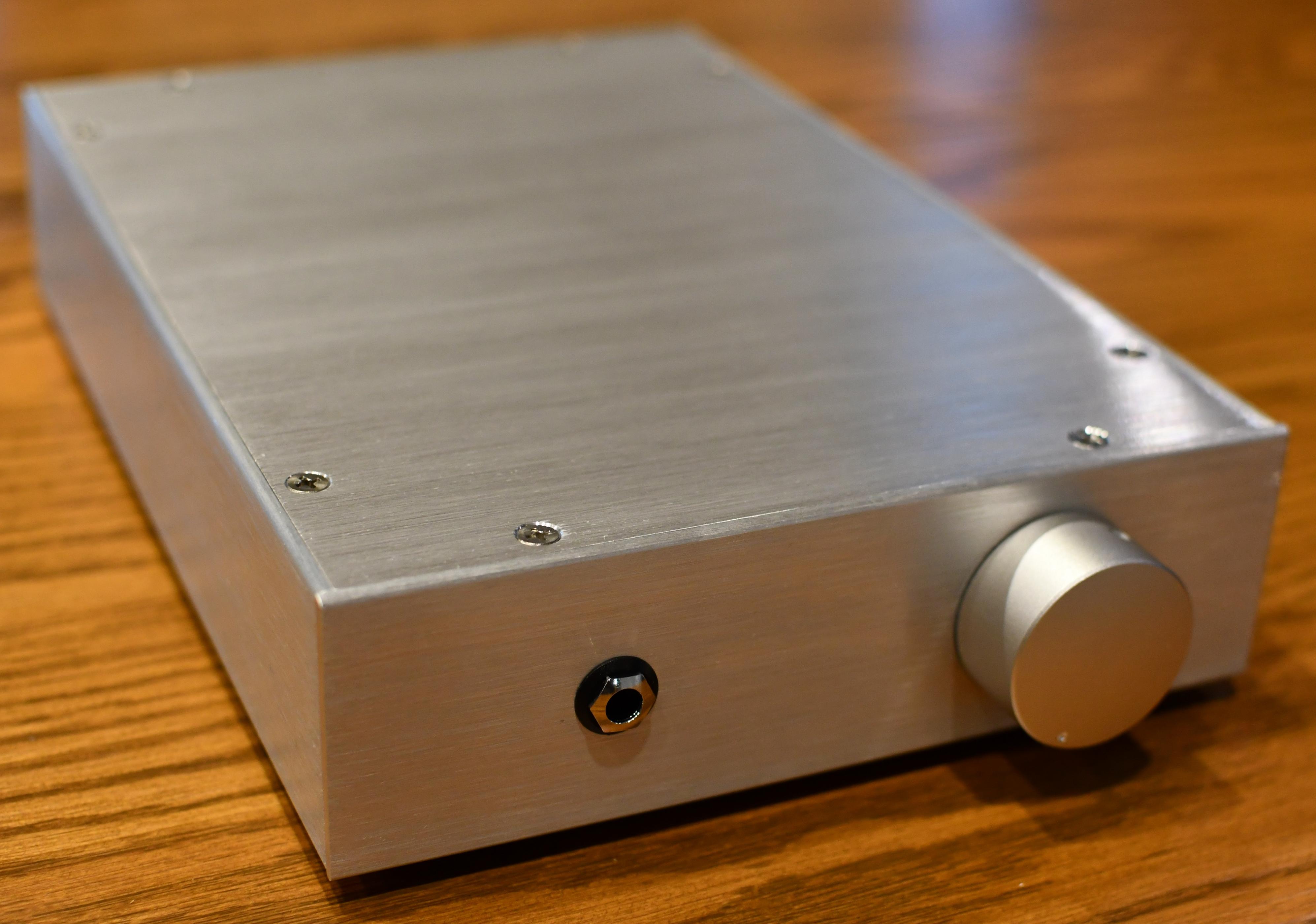

My WHAMMY build, mostly finished (for now). I used the DIYAudioStore.com kit purchased on Black Friday, and subbed a switched headphone jack so I can add preamp outs later that are enabled when no headphone is plugged in, and Nichicon Fine Gold 100µf/25v caps (suggested by @6L6 earlier in the thread) around the op-amp socket to leave more room for op-amp rolling (see the last 2 pics).
I used Mogami 2552 shielded mic wire for the RCA inputs -> board and board -> headphone out.

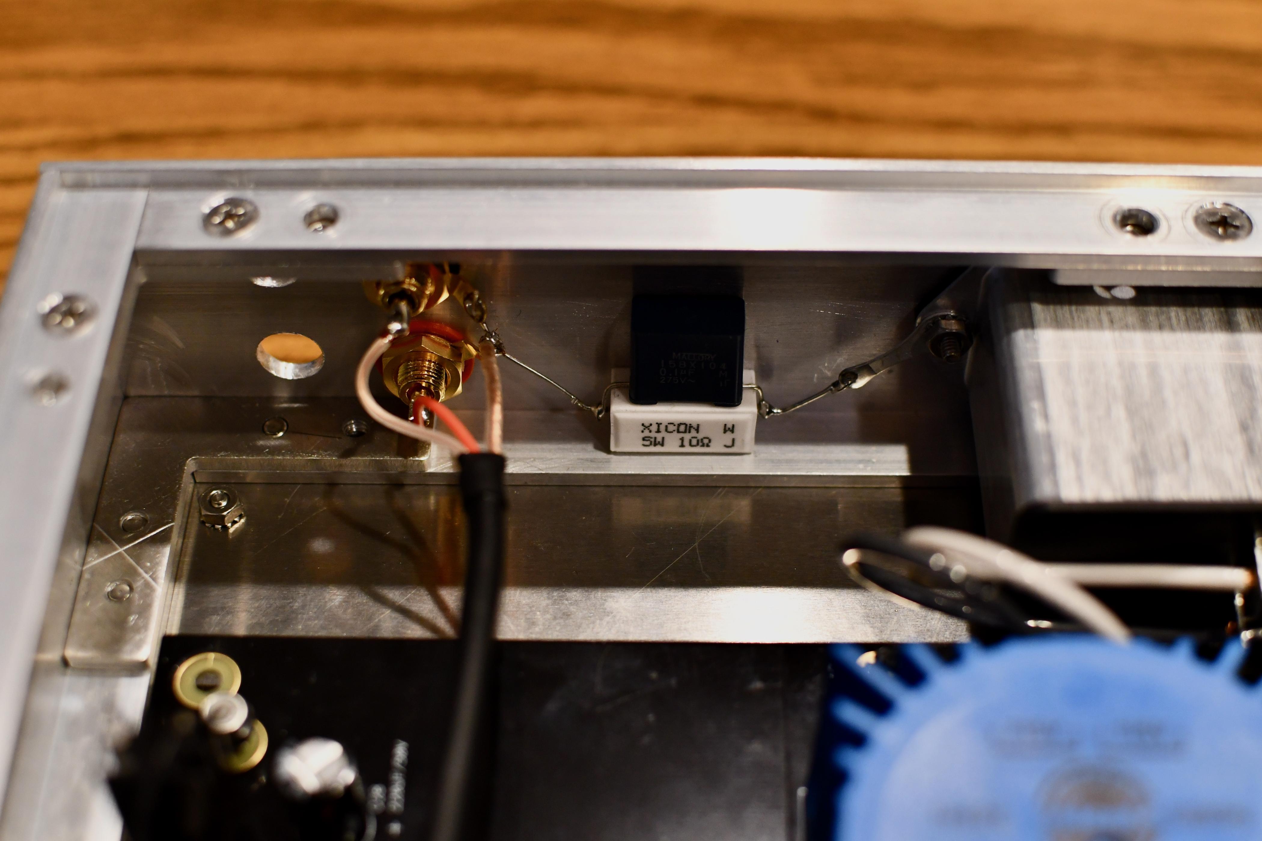

The safety ground is attached to the case via the screws pressing against the case of the IEC input jack. Since the case is currently bare aluminum, I didn't need to sand it anywhere to ensure solid connection. The RCA inputs are attached to safety ground via a ground loop breaker, paralleled 0.1µF cap/10Ω 5W resistor a la AMB M3 wiring.

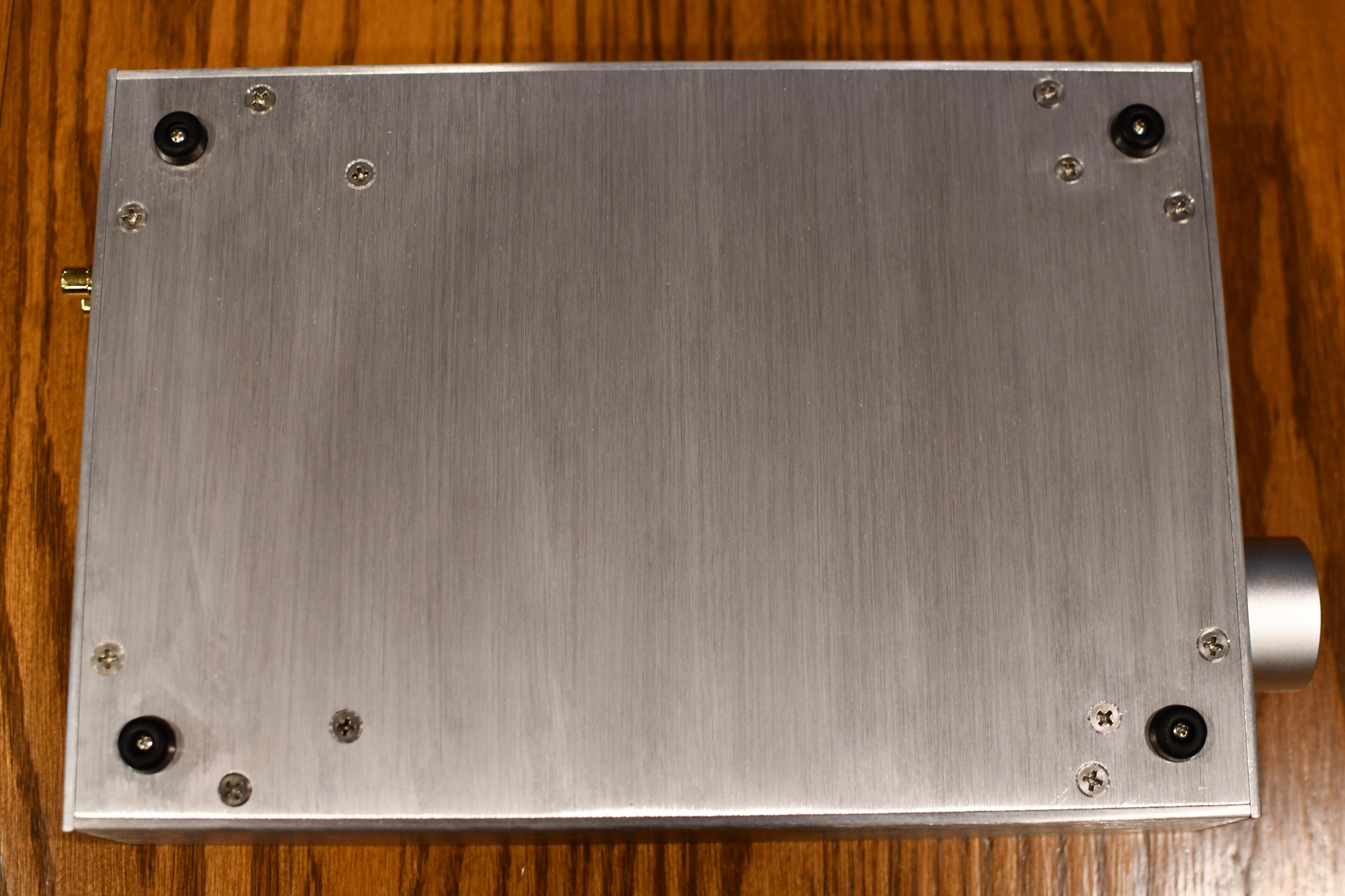

The chassis is from Landfall Systems. I machined the front, back, and bottom panels myself, which I am not entirely happy with my results using a drill press & coping saw - I may order some FPE panels to replace them. I got the brushed aluminum finish and it is way too easy to scratch it or leave fingerprints. You can see where I sanded around the IEC hole (it's a little brighter), because I scratched it in a couple places when doing final filing of the edges to get the jack to fit.
I still need to hook up the preamp out RCA jacks, and pick up some M3 screws/hardware to mount the board to the bottom panel. I'm using M4 hardware right now and my holes didn't exactly line up and so the board is a very tight fit on the M4 screws.
I left it on all day yesterday and took the top off to check temps, the regulator heatsinks were 70-75C and the 4 others were around 55-60C. I will probably add some ventilation holes to help lower the temps.
I'm enjoying it right now with a LM4562 op-amp and either Senn HD650 or Massdrop Hifiman HE-4XX, but it does seem a little bright. I've got some OPA op-amps to try next!

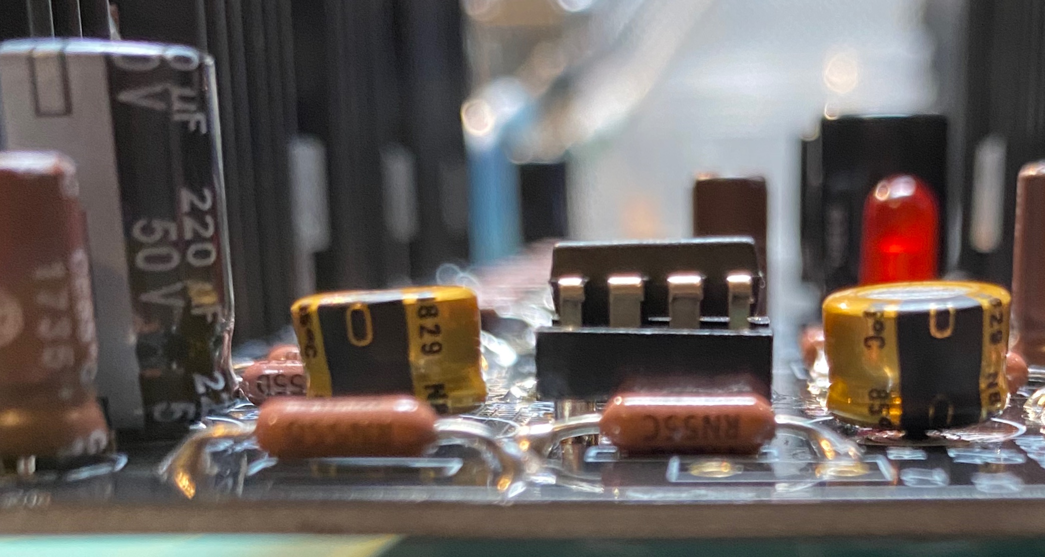

No need to buy new panels. If you want you can make the sanding more even if you demount the panels and work it with sandpaper in one direction until it looks "even". Nice solution with the low profile Nichicon caps. I used 150uF/25V Rubycon I already had which are smaller than the 220/50V in the kit. I have now enough space for a Burson type opamp and can pull up a normal op amp using a couple of pincets. I expect the Burson to be permanent in when it arrives.
I have made my Whammy a "Headphone only" even that I have mounted a switching type jack connector. To try out Whammy as preamp without RCA out it is possible to make a jack to RCA cable or buy one. Think I will do that for a quick preamp test in the future.
