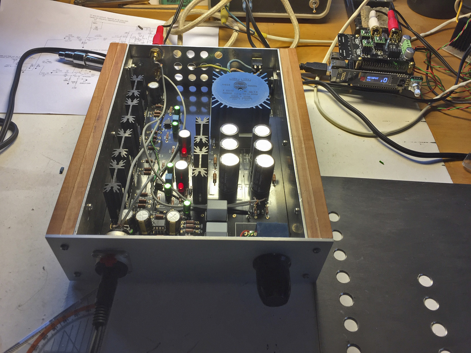

Finished my Whammy. Built as a HPA and pre. Sounds great. Fun project. Thanks so much for the design and build guide!!!
I just finished my Whammy, uniquely used as HPA at the moment.
I am already very happy with the performances. It sounds much better than the JDS Atom I was using so far.

My configuration is:
- Foobar -> Schiit Bifrost MB -> Whammy HPA -> 4.5mm modded HD58X
I went with:
- IRF9610PBF/IRF610PBF Output transistors
- Taller and cheaper heatsinks "Aavid 531202B02500G" (38->51mm height)
- Pana FC capacitors for decoupling
- 2xWima MKP10 250Vac 0.68uF for coupling on C1/C5
- MC79(8)15ACTG regulators + Diode configuration
- Chassis Hifi 2000 Galaxy GX283 (80x230x230)

So far, I measured few points (currently testing OPA2107), and got:
- 0.645V across R37 (126mA drained on each rails, with 10ohms output bias resistors)
- 1.4mV DC output
- 0.9mV DC across coupling caps C26/C27
- Nice regulation on the CRCRC network: DC(AC): 33.9V(85mV) / 33.26V(8mV) / 32.64V(1.6mV)
- LED voltage sits at 1.74V
I could not get the RCAs mounted on chassis without the outer contact touching the grounded panel. I'll try to insulate the RCA and connect it to the ground via a cap as suggested.

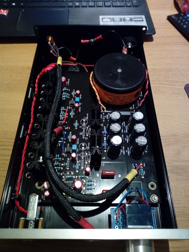

I can see many use a 3 wire cable from PCB RCA out to RCA connectors. I think it could give crosstalk and also no good to let the cable pass close to the trafo/PSU. I am thinking of let the long side be the front so there is short distance to RCA connectors.
I loved to have short distance between the RCA inputs and the audio in, but then the potentiometer would have ended with long cable so to the front. I decided that was the "greater evil" of the two and went with the standard orientation but moved the RCA inputs to the opposite corner as the trafo.

Yes, pot must be mounted on long side of chassis so wires will be a bit longer compared to direct PCB mount….unless you are happy with pot out of the side of the chassis 🙂
But at least twist of L and R channel input should be avoided and away from the power transformer.

If we look at the official Pass Lab headphone amp we see very short distance from RCA in/out and a flat cable from pot to PCB but long away from power transformer:

Sounds good…..but I think I will try to do it as "theoretical" good as possible with short signal wires etc. and maybe also mu-metal shielding of the kit-trafo…..because I have mu-metal sheets I used for M2X Edcor trafo.
