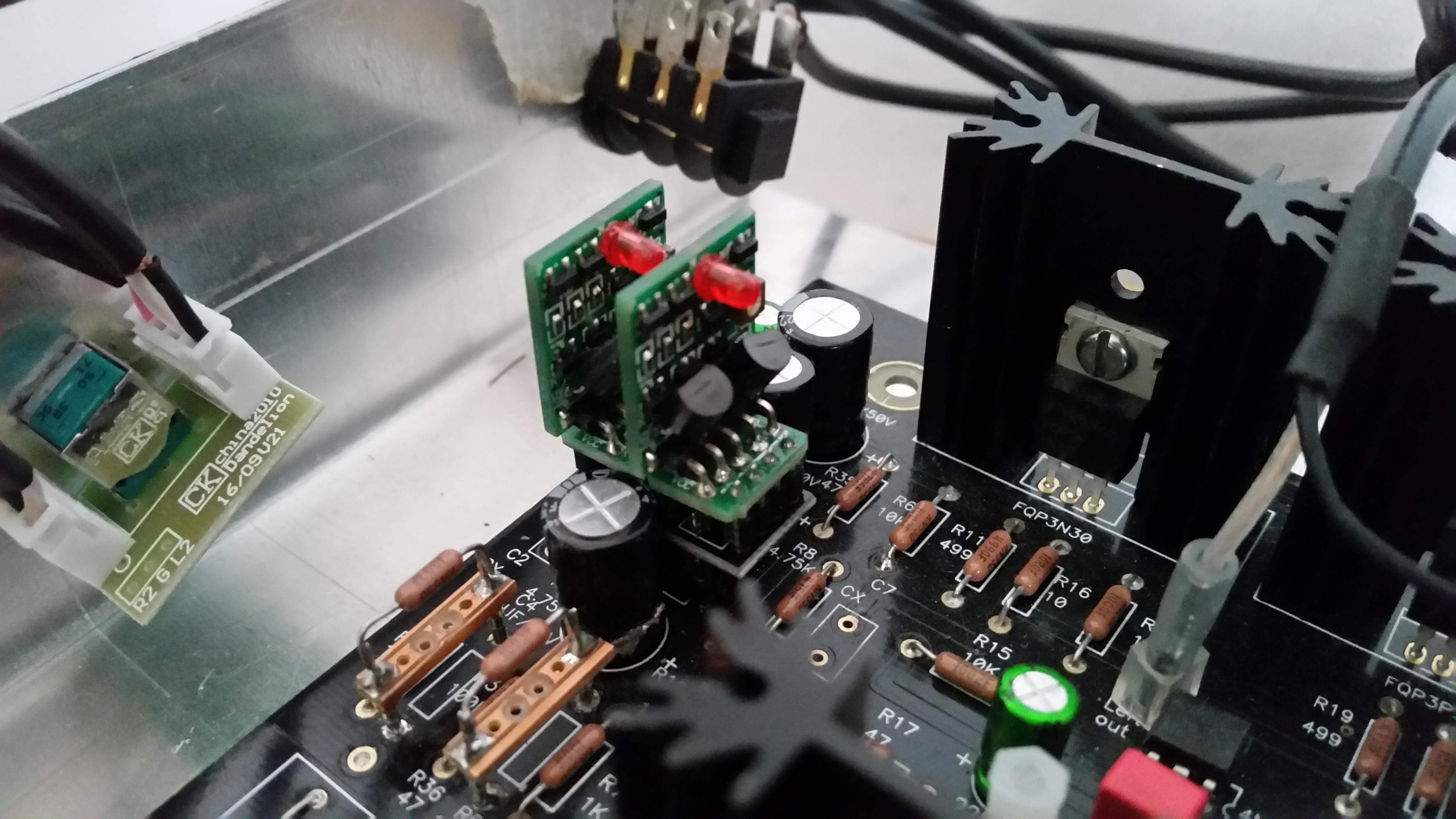

Many thanks to both avdesignguru and AudioSan for helping me with the blue LED installation!
Zapped
Zapped
emacs - Remove the feedback capacitors C7 C2.
And make sure all panels of chassis are touching each other through bare metal, but it looks like you may have done that already. 🙂
Thx your reminder.

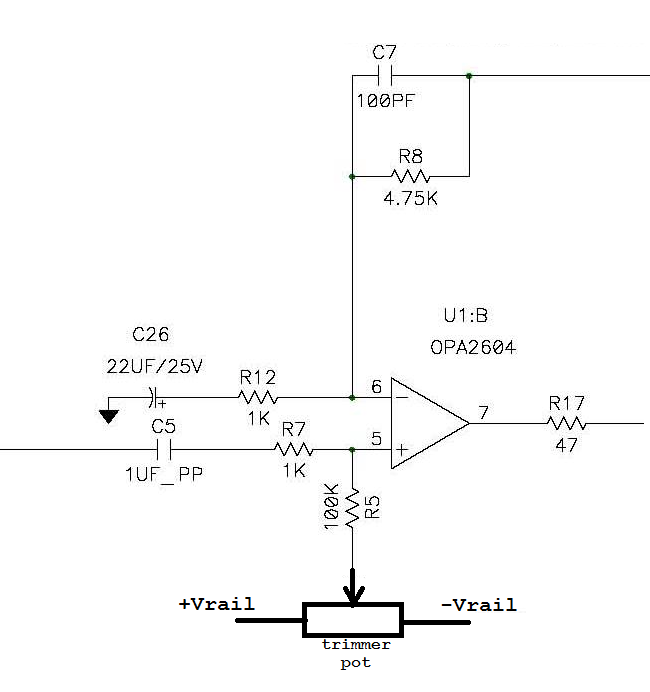

Maybe you could disconnect the input bias resistors from ground (zero millivolts) and instead connect them to ((-1) x OffsetVoltage) millivolts. Two wrongs make a right and presto the offset is nullified.
Your circuit designer will probably want to add noise-elimination capacitors and range-limiting resistors / diodes and so forth, to go from the "here's an idea" drawing below, to a finished schematic.
What nobody knows is: does the offset vary with time ("drift") ?? If so then a fixed offset cancellation scheme is doomed, and you need an adaptive offset canceller (active circuit) instead. Or else an output coupling capacitor 🙂 or an output transformer 😛

mod_sonic - do you have any offset with a normal opamp?
Also, 21millivolts across 32ohm is a breathtaking 0.000013W of additional DC current that the voice coil needs to dissipate. If you have say, 300ohm cans then it's 0.0000014W
I'd put that squarely into the "who cares" column and instead listen to music.

Yes I've done the V^2/R calc too and I totally agree with you it's 2/5 of not a lot 🙂, which is why I have been listening to it for a while with no worries. However, out of interest, and in the pointless pursuit of perfection, I wondered if there was some simple way of zeroing the offset. Mark Johnson has suggested something I will take a look at.

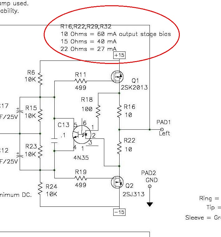

I think you'll be pleasantly surprised if you experiment with different bias currents in the WHAMMY output stage, assuming your output transistors are adequately heatsinked.
I don't know whether the schematic in post #2 of this thread is current and up-to-date, but it does mention the idea:

Hi Rafa, sorry your dad's been ill (but happy to hear he's doing better.)
I have an old pair of Grados at home somewhere so when I built my
Whammy, I used 60mA bias. I don't view it as experimentation at
all, given Wayne included this info on the schematics, but rather as an option
of the design. Since you're using Sennheisers you should be fine with
a lower current setting.

Have you checked which resistor values you used for your build? ….maybe it is 10 ohm ("high" bias)? ….I guess no fun to reduce bias...
It is about 1W in each output transistor if about 15V over each of the transistors. A normal "clip-on/screw on" heatsink should be able to handle that.

... I tried some different OpAmps: An Analog Devices AD823ANZ which is the most expensive part of my BOM and I didn't quite like how 'raspy' it is. I tried a Ti LM833 which, at 1/10th of the cost sounds much better. Then I placed a Ti OPA2134PA which sounds just fantastic! The best of the three. Stupidly, I have not yet tried the RC4580 which came with the parts KIT and is specifically listed as best for 'headphone amplifiers'. So I'll probably take some time today to try that...

I do have the 10 ohm resistors there, which is what comes with the KIT. So yeah, I would not go with higher voltages than that. I'm OK with 60mA.
