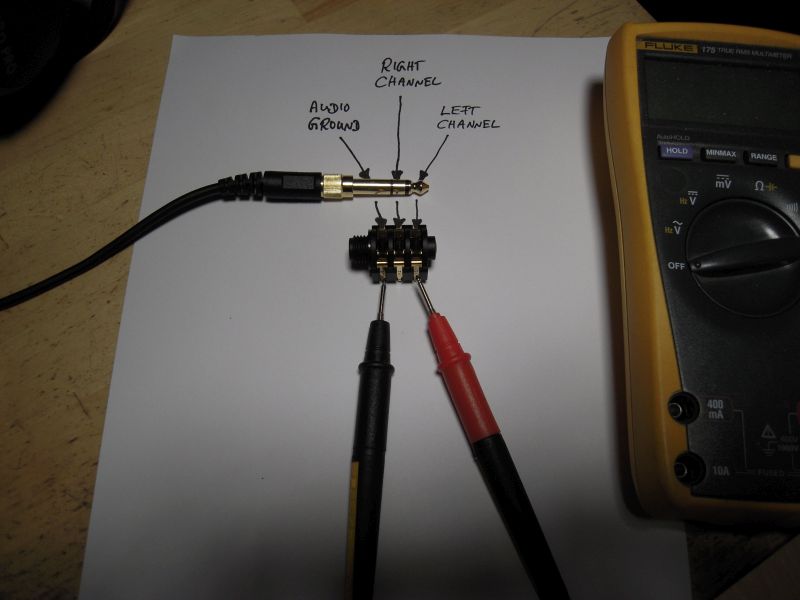

Can someone tell me how to measure the DC offsets? I'd like to try some high end op-amps and see if it's compatible with the Whammy.
DC offset:
measure at output from
+ (right channel) to ground = offset right channel
+ (left channel) to ground = offset left channel
Nothing connected to your inputs! Some shorten the inputs to measure DC offset.
Your measurements with the DMM should be in the low mV range.
My Whammy was never above 20mV at the output. I tested a lot of OPAmps.

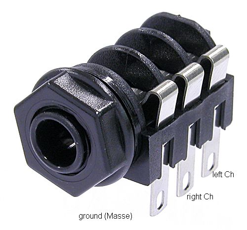

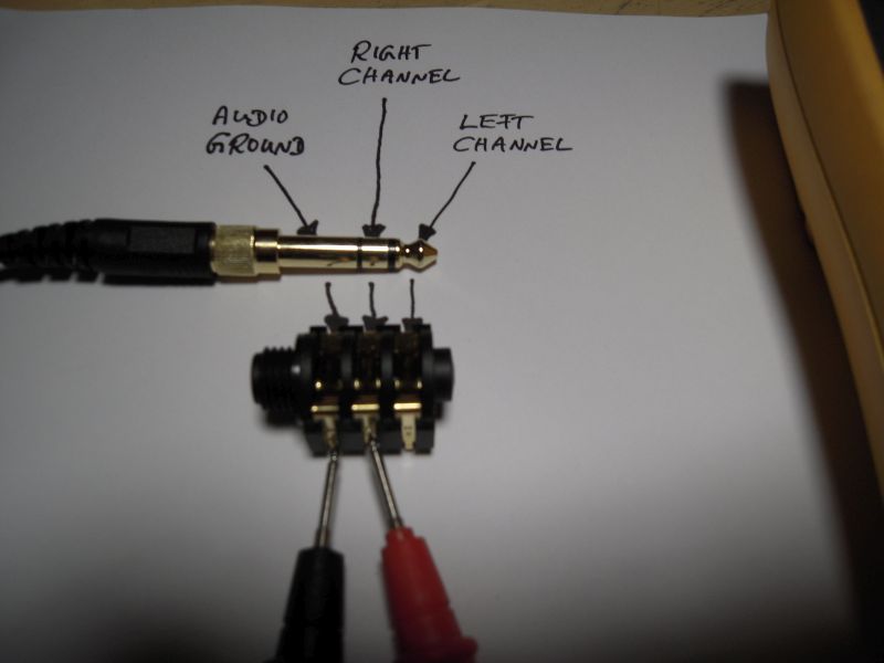

How to measure DC offset at output of Whammy
Hello members / Whammy - builders,
the following pictures show where at the Headphone - output - jack you can measure your DC offset.
No source (CD-player, Computer, Cellphone or whatever can send music into
your WHAMMY) is connected.
NO headphone is connected to the WHAMMY.
Give the Whammy a short warm up time that the auto bias can adjust.
The pictures show a very common NEUTRIK headphonejack with open contacts.
And above the corresponding headphone plug.
I hope this helps a few members.
If I made a mistake - please let me know.
Greets
Dirk

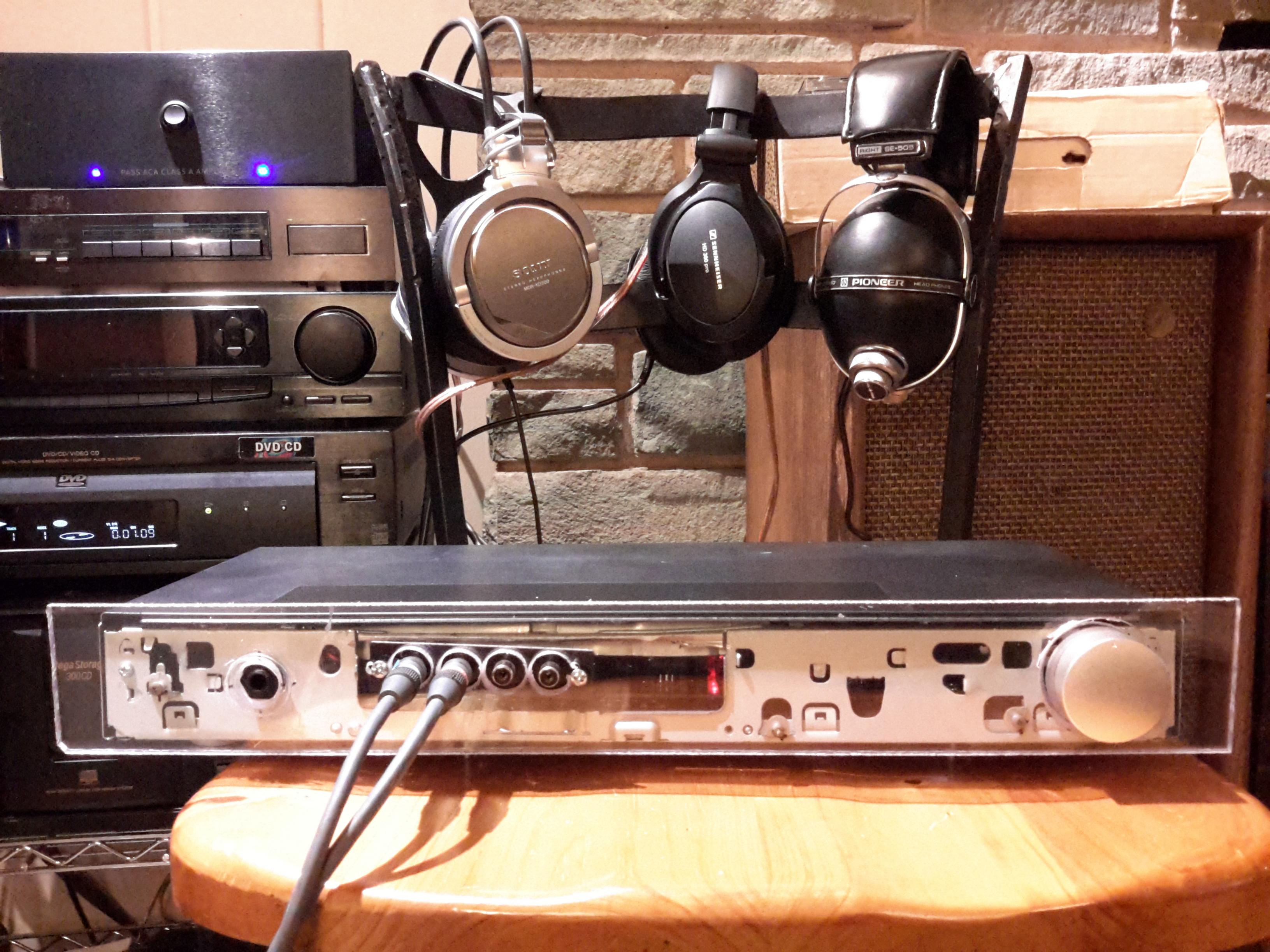

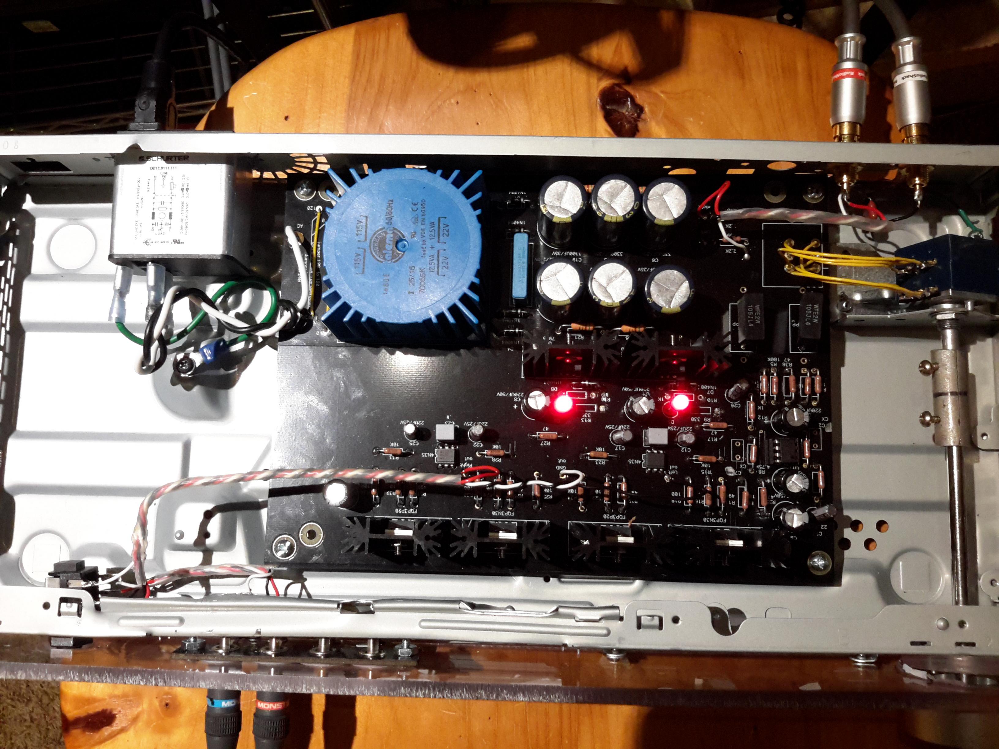

Well, here she is all wired up in the Franken-chassis.
Had to do a little hammering, cutting, bending. A bit more hacking, jacking and riveting but it all fits up and it is playing.
Couple little issues, need to look into the input RCA Jacks as the will occasionally create some hum if bumped or not positioned perfectly. Also there was a little spark when I put the cover on the first time with power. I am thinking grounding is not right or as good between chassis pannels as it should be. Nothing major I believe, i was planning on not messing with it for now and wait for the DIY STORE chassis kit release before fiddling with it any more.
But with the inputs fixed and the cover off it works like a charm.
I listen to CDs with a old Sony DVP-S7000 as the source into the Whammy and it is feeding my ACA to push a pair of vintage Electro-Voice esquire speakers.
Dead silent, and great sound. Starts to distort a tiny bit at the top of the dial. I assume this is because it is a little on the higher side of the gain output? I dont have that issue with another preamp I have but it is not as loud or rich sounding. I think my other pre is passive, (Kenwood KC-993).
So, as of now it has about 100 hours of burn in time and I am just sitting back and enjoying the great sound that is coming out of some things I built myself.🍻
