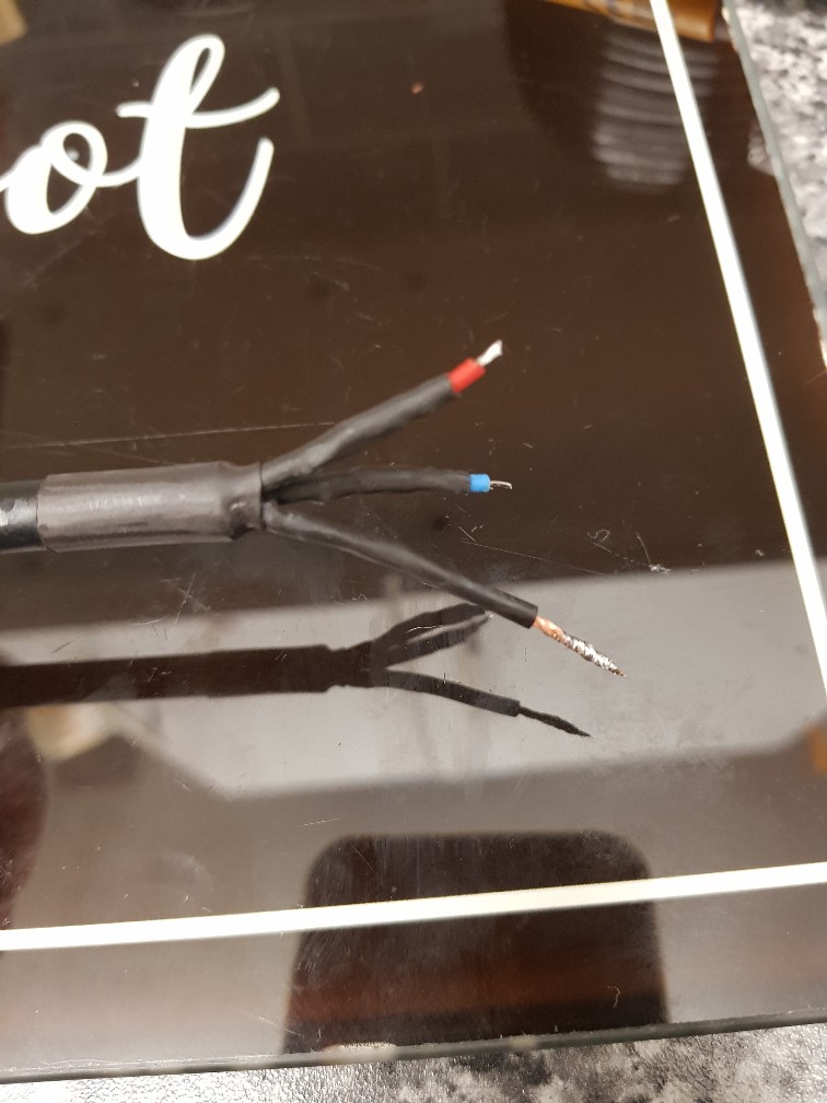

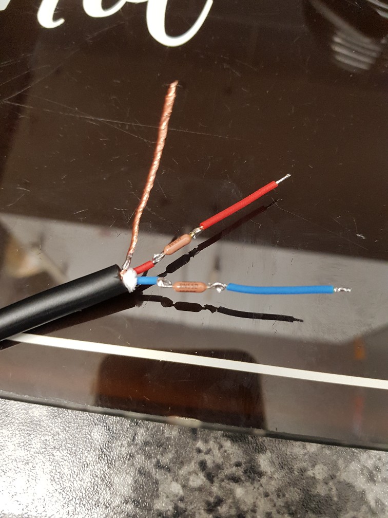

Where did you add the 100 Ohm resistors for the line out?
Thank you, I simply ran the cabling from the switched contacts of the headphone amp and connected the ground to ground and attached a 100 ohm resistor to the left and right in series so the other end of the resistor would be connected to the RCA centre pin as the left and right are positive. 150 ohm would also work as I've seen that value on some other amps.

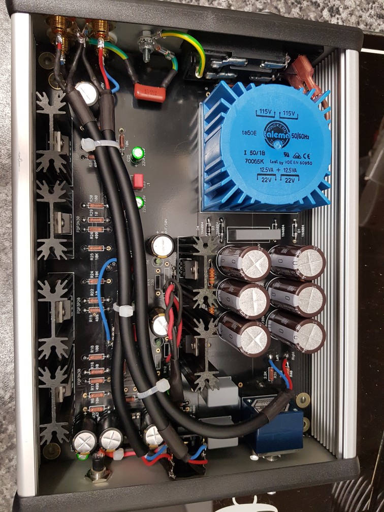

I took the time this evening to upgrade the wiring to some tour grade Van Damme microphone cable and took a few pics including where to put the 100 ohm resistors for the pre out in case anyone wants to do the same.

Great work Gaz..
Thank you for the pictures and information.
