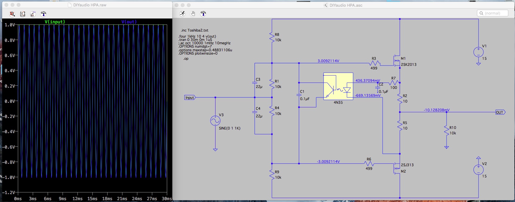

The four 10k resistors are there to set the maximum DC bias voltage available to the gates of the mosfets. The optocoupler then reduces the bias voltage as needed.
The capacitors allow the AC signal to get to the gates and make music.
And the signal will have to fight the 10k resistor. Hopefully Wayne will jump in and explain it better... 😀
I thought this combo of 10k and caps is used to have the output stage swing near the rails voltage.

But in a spice model the output stage run without these caps.
Yes it will run without these. It provides a lower impedance to drive the outputs and shorts potential noise from the optocouplers.
The middle two 10K resistors can also be dropped down to 2.2K if you want. The four resistor combination set some basic DC to keep the smoke in even without the opamp.The published schematic is just what I built and worked at the time.
True for 2SK2013 / 2SJ313, or BJTs.
But also for IRF's or FQP's (Vgs closer to 5V) ?

Probably borderline for the IRF parts and 2.2K Patrick you might have to select. The Toshiba parts are so consistent I wish they still made them.
I would suggest 5.1k for FQPs and IRFs.

Without caps Spice says the output is only half of the input, maybe understandable, because without caps you have a resistor divider 10k series and after that 10k to rail (means GRD)
And with caps the series resistor is bypassed.

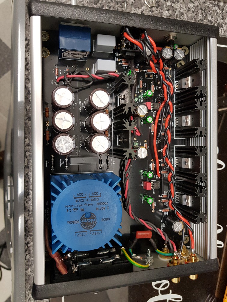

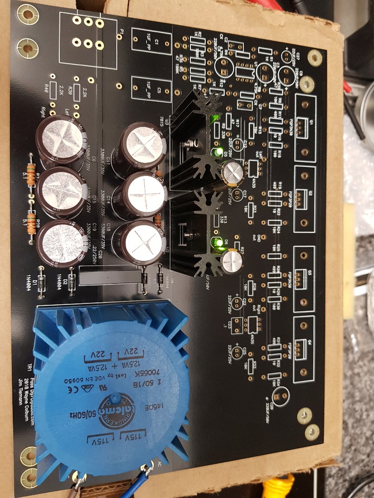

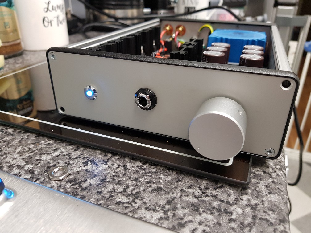

I finally got my board and I have been busy these last few evenings assembling everything.
I chose the OPA2134 op amp and I used a 50k alps pot and after testing, it's perfect, no gums, no hiss or buzz, everything is dead silent with no audio connected and also same with RCA cables connected and no audio playing.

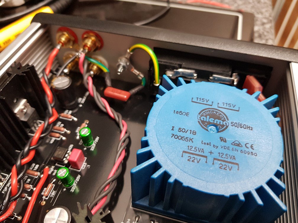

I also added a line out for future use making use of the switched headphone jack and adding 100 ohm resistors to the cable run.

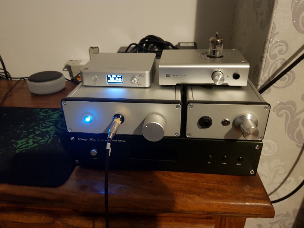

Music is crisp and to test further I listened to Evanescence Synthesis album and the sound stage is incredible. Will definitely be building another solid state amp that's for sure. Really pleased with this build. 🙂

Looks great.
Where did you add the 100 Ohm resistors for the line out?
