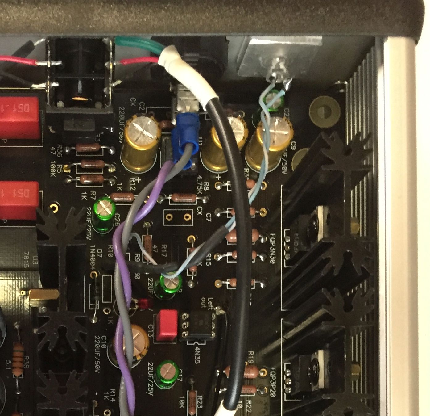

Hello...I just finished building my Whammy and it was working and sounding great, and was super fun to build. The last step I had was to try and add a front panel LED.
However while trying to test my LED, I accidentally shorted the anode of D4 to the cathode of C28. The connection was very brief but there was a whiff of smoke from what looked like U2 7915 (or at least that area). The D6 LED sputtered and turned off. My voltage test between R13 and R14 had been -16.9, now it's -32.
*sigh* what have I done? Do I just need to replace U2? rebuild the PSU? Please help! I think the worst feeling in DIY is to have a finished, beautiful project, then f*** it up for no good reason.

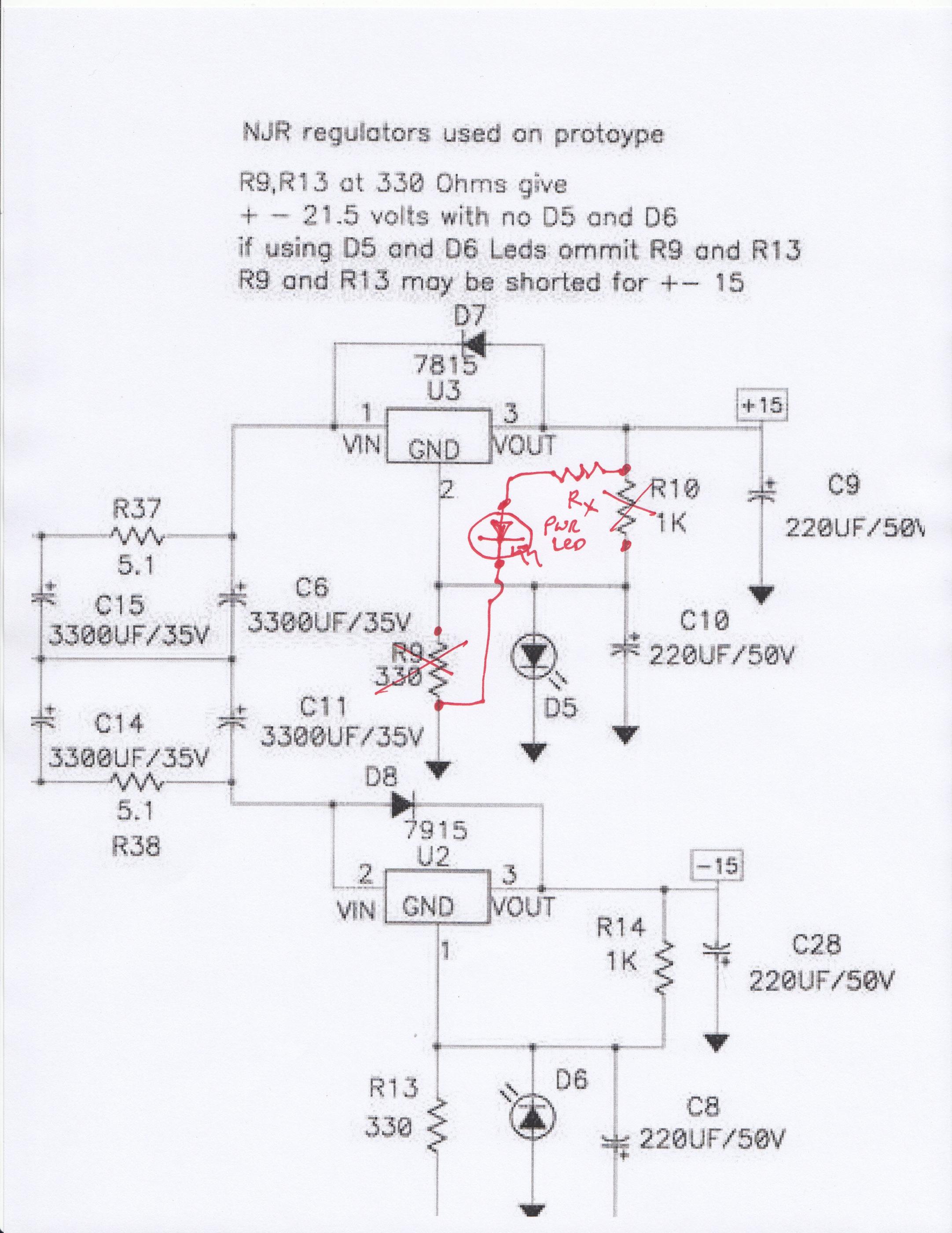

Note: the following is based on using LED referencing of the regulators, where you do not stuff or solder resistors R9 and R10 on the PCB.
Solder one end of your LED dropping resistor into the +15 end of the unused position for component R10 (the end towards the front of the PCB). Air wire the free end of the resistor to the anode of the "Power On" LED.
Connect the cathode of the "Power On" LED to the unused grounded side of the component position for component R9 (again, the end towards the front of the PCB).

Trying to puzzle this out a little further, based on my limited knowledge. I apparently fried the regulator of the negative rail. Does that mean components downstream were potentially exposed to more power than they are rated for, potentially frying them as well? Or does the LED act as a sacrificial diode, so when it got overloaded and died, power did not pass beyond the PSU?
I'm planning an order from Mouser for another regulator and hoping to get that out ASAP...I'm hoping I didn't fry any MOSFETs or anything else too..

If D6 is dead (open circuit), or installed backwards, there will be no regulation reference and the output of U2 will go to the full raw supply voltage. It's pretty hard to kill U2. My guess is D6 is fried.

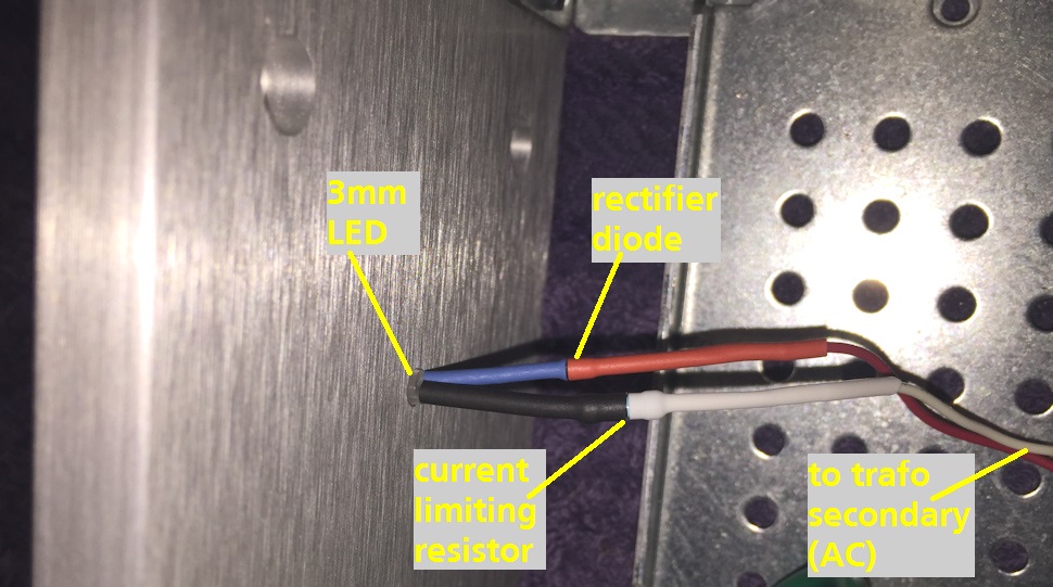

In one of my recent builds I decided I wanted a power indicator LED that stopped glowing the very instant I turned off the power switch. The DC supply rails don't bleed down to zero for many seconds, so I couldn't connect my "pilot light" there; it would remain ON for a long time after the power was switched OFF.
I connected it to the transformer secondary (AC voltage) because that DOES instantly drop to zero when the mains power is switched off. A series diode was installed to prevent the LED from entering reverse breakdown. The diode means I'm applying half wave rectified pulses to the LED, and relying upon persistence of vision to give the perception that this 60 Hertz flickering LED, appears to emit a continuous unchanging beam of light.
The rectifier diode is a 1N3595 because I've got a drawer full of them; they are small and have very low reverse leakage current, so the LED is very well protected. Probably a 1N4148 would have worked well enough. The LED is a wide viewing angle (112 deg) blue diode whose brightness rating is pretty high: 5000 mcd. So I'm running it at about 1 milliamp of RMS current.

The U2 regulator is only 56 cents, so I'll order one just in case along with new LEDs. Just so I'm clear, if U2 is outputting the full raw supply voltage, does that endanger any other components, or no?
Theoretically, if you have exceeded rated voltages, yes. In practicality, if you did not apply a headphone load to the circuit and drive a signal through it, probably no damage was done. Maybe the opamp if it was installed. The optocouplers and mosfets are pretty tough.
There was no source connected but the headphones may have been plugged in, I don't recall honestly. The opamp was installed but it wasn't my favorite and I've got others. Hopefully the damage is limited to the LED or U2.

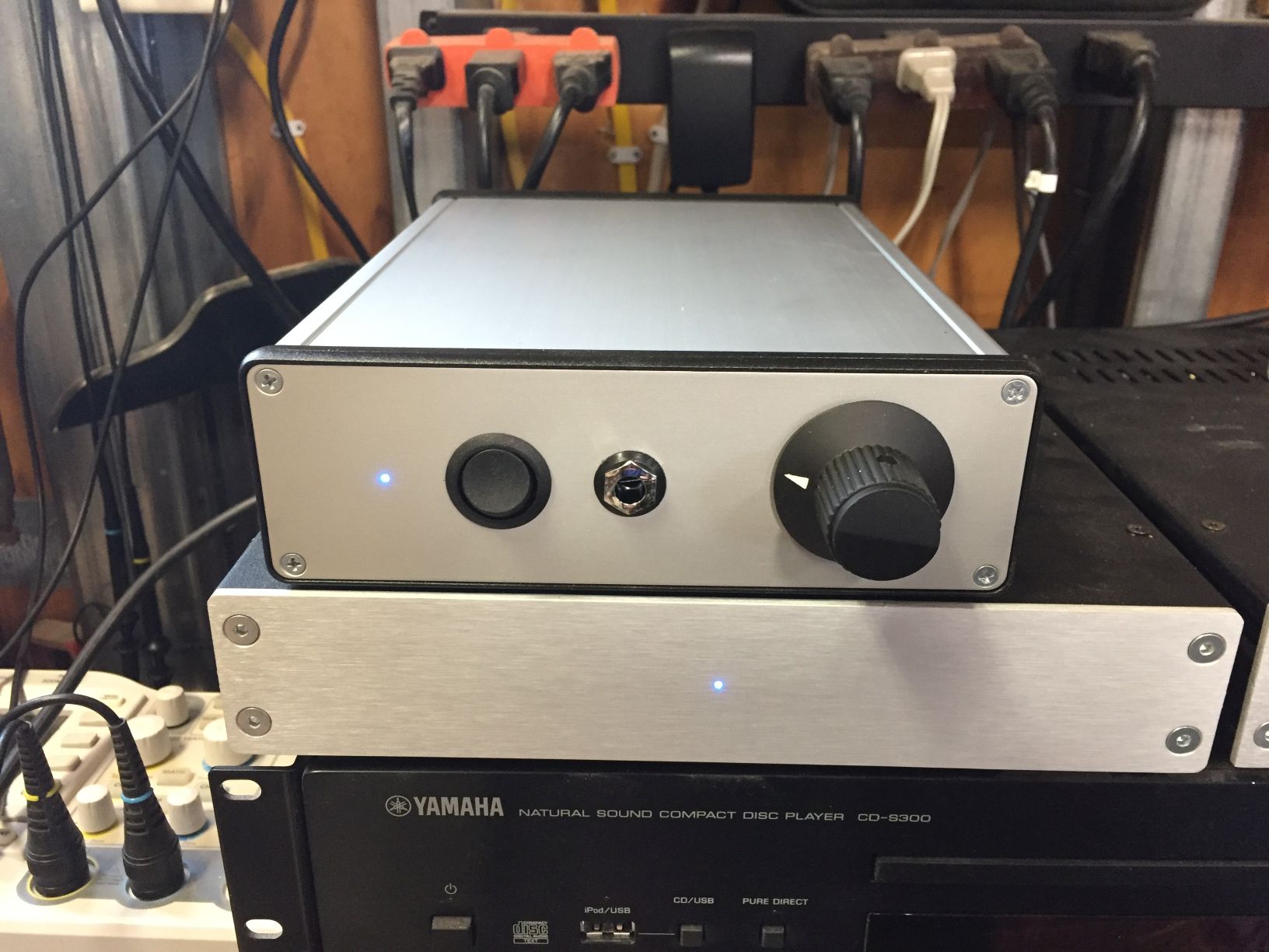

Sometimes you gotta overnight parts from Mouser, and this was one such occasion. I replaced the regulator and LED in my Whammy, and voila, everything's working including the opamp. I also utilized Mark Johnson's front panel LED suggestion directly from the secondary (using a 1N4148) and it works like a charm. All is good, thanks Wayne for the amp, and everyone for their prompt assistance!
