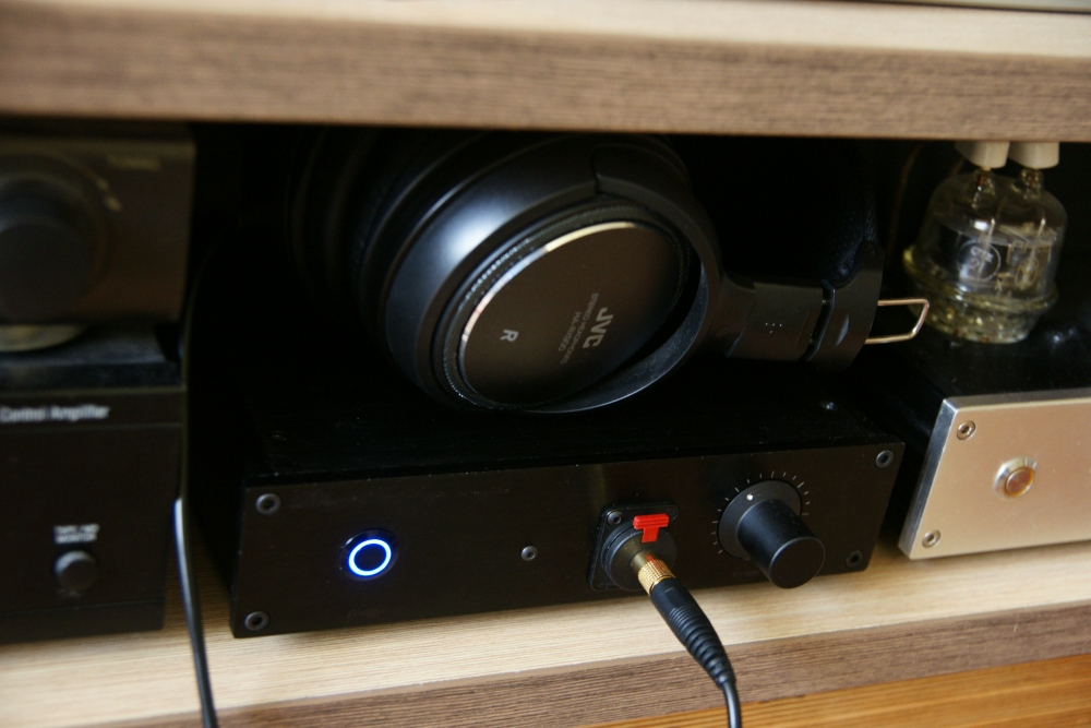

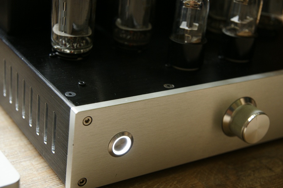

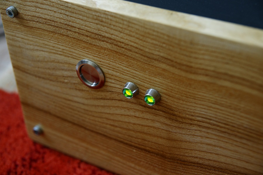

I've used this $9.00 19mm diameter Chinese switch successfully:
https://amazon.com/gp/product/B07931ZKC1/ref=ppx_yo_dt_b_search_asin_title?ie=UTF8&psc=1
It has a 250VAC/5A main contacts rating. Just add additional external resistance to the LED portion as needed.
Name brand manufacturers (E-Switch, TE, etc.) start at around $14.00. The original Bulgin switches, the ones everyone copied, are about $22.00 and up.
You could always add a relay for the mains and still be well under the Bulgin price.

Yes its nice switch 19mm ( i use them with LED and versions without LED) - its possible to get it cheaper without socket imho.

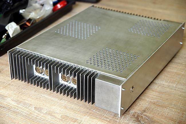

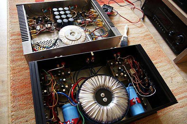

Nice builds. Are your Leach amps the Marshall Leach Low TIM amplifier? I built several back in the mid-1970s and they pretty much outperformed everything at the time.
I don't want to hijack the topic.. but yes - true classic low tim 4.5 ....
but Whammy is very good too ( my younger son uses it and has already learned to solder himself)..

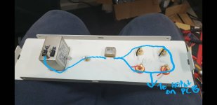

Okay guys I am hoping someone can shed some light, as you can see in previous posts with the amount of OP Amps I have tested I have had some mainly the ones on DIP adapters that have had quite a high DC offset. Would it be possible to replace the R3 and R5 resistors for trimpots to zero any negative or positive offset or is there another way or am I completely looking at this wrong?

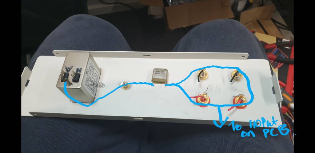

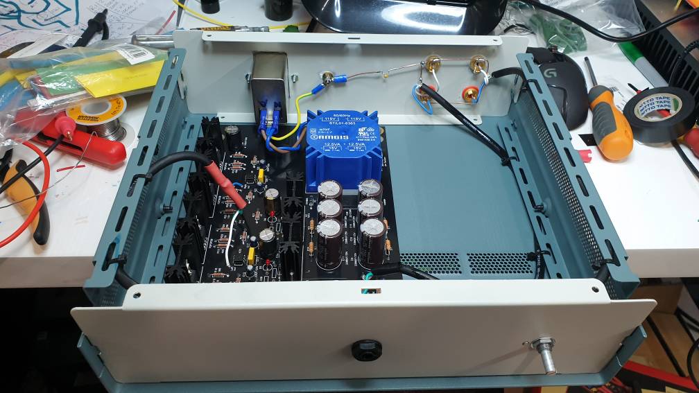

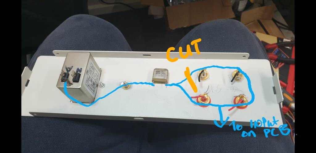

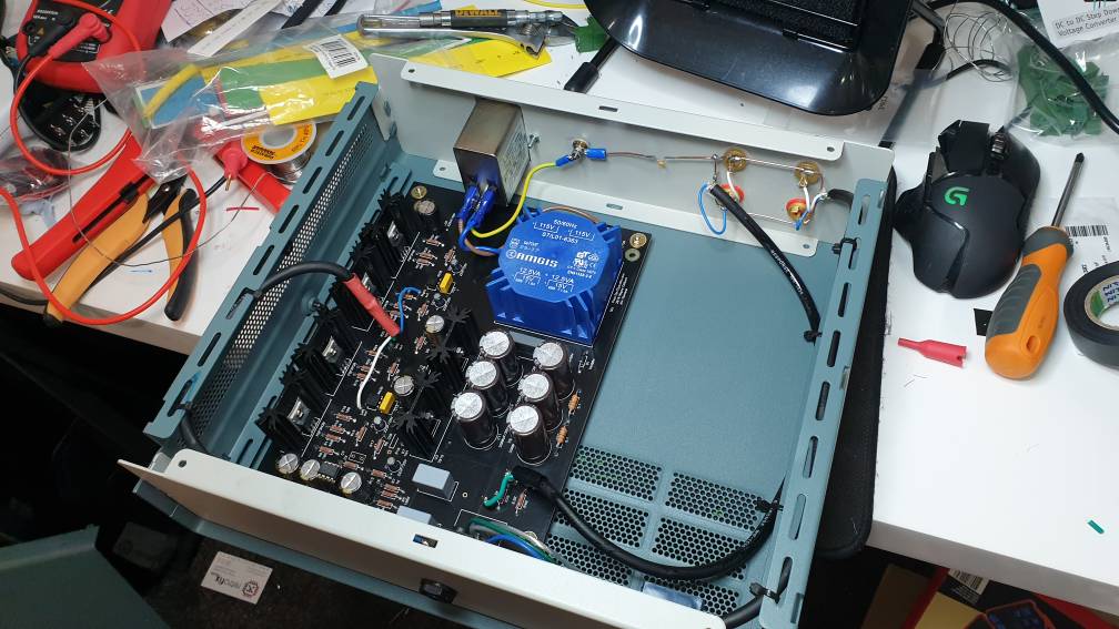

Should I have a ground cap for both input and output RCA to ground or just one for all of them. View attachment 775967
I have a global ground for the input and output connected to a cap so it should be fine.

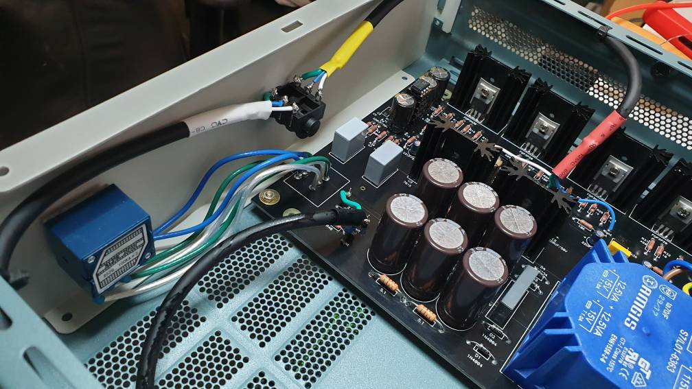

Yeah just had a friend offline say the same. He said I should star ground them all in the middle of them with a 1nf 100v kemet ceramic cap each. Just tested it and sounds pretty damn good. Can't hear any hum till I turn the amp to unlistenable levels. But that's not the point will surely improve with like you said. Will let you know how it goes! ThanksHello HatlessChimp,
I would cut the loop around your RCAs (possible ground loop). Will not necessarily be bad as you did.
I marked the pic where I would cut / break.
Greets
Dirk

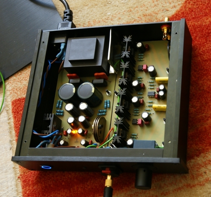

I often use these switches - I've never had a problem. But someone told me about an internal short circuit when mains burns PSU through led wires...
Good layout.
Clear separation of power circuit and small signal circuit.
Including placement of pot, output socket and power switch.
Examplary. 👍
