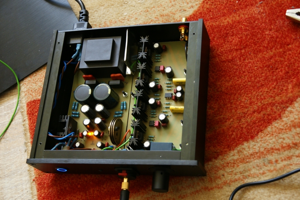

I have a whammy with Toshiba and another with Fairchild (and I've built one with IRF...) and there's no difference in bass.
It's (the whammy) a very neutral design that doesn't editorialize at all. Changing opamps won't make much difference either. If you want more bass, I'd honestly grab a different set of headphones, or (more fun) put a Schiit Loki in front of it and EQ to your taste.![]()

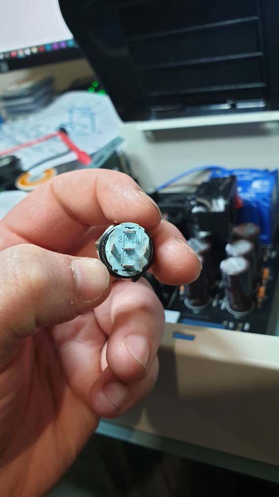

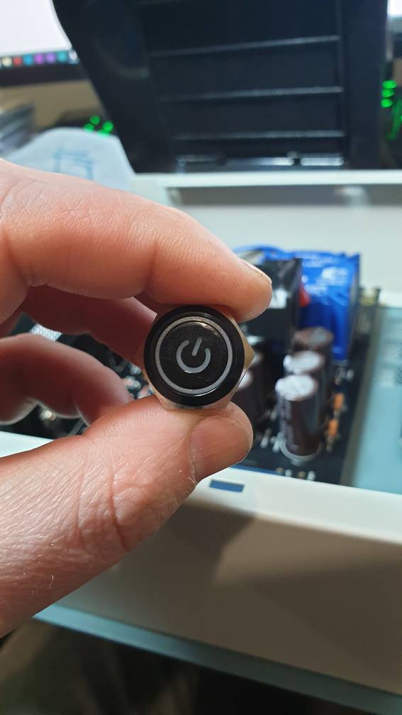

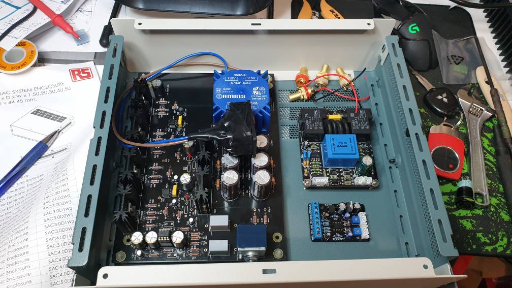

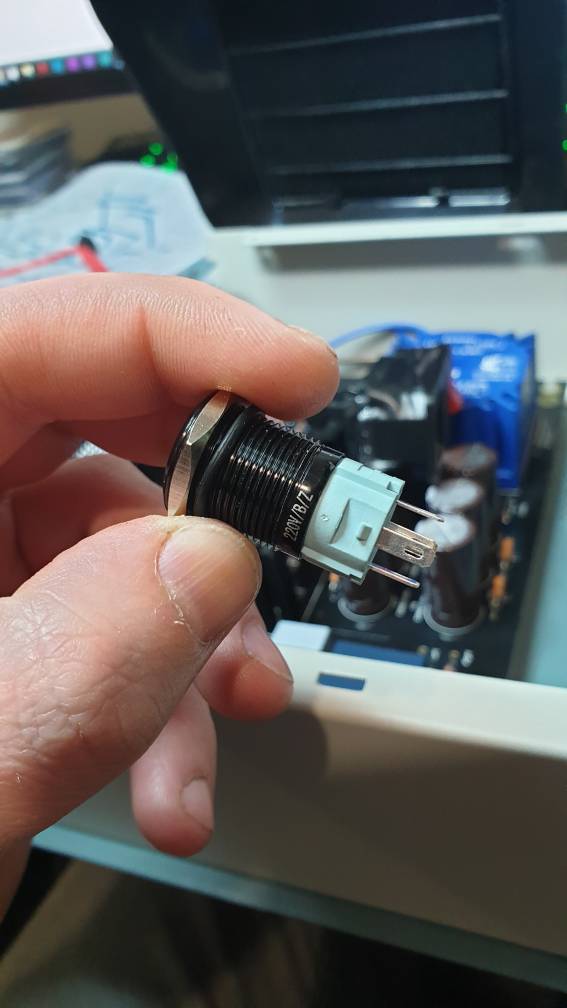

Do you think using a soft start with the whammy is a bit excessive? I have one of those push button switches from Aliexpress but not sure if I want to use it to switch 240VAC.View attachment 775579View attachment 775580View attachment 775581View attachment 775582
Just a word of caution, I used one of those switches for my NAP200 build and after about 2 years it shorted and wouldn't switch off. Nothing bad came of it, just that I can't switch it off.
In retrospect it seems quite dangerous that something so cheap is tasked to handle mains voltage. Don't know how on earth they stepped it down to 12V (probably) for the LED in the switch too.
I'm thinking about using it on another project instead.Just a word of caution, I used one of those switches for my NAP200 build and after about 2 years it shorted and wouldn't switch off. Nothing bad came of it, just that I can't switch it off.
These push-button switches ("vandalism-proof switches") are not all created equal.
There are ones that are rated up to 5A at 240V, and that have 12V or 24V input for the LED. They tend to cost around 20 EUR here in Europe. I use them in most of my amp builds. Never had any problems with them so far, after a few years of use.
What I do though, is wiring a small ceramic cap (10 nF - 100nF) across the switch contacts in order to avoid erosion of the contacts through possible switch-off sparks.
I use those switches also. Haven't had any issues.
What chassis are you using? Looks interesting.
