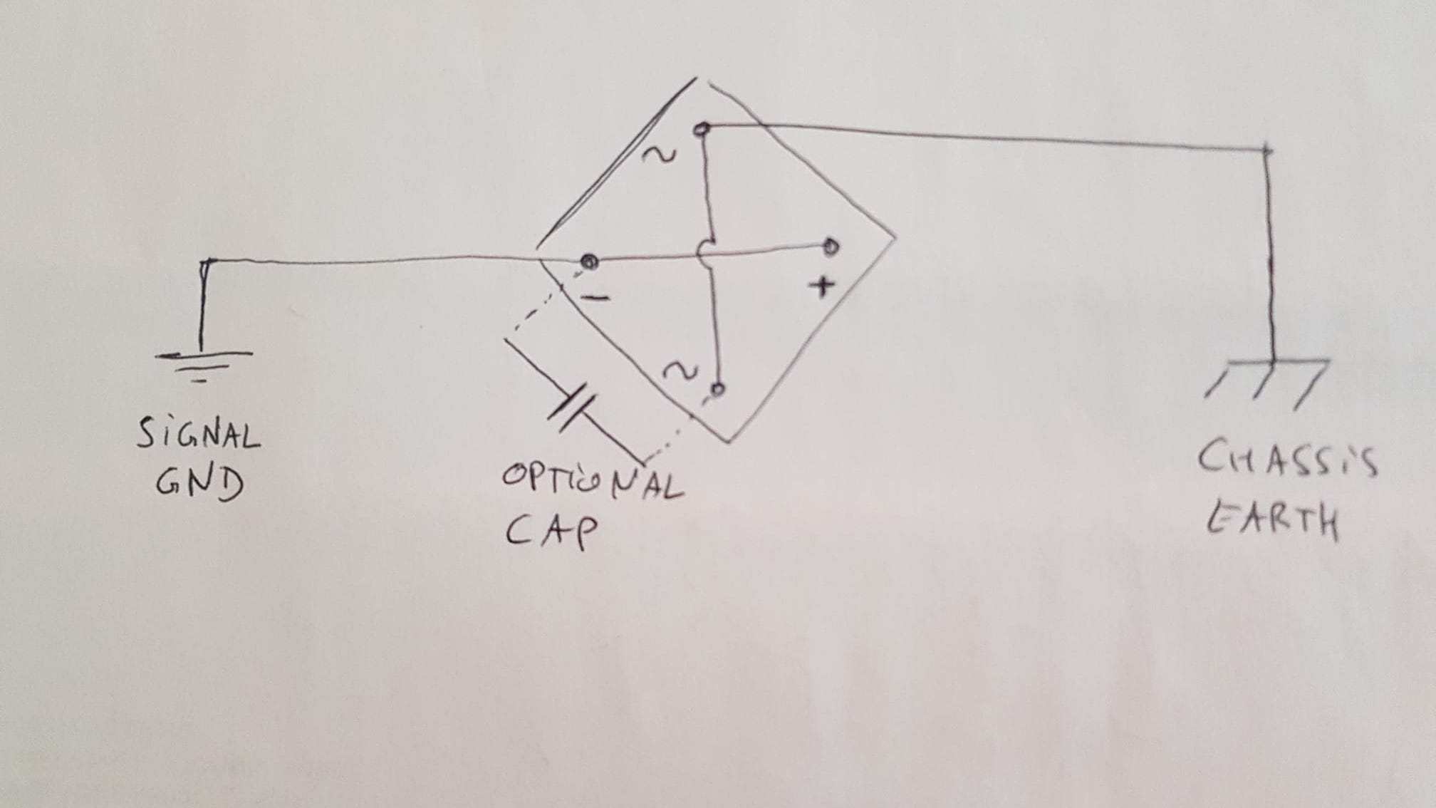

However, for security reasons, I would highly recommend to use a 35A bridge between ground and earth and using the cap on top of that (see my build above). It will enable several amps to flow between ground and earth (enough to trigger your fuse or circuit breaker) in case a device connected to the input fails and high voltage appears on signal ground. This Nelson explains this very well in the Pearl II phono preamp article:
so, long story short: 1) Use another value instead of another construction type; 2) Use a 35A bridge for security purpose as well (it will not interfere with your cap, ad the diodes will block any current below 0.7V voltage difference between signal ground and earth.

Thanks! BUT, I am a slow learner here. In your drawing:
- Signal Ground - is the ground (or common) from the RCA inputs?
- Chassis Earth - is the the connection to the chassis or the earth wire from the main power inlet?
- Do I ground the metal body of the bridge to the chassis?
"Chassis Earth - is the the connection to the chassis or the earth wire from the main power inlet?" - to the chassis and the protective earth wire, so to both 🙂

You connect the mains earth from your power outlet to the chassis.... so it's both. You'll also see this called safety earth sometimes. It is vital that you do this.
You're not really grounding it. The metal plate is to help carry some heat. It doesn't electrically connect anywhere.

Do I connect the signal ground to both the Neg and Pos positions and the earth to both the other ports?

Signal Ground - is the ground (or common) from the RCA inputs? => yes, which is also connected to the ground of the "phones" output.
Chassis Earth - is the connection to the chassis or the earth wire from the main power inlet? As SomekPoland wrote, it is attached to both, and that's the point: the enclosure of the device must be linked to earth, so that if any voltage appears here for whatever reason, the current can flow UNHINDERED into earth instead as flowing through your body if you touch the case. The easiest is run a (heavy!) wire directly from the IEC plug to the chassis using a ring terminal that fits under one of the screws that holds the chassis panels together. And from that screw you run another (heavy) wire to the bridge rectifier as in my drawing.
Do I ground the metal body of the bridge to the chassis? You can, but there's absolutely no point of doing so (not even a tiny bit). The metal body of the rectifier is isolated from the 4 terminals ( AC, AC, +,-). Its sole purpose is for heat transfer. Remember that it is rated at 35Amps, designed to operate at such high currents constantly (24/24 7/7)! In such an application, the bridge needs adequate, massive heatsinks to dissipate the energy from the diode losses. In our case however, we use a 35A bridge only to make sure the bridge won't break before your house's AC mains circuit breaker triggers. It will be a very short surge, and the bridge won't get any warmer, not even a hundredth of a degree. And the most probable case is that this situation will never happen anyway if the amp and the devices connected to it are built properly. It's just a security device, what will propably never be used.
both AC terminals are connected together and go to chassis ground (the connection between both terminals must have the same wire gauge as the rest of the cable! Pos and Neg are connected together and go to signal ground (same wire gauge).
then, you connect your red cap between one of the AC terminals and one of the DC terminals (Pos or Neg, it doesn't matter since there are interconnected thanks to your wire).
Don't hesitate do post a pic here once you have done it so we can validate your wiring if you're not sure. This is a potentially life-saving circuit that must be done the right way.

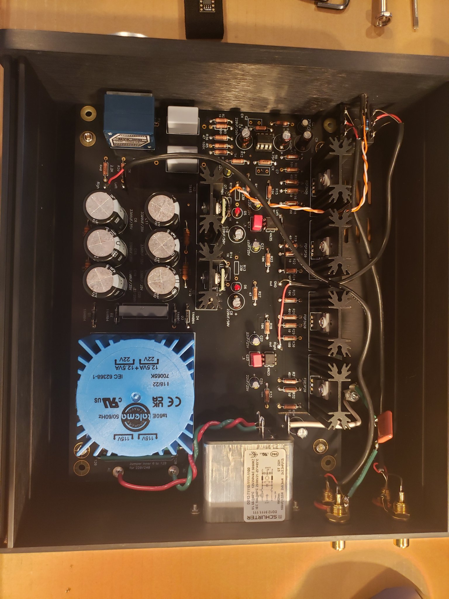

Hello guys. I am getting a squealing noise when I turn the Whammy off. It's very bad and loud (more like a shrieking sound) with OPA627, but it makes a very quiet squeal with LM833N op amp. I've attached a picture of my build. I have a blue LED power indicator light installed. All LED's do not turn off right away when I turn the Whammy off, wondering if this has something to do with it.
Hi, when you say you use the OPA627, I hope you did not just put that OPamp in the sicket, but used an adapter for 2 opamps instead?
Because the OPA627 is a single, it can't work if you just plug it in the existing socket instead of the LM933N, which is a dual opamp!
It's absolutely normal that the onboard leds take time to fade out (even at different rates), it is the time it takes for the 6 PSU caps to drain...
