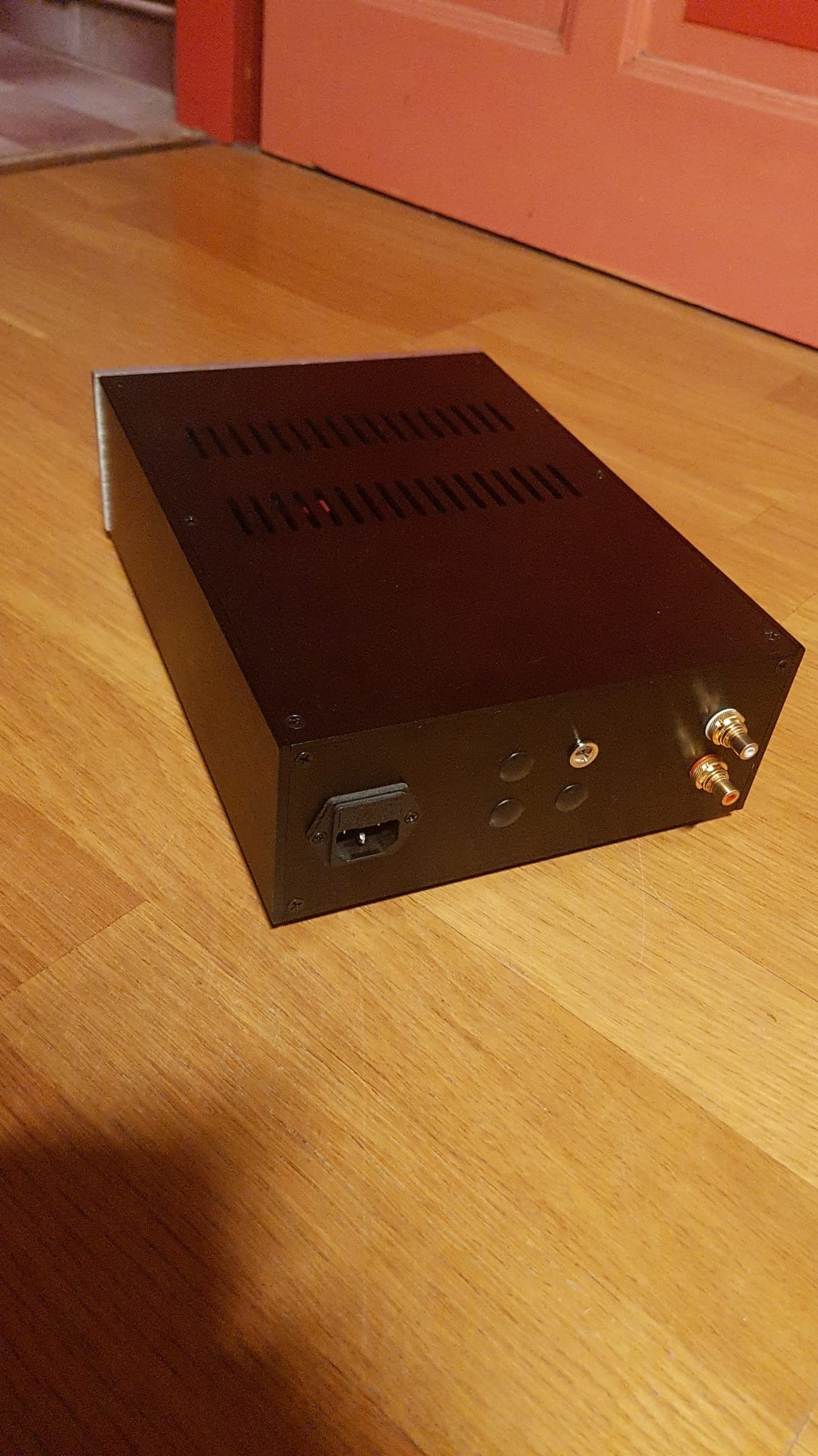

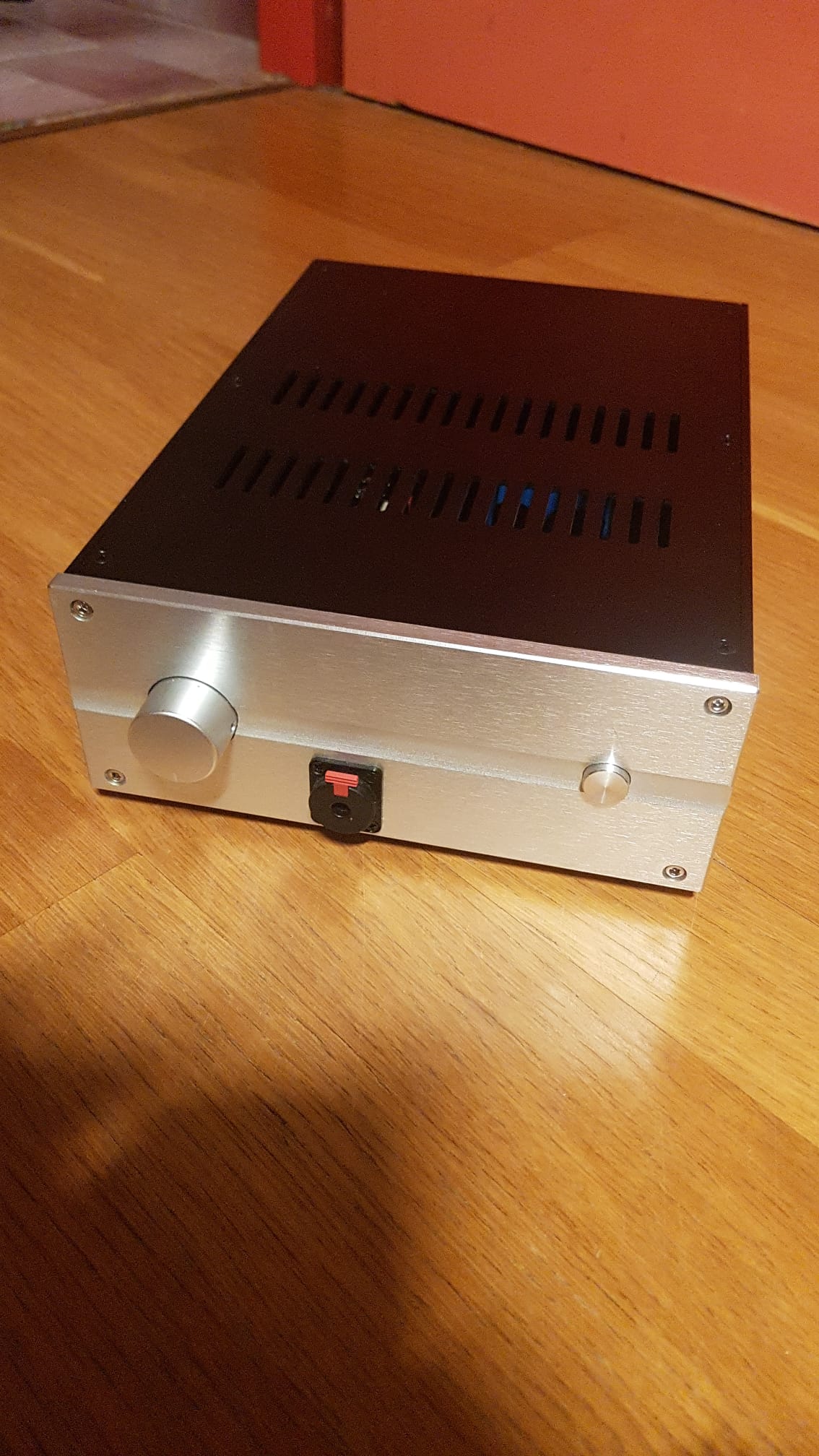

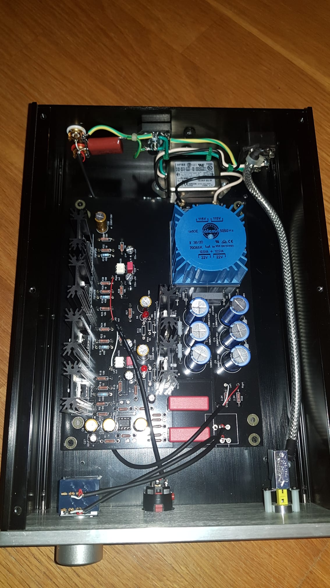

Hi all,
this is my build that I completed a couple weeks ago.
The enclosure is from Aliexpress, really roomy and nice.
regarding the components:
Resistors are Vishay/Dale, Electrolytics mostly Nichicon, film caps are WIMA, pot is Alps blue and connectors Neutrik.
I tried several OPA's (NE5532, OPA2134, LME49720) in different configurations and the winner is...OPA2134 without the 100pf caps (as recommended by Wayne).
Decoupling caps are Nichicon Muse for the moment because I had them in stock, but bipolar UES are already on the list for my next order at Mouser.
I added a EMI filter, it help a lot in my home where my 42HU rack full of IT equipment (3,5kW total) happily pollutes my AC mains...
I followed Nelson's article about grounding basics and kept soignal ground and earth separated by a 35A bridge+cap. It is also the quietest (by far!) when the Whammy is used in more complex setups (e.g. source + DAC + Whammy).
It is an amazing amp (actually, I built 2, one is for my brother). I tried several headphones (AKG k141 monitor, Peerless PMB4, Behringer HPS3000, Sennheiser HD600 and some others). It is just absolutely fantastic, especially with the HD600. Thanks a lot for the design and sharing it, Wayne!
For the moment I run the 10 Ohm resistors for bias (R16/R22/R29/R32), but the amp is running too cool and I like it hot 🙂
I'm thinking of lowering the values to 6,7 or even 4,7 Ohm (I am out of those values - also on the list for the next Mouser order), as some of you guys tried to do so. What are your feedbacks? Is it worth it? Are the Mosfets noticeably happier with more bias?
