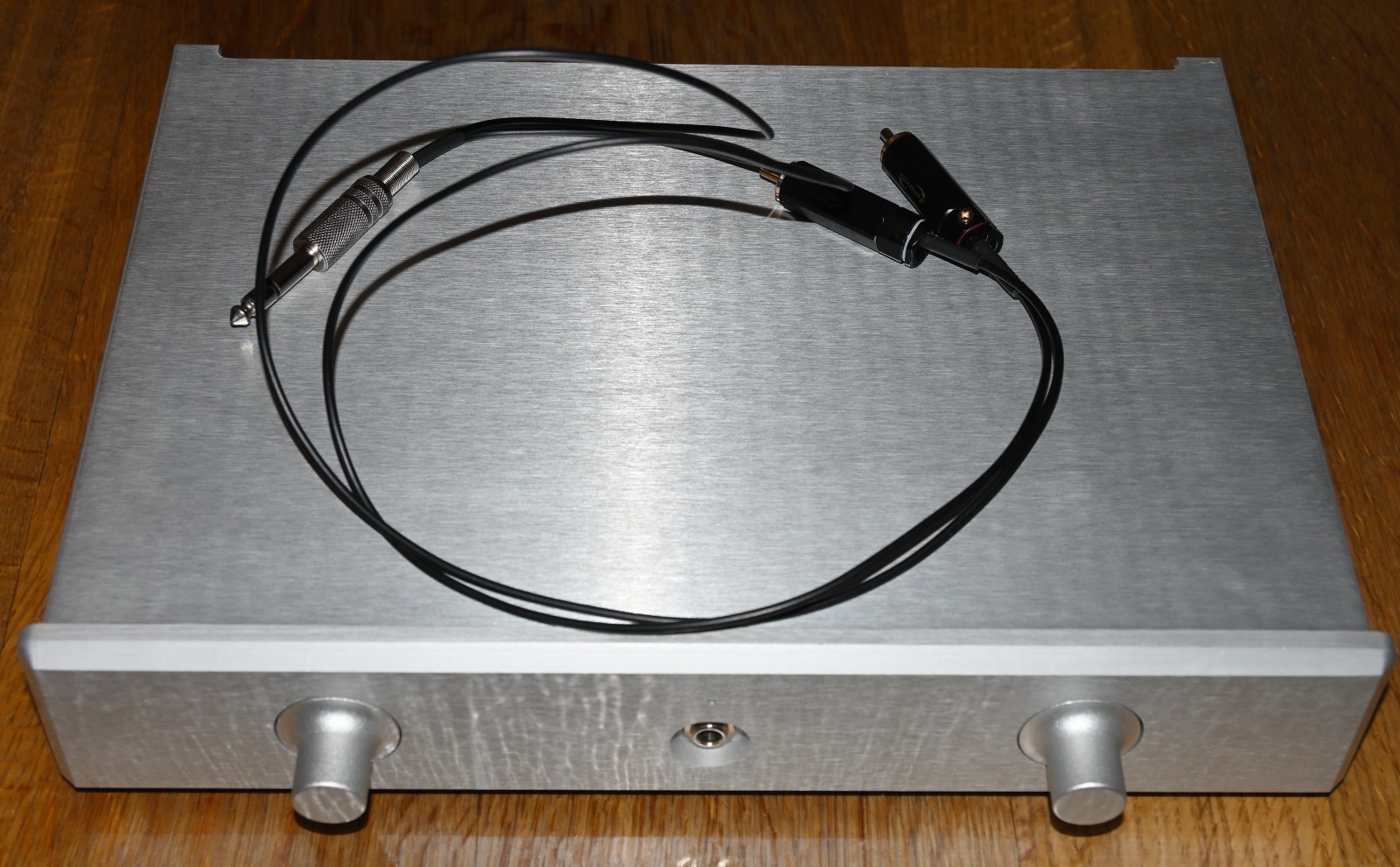

I have a quick question regarding the cable I built when using the Whammy as preamp.
Normally you like to have a 50R resistor to the RCA output. This can make the output more short circuit proof and also it should prevent oscillation in a capacitive load?
Now I made a straight cable long time ago without any 50R resistor. The cable is short as the picture shows but was it a design error regarding the oscillation or is the Whammy design robust regarding this?
I have had no trouble when using the cable. So it seems to work fine.

I never made RCA or XLR cables with internal resistor
except in few specific cases, when I needed L attenuator cell inside the cable
if you need that (series resistor or any other gizmo inside the cable) to ensure upstream or downstream component behave - you're in problem - that component is not well designed
Wayne's work is flawless, be sure of that
