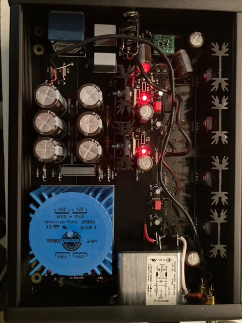

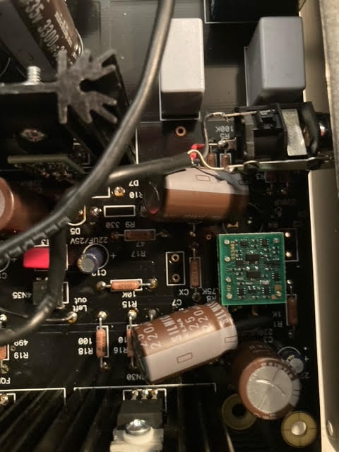

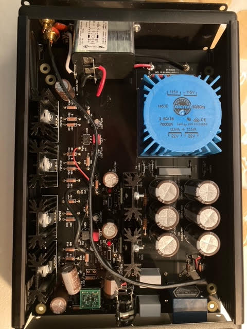

Here are some pics he sent me. Let me know if you need more. First time he said it was fine for 30 minutes then it started to make a noise. He turned it off and after running it the second time it was fine for 9 minutes
@da9520
Just let the Whammy run without the lid, the rest screwed together, of course, so that there are no short circuits.
You installed the 2 x 22V transformer. The 7815/7915 with the original heat sinks can get very hot in a closed housing, which means that all other components can also heat up very much.

Does it have the 0.1uF bypass caps across V+/V- and ground? Most opamps specify for one in their datasheet, I know Sparkos specified it's required.

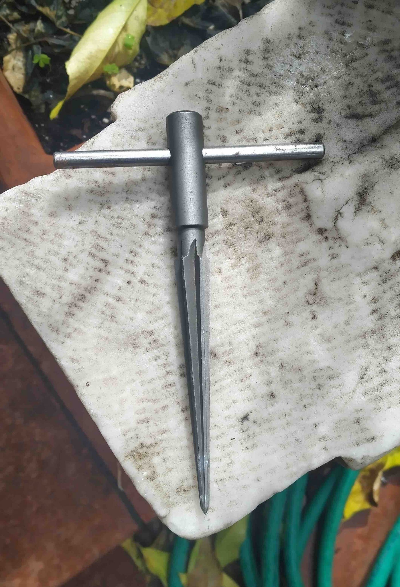

The surface finish is not conductive, so you should remove it where parts meet (not the whole length of course. This is the only way for having conductivity to every part of the chassis.
I've encountered anodizing before but never on something I was scared to scratch up. I was hoping to avoid reptile dentistry and someone had a simple solution. I have a hand reamer I think I'll try cleaning up one screw hole on the inner side of each panel and see what happens. I don't think the screws are painted, just blackened steel, they seem to be conductive, enough anyway. I decided I need to deal with the chassis before booting up, if there's any hum it'll rain on my parade, and worse I'll wind up going down blind alleys trying to troubleshoot it.
Sure, fingers crossed for a successful maiden flight. I still haven't done that (and I need to change a few other things), but it works flawlessly even now.
Quick report on the chassis continuity issue. I previously tested the chassis all bolted up except for the top plate, that just sat in place and I probed through the screw holes into the nuts in the tracks. When I put the chassis away last I screwed in the top plate to not lose the screws, today before taking a reamer to it I probed the chassis one more time to try and determine the best holes to ream, and surprisingly I had continuity between all the panels except for the back, even to the Alps casing. So, the little screws and nuts for the top panel must be biting into the side panels and the top, which is good and solves 90% of the problem. For the back panel I gently reamed out the four screw holes from the inside along with one of the Schurter IEC mounting holes that I will use for the ground cap and got continuity there too. BTW you can check the top and bottom plates for continuity, to be sure it’s not just the steel screws making contact with the sides, by sticking one probe into the vent slots at an angle with careful pressure, apparently the anodizing is thin there. So, all good now, almost ready for power up.
Hope this helps someone, and if you have the same problem don’t use a Dremel or file, the proper tool is a reamer like this one, it will scrape the anodizing on one side only:
