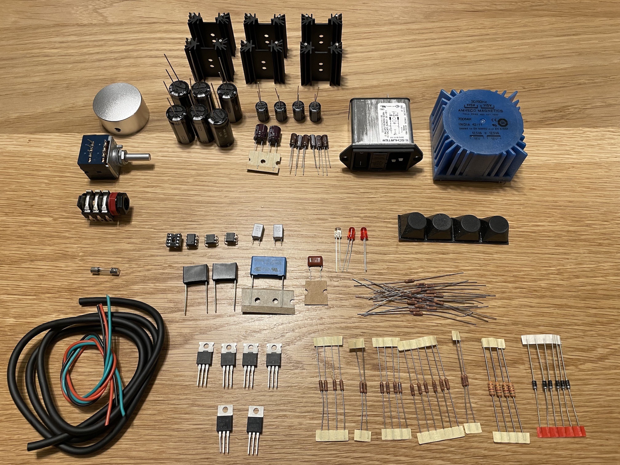

After about a 15 year hiatus from DIY audio, I'm taking the plunge back in and building this hpa. (Back in my university days I built some kit speakers and a gainclone amp, you can see the amp in the background of one of my pictures below) After stumbling on to this thread I bought the full kit from the store and I'm slowly working my way through. I read through the contents of this monster thread while waiting for the kit to arrive and now I'm beginning my build. Posting some pics of my slow progress below, because why not? Thanks everyone (Wayne and 6L6 especially) for rekindling my love of this hobby 🍻☺️

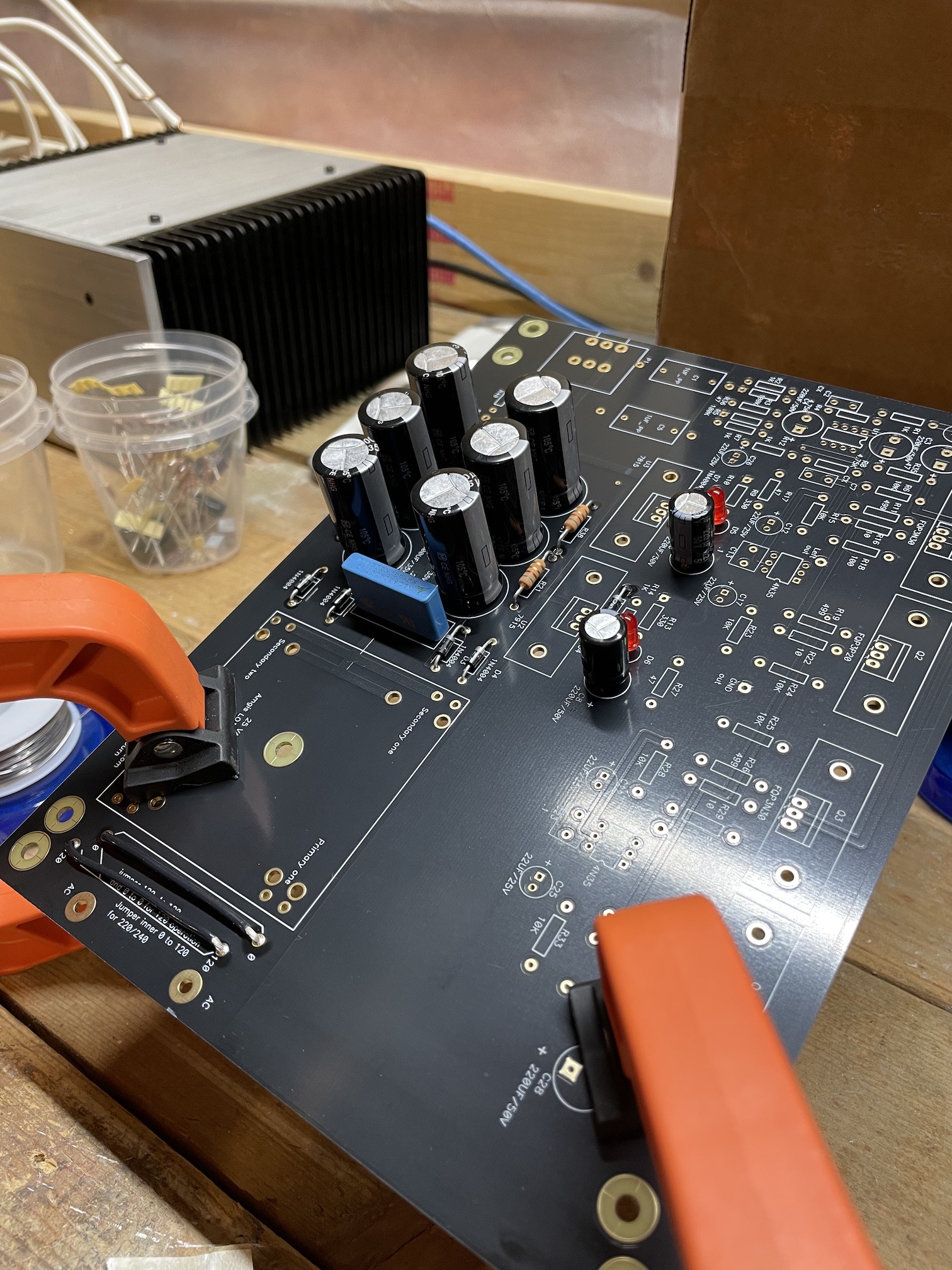

PSU section done. It turns on with no smoke. Measuring 16.91 and -16.94 for V+ and V- respectively. Onward and upward!

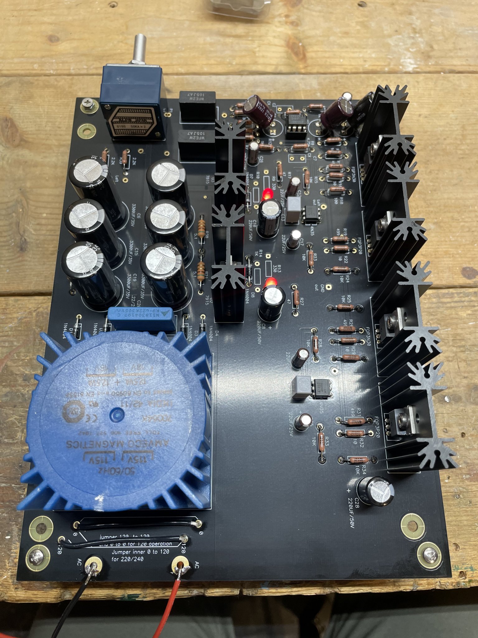

I was on vacation for a week so that delayed things. However, I’ve finished stuffing the PCB now and can begin mounting it in the case and wiring up the rest from there.
Turns on with no magic smoke coming out. DC offsets hover right around 6mV per side, so I’m happy to move forward!
