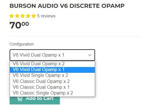

I plan change opamp to discrete opamp like Ticha 992enh or Burson V6 Classic Single opamp. Do you think it better than classic opamp ?
I think WHAMMY's printed circuit board requires dual opamp chips to be plugged into the DIP-8 sockets. 2 opamps per 8 pin package. Like LM833, TL-072, NE5532, LM4562, and so on.
So burson v6 or ticha do not better than classic opamp ? I am using opa445bm because my version using 2 single opamp.I think WHAMMY's printed circuit board requires dual opamp chips to be plugged into the DIP-8 sockets. 2 opamps per 8 pin package. Like LM833, TL-072, NE5532, LM4562, and so on.
Mark was saying that you would need the dual opamp in one package. Burson Audio V6 opamps are great. Many people have written about their thoughts in this thread. The options in the DIYAudio store are below. Either the V6 Vivid or Classic works well as long as you buy the "Dual Opamp x 1".So burson v6 or ticha do not better than classic opamp ? I am using opa445bm because my version using 2 single opamp.
