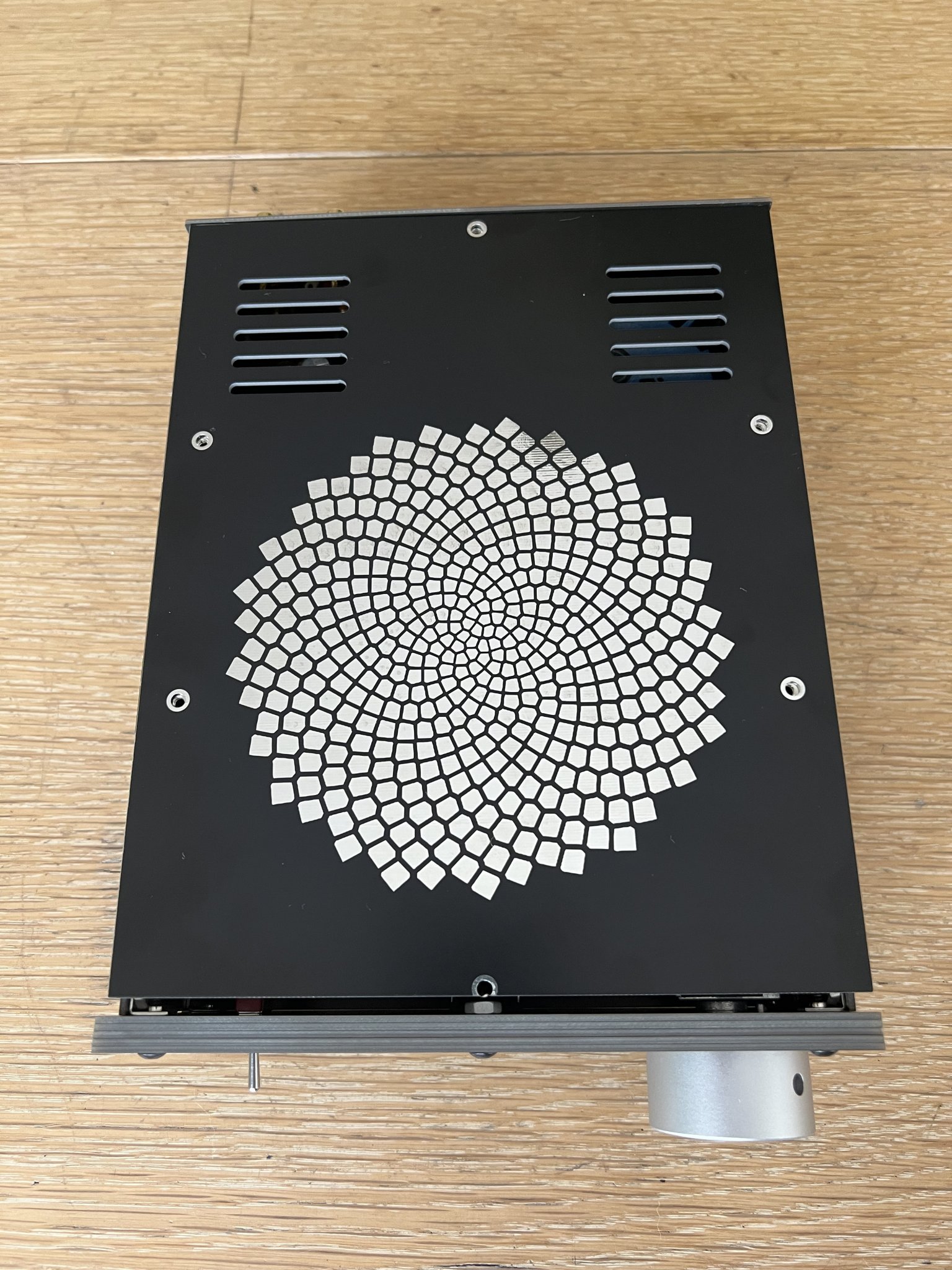

Here's my (in progress) WHAMMY. I took the opportunity to design the enclosure in Fusion 360 to improve my skills. The top panel needs to be redone to fix an issue.

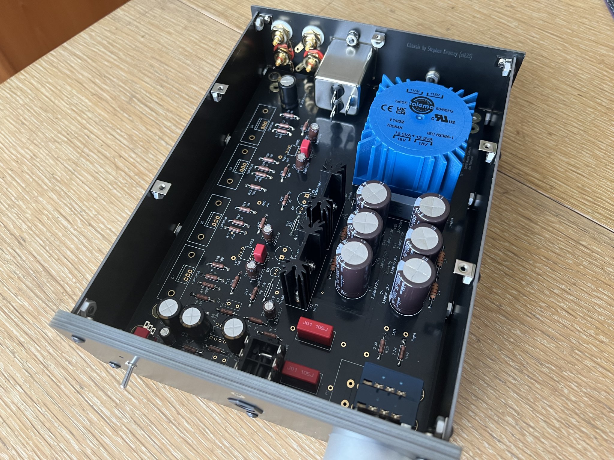

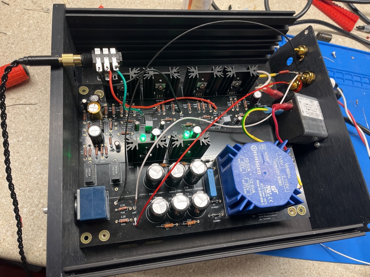

Thanks to this thread, I'm listening on my completed whammy. Here's a picture of the sloppy insides on final tests with a sacrificial pair of grados:

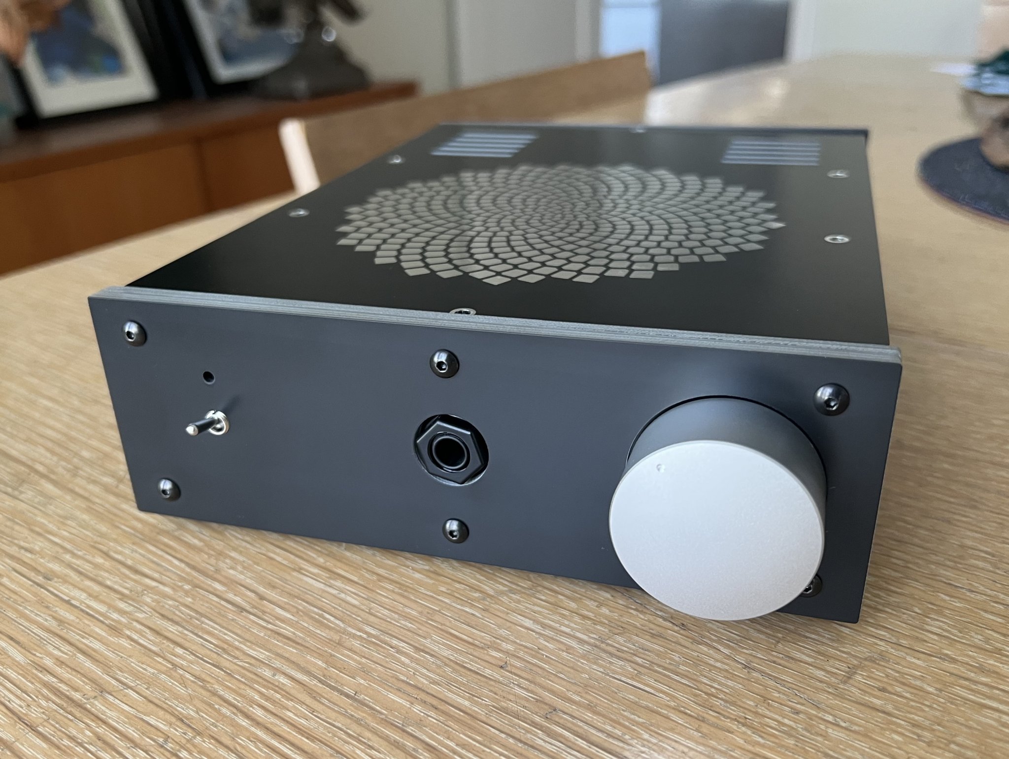

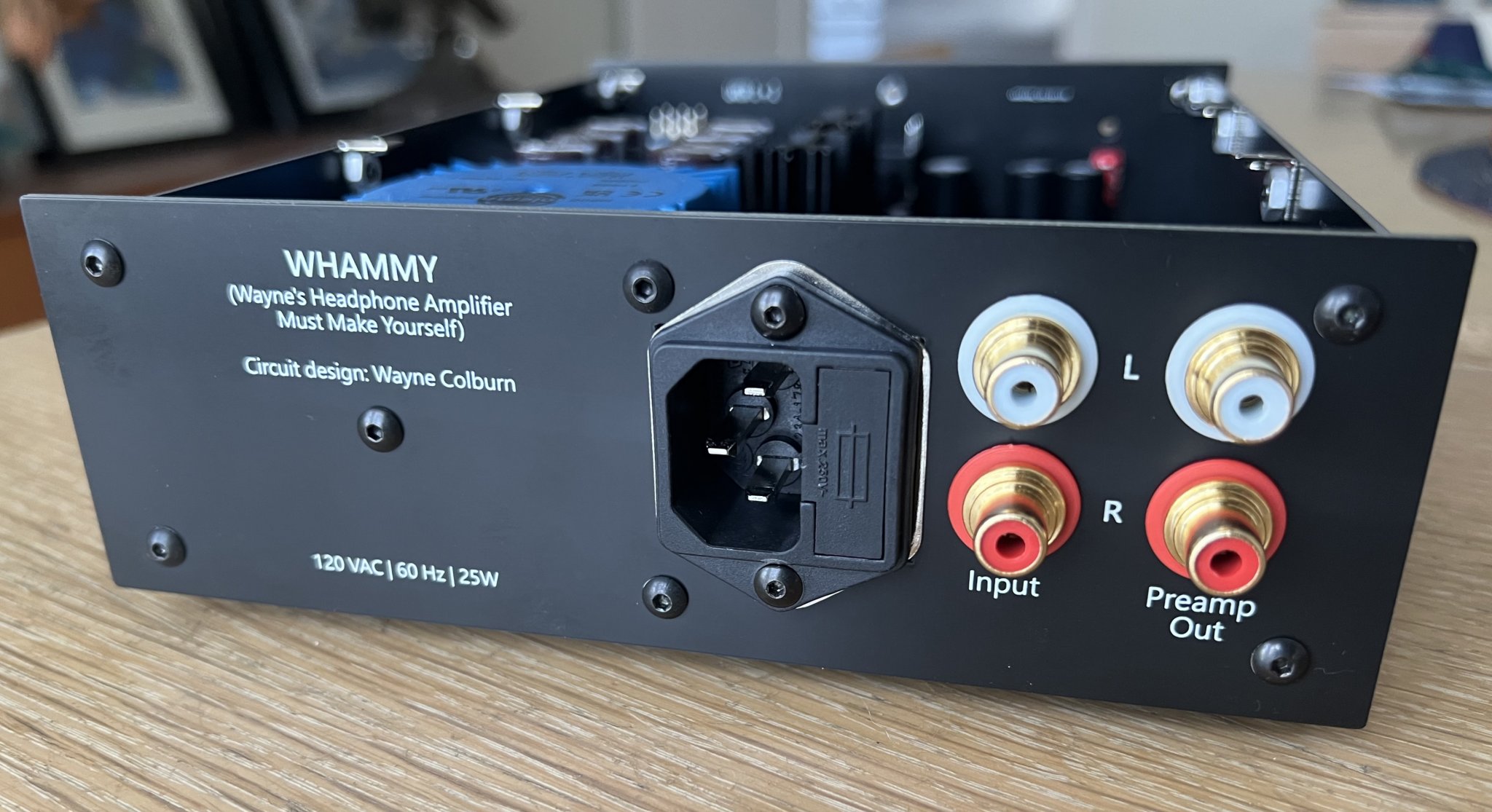

And a picture of my boring case, with a custom "knob" from a pal of mine ( @puck77 ->. https://www.diyaudio.com/community/threads/whammy-pass-diy-headphone-amp-guide.317803/post-6718478 )

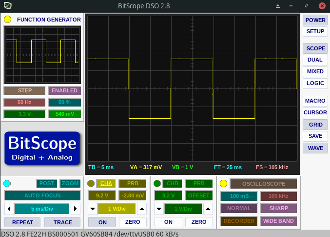

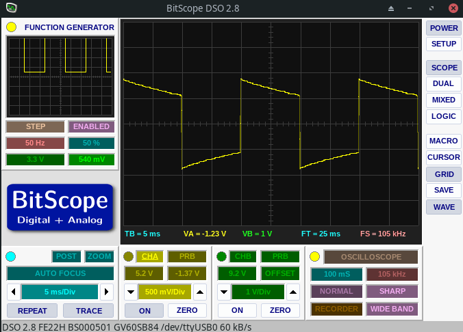

If you have a scope and a square wave input to the Whammy C1 you can see (at U1-1) that the square wave input is no longer flat. I believe that C1 at 1uf needs to be increased so the bass is not rolled off at 50hz.Hello vdupham,

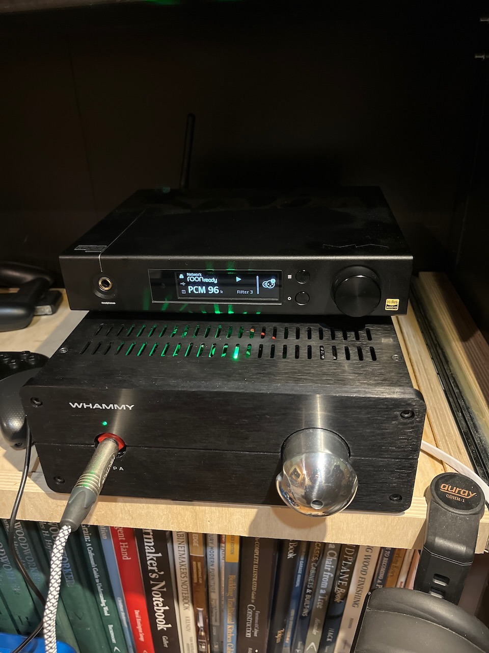

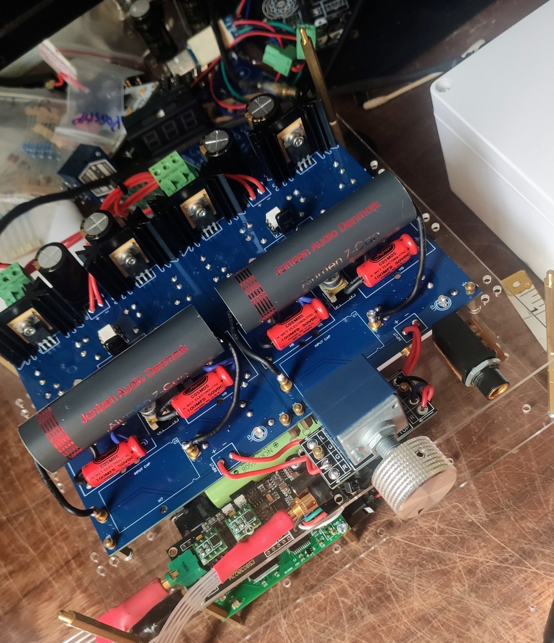

Hi huge thanks to Pass Lab members and others to help me complete my build. I built my version Whammy, its mono version. I use IRF610/IRF9610 mosfet output and 2 single OPA445BM opamp. My headphone is Hifiman Sundara. Soundstage is outstanding, detail is so good with mature and neutral. And PSU part is LM317/LM337 with DC servo LF453, so zero noise or hum.

It is notIf you have a scope and a square wave input to the Whammy C1 you can see (at U1-1) that the square wave input is no longer flat. I believe that C1 at 1uf needs to be increased so the bass is not rolled off at 50hz.
C1 =1uF into R3 = 100K = F-3dB at 1.6hz.
