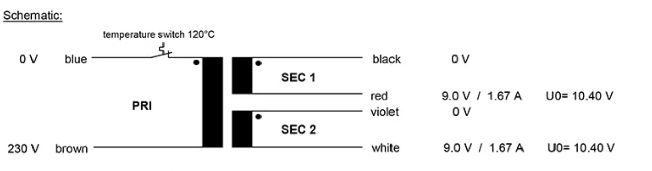

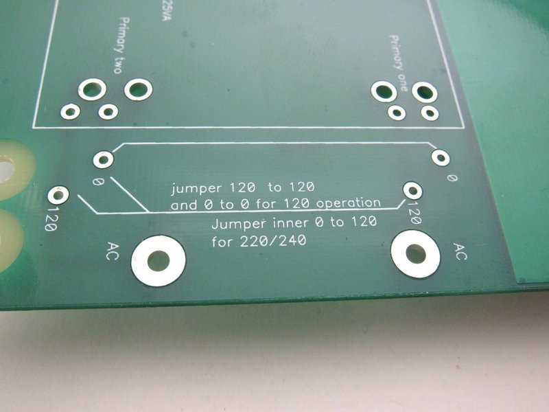

Hi Everyone, I am trying to modified the Whammy Kit from original Talema Transformer to Primary 230V Transformer. As the primary voltage of new transformer is 230V only, how should I solder the transformer in the pcb? And How should I solder the jumper? Thanks.
