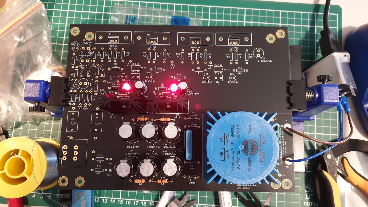

Hello all. I'm slowly working on my new Whammy kit (power section done and working so far), and am wondering if people could help me collate here the things that have changed between the publication of the build guide and the new full kit, so that I know which things I need to investigate for myself outside the guide.

Anyway, here's mine so far. I'm enjoying it, albeit in small bursts when parenting allows.

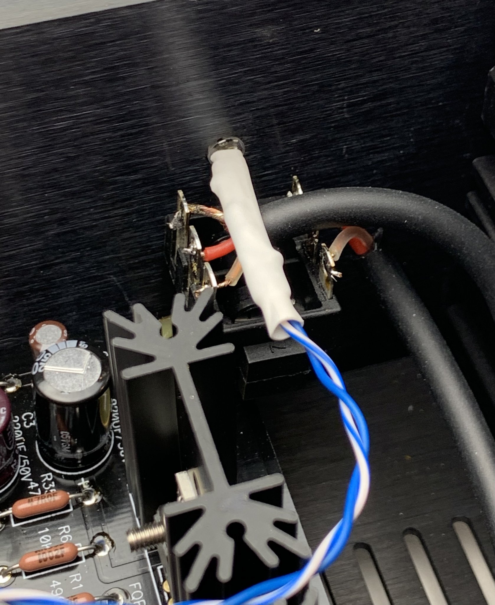

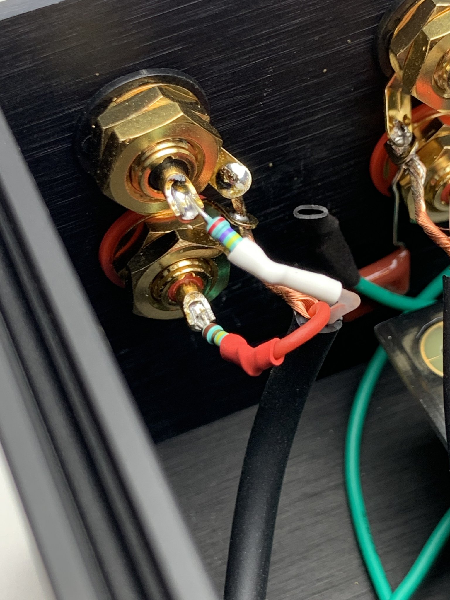

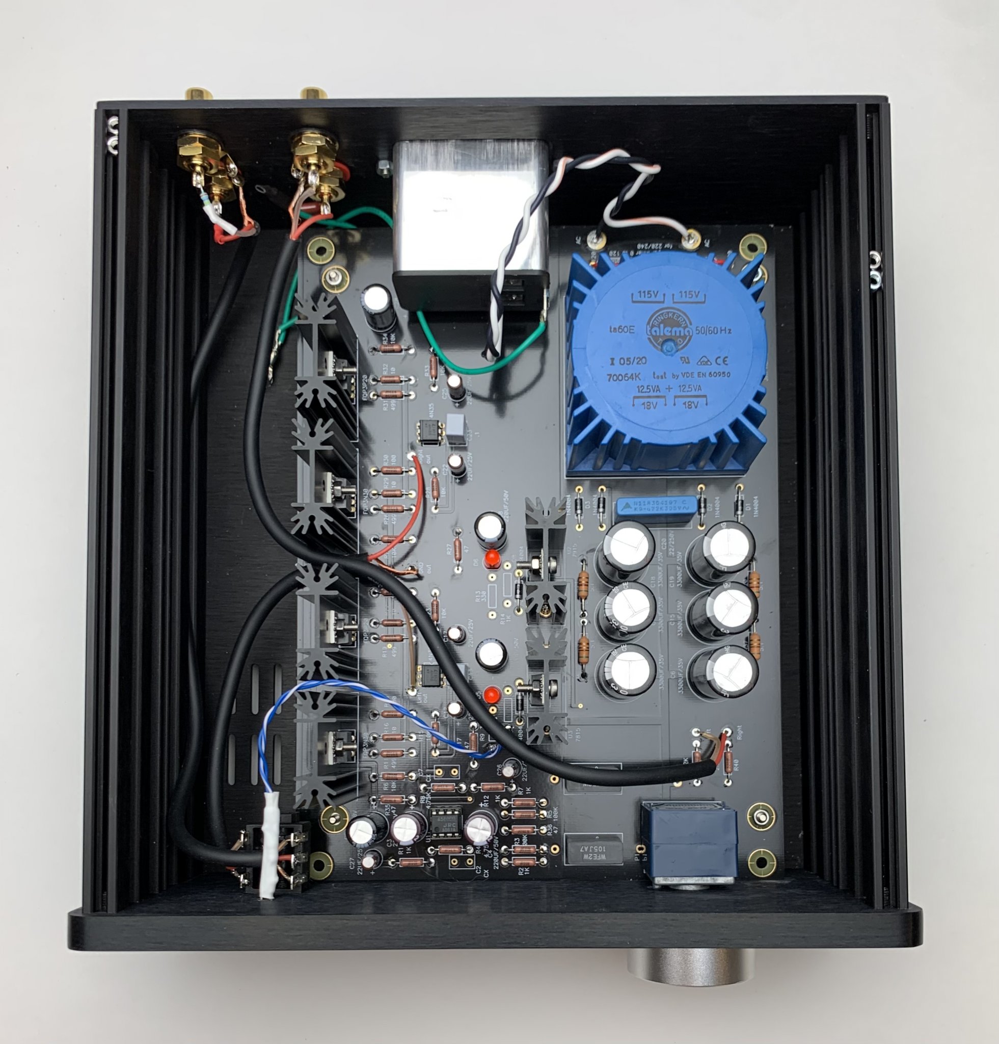

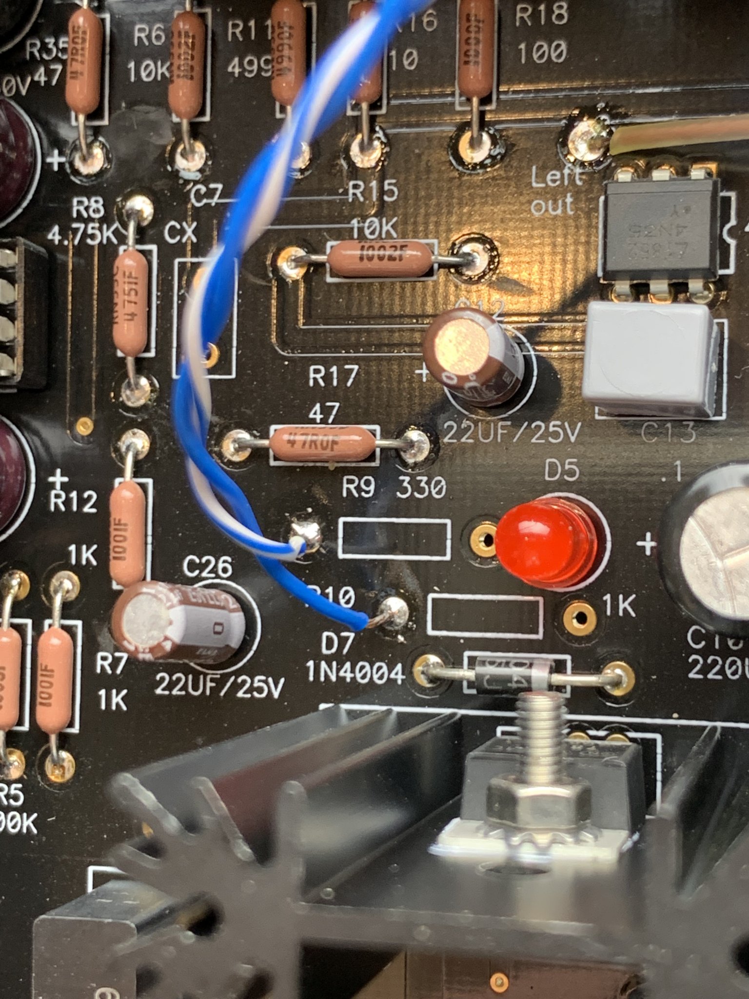

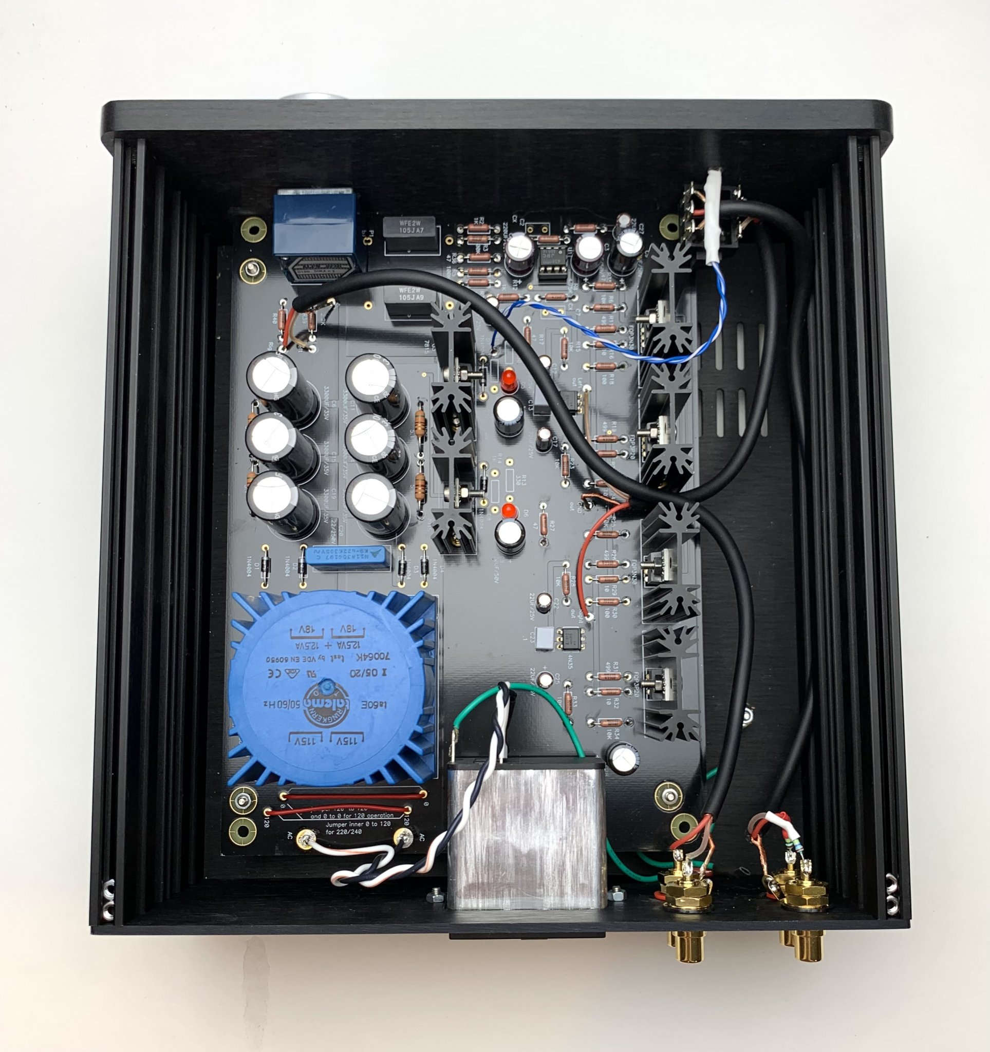

Here are some photos to help answer your questions -
LED can attach here. The LED current resistor is attached to the LED and covered by heat shrink in these photos. Use anyting from 15K-30K depending on how bright you want it.
The line out can be directly attached to the RCAs from the headphone jack, but it’s a good idea to add some low-value build-out resistors so the output is always looking into a little resistance when nothing is plugged in. These are 27ohm. Anything between 15ohm and 47ohm will work perfectly.
And a couple of overview shots in the new chassis.

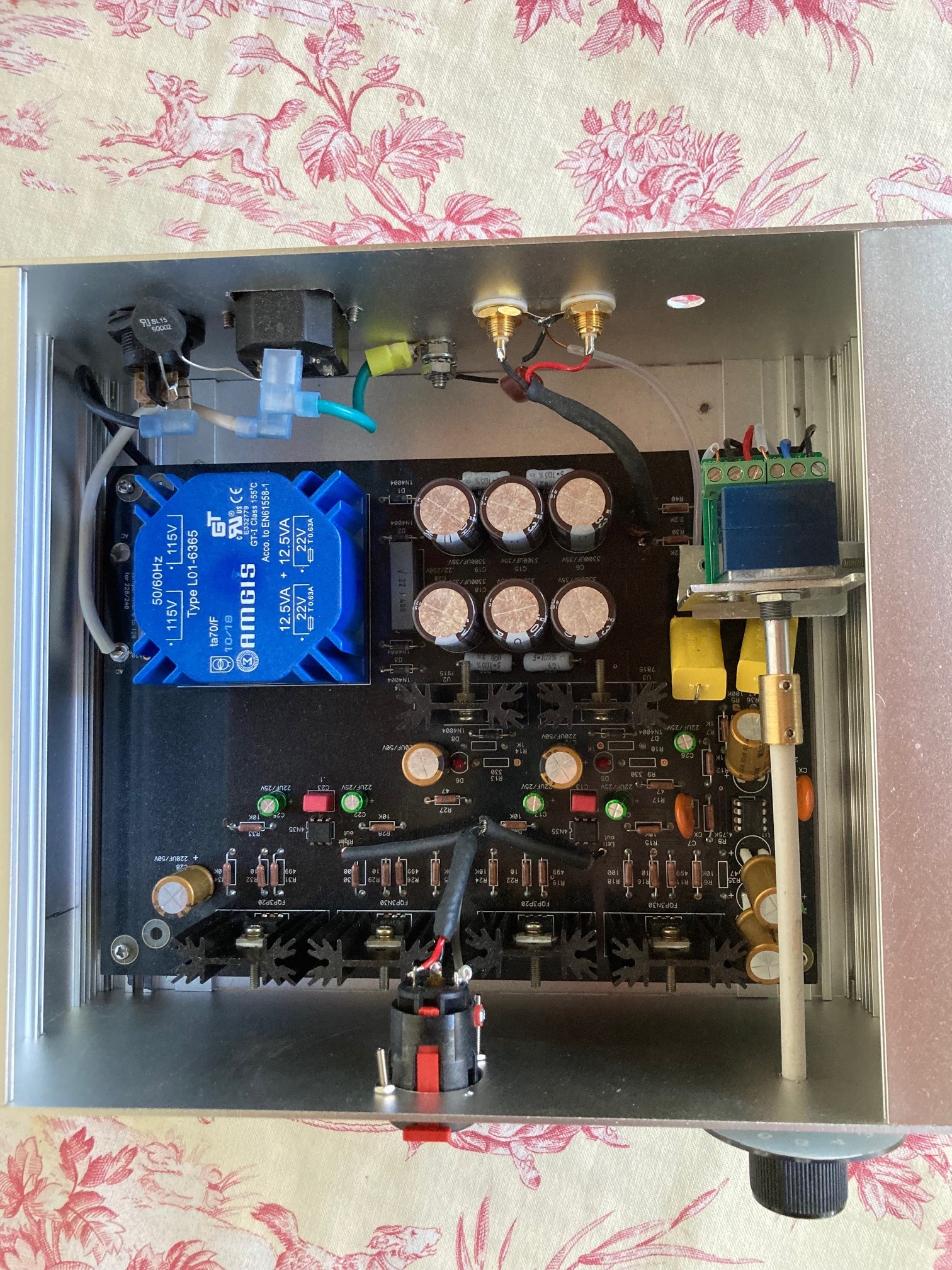

I thought I'd share my latest iteration. Originally I tried it as a LS/HP but I didn't have the glassaudio switch and I didn't
understand the dual nature of your HP socket. What I was shooting for here was shorter wires. It's working well fed with either a
Aries terminator II or somewhat portably with a Explorer2. The skimpy chassis a $29 amazon purchase. Thanks all for an
entertaining pastime during covid.
