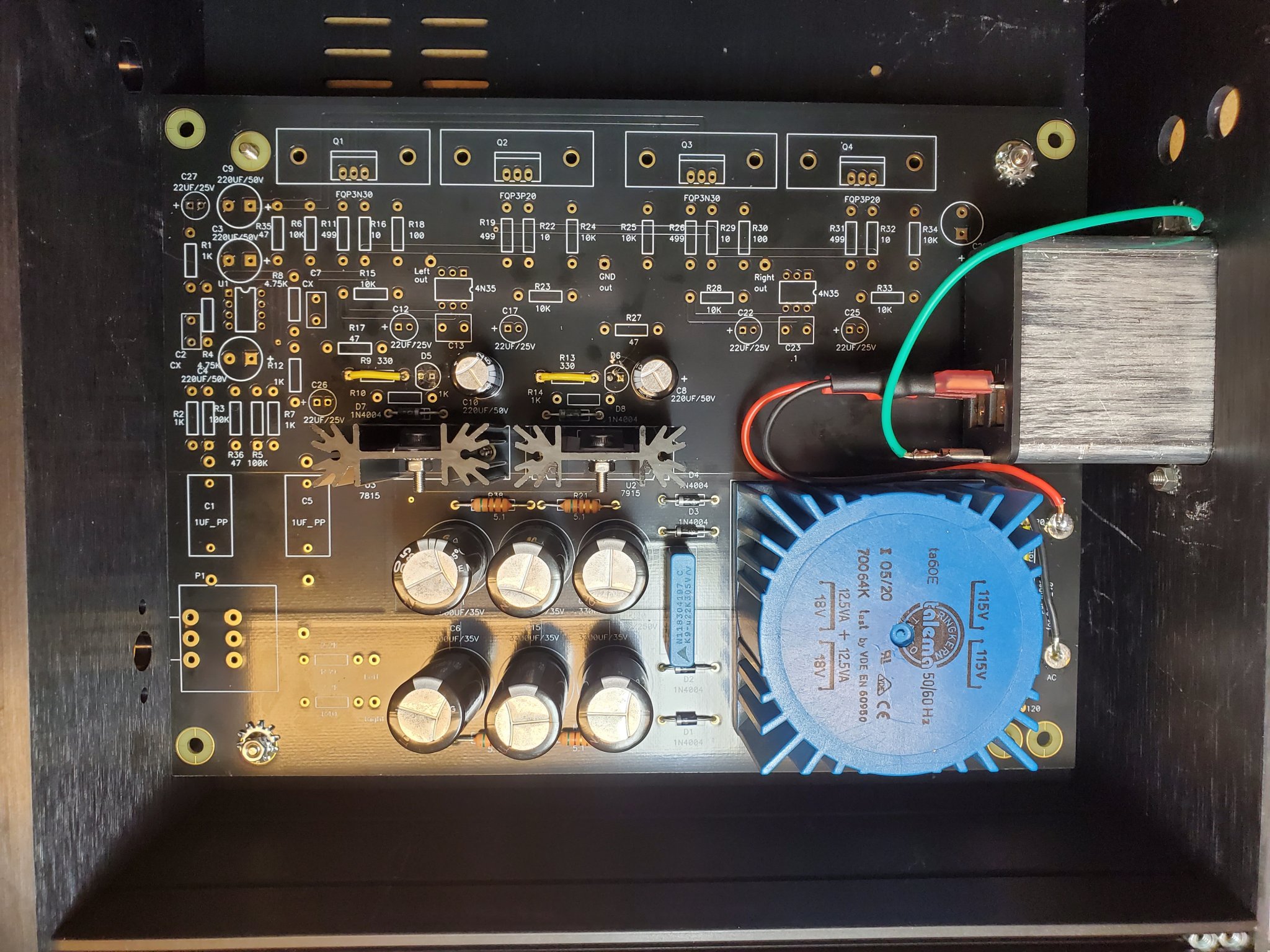

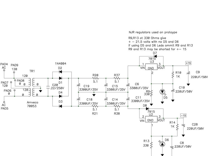

This is a follow up post to my previous posts on a whammy PSU that is not performing as expected. I have made some changes. I removed the LED's after figuring out that that I had installed D5 backwards. Unfortunately they did not come easily and are now unusable. Given that I installed jumpers accross R9 and R23 to use the "naked regulator" option. I checked the ground pin on the 7815 reg and got a solid ground. When I checked with my voltmeter between the input and output leg I discovered a short. Does anyone have a suggestion for replacements of the voltage regulators? Or at least 7815? I did a brief search on Digi-key but I'm not sure what to look for in terms of output current and other parameters. Thanks everyone!
You can use this part from Digikey: 296-21624-5-ND . It's a Texas Instruments 7815 and good for 1.5 Amps of current and it has a power supply rejection ratio of 78db which is pretty good for these kind of regulators. You should also get some solder wick from Digikey while you are at it since it makes de-soldering easy.This is a follow up post to my previous posts on a whammy PSU that is not performing as expected. I have made some changes. I removed the LED's after figuring out that that I had installed D5 backwards. Unfortunately they did not come easily and are now unusable. Given that I installed jumpers accross R9 and R23 to use the "naked regulator" option. I checked the ground pin on the 7815 reg and got a solid ground. When I checked with my voltmeter between the input and output leg I discovered a short. Does anyone have a suggestion for replacements of the voltage regulators? Or at least 7815? I did a brief search on Digi-key but I'm not sure what to look for in terms of output current and other parameters. Thanks everyone!
There was a bill of materials for this at the beginning of the thread. Test for shorts after you have soldered the parts in and look closely for solder bridges from excess solder between pins. Get a few extra LEDs. Look at the LEDs closely before you put them in. There is a flat surface on the case of the LED near the pin that is cathode lead (the line part of the schematic symbol). The longer of the two leads is the anode (the triangle part of the schematic symbol). Be certain that your LED is oriented correctly before you solder. Enjoy!

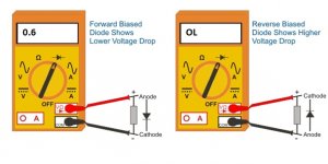

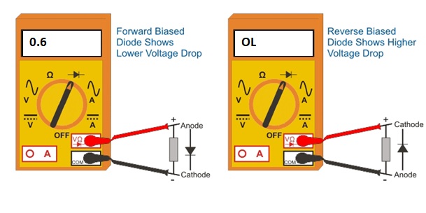

I know a 'short is a short' 🙂 but are you reading this on a 'low ohms' range capable of resolving low ohm values? Also are you sure the diode across the reg is OK?
If your meter has a diode setting try using that. Measure (in both directions) with the diode setting and see it you get something in the 0.6V to 0.7V range.

This is a follow up post to my previous submissions regarding my Whammy headphone amp with malfunctioning PSU. Originally I had an unlit D5 LED and a reading of 30 volts on the positive rail.
After reading through the reply from other members, I decided to replace both LED's as well as regulator 7815. I also removed the temporary jumpers on R9 and R13that I installed prior to receiving my new parts. I broke what I consider a cardinal rule of repair which is, don't start replacing parts until you know for sure what the problem is. However, sometimes you get lucky. I now have two functioning LED's and 16.8v on the positive rail and -16.3 on the negative.
Thank you to everyone who responded to my posts. I also added a digital multimeter,, a desoldering pump and a component multitester to my toolkit. Now...onward with the build!
P.S. In hindsight, I believe the problem was a defective LED at D5.
