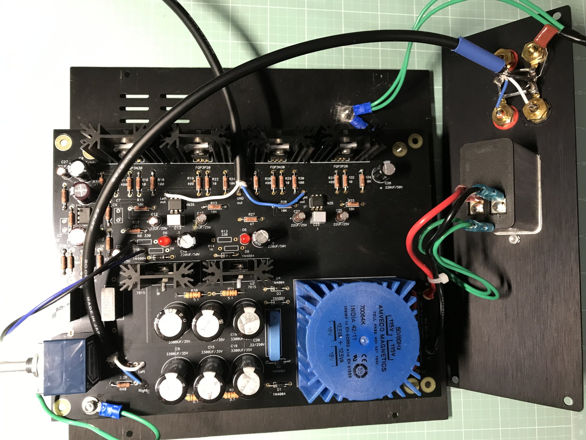

Here is my build. Currently, I am using it as the main amp as it is able to drive my 8ohm FR speakers easily.
Whammy gets you head, pre, and power amp in a single package 😛

I have just completed my Whammy. So impressed with the great design and rapid delivery from diyaudio store. It is grounded properly, my volume pot is grounded to chassis. I have checked all resistors for correct value and correct position. I have the LED voltage reference and a 4850DD op amp. My power supply voltages are both in 16v range. The left channel DC offset (measured with no input or output connected is nearly double the right channel. (12 mv vs 5.8 mv). It is louder in the left channel and after leaving it on for about30 minutes the output devices for the left channel are much warmer than the right. It then distorts badly. I have also tried a LM833N which shows even bigger difference between the channels. I have rechecked all solder joints. Where should I start troubleshooting next?
Can you take closer pictures of the regulators from the top and bottom of the board? Have you double-checked the resistor values? You did a nice job of leaving the resistor codes on top, but I cannot read all of the values with the photo you attached.I have just completed my Whammy. So impressed with the great design and rapid delivery from diyaudio store. It is grounded properly, my volume pot is grounded to chassis. I have checked all resistors for correct value and correct position. I have the LED voltage reference and a 4850DD op amp. My power supply voltages are both in 16v range. The left channel DC offset (measured with no input or output connected is nearly double the right channel. (12 mv vs 5.8 mv). It is louder in the left channel and after leaving it on for about30 minutes the output devices for the left channel are much warmer than the right. It then distorts badly. I have also tried a LM833N which shows even bigger difference between the channels. I have rechecked all solder joints. Where should I start troubleshooting next?
Chris, thank you for the prompt reply. I reflowed all the solder on the bottom of the PCB and now the difference is much smaller (7mv vs 5 mv). I have pu the PCB back in the case and will remove it and take the photos over the weekend. Cheers, PieterCan you take closer pictures of the regulators from the top and bottom of the board? Have you double-checked the resistor values? You did a nice job of leaving the resistor codes on top, but I cannot read all of the values with the photo you attached.
1. Check all resistor values.I have just completed my Whammy. So impressed with the great design and rapid delivery from diyaudio store. It is grounded properly, my volume pot is grounded to chassis. I have checked all resistors for correct value and correct position. I have the LED voltage reference and a 4850DD op amp. My power supply voltages are both in 16v range. The left channel DC offset (measured with no input or output connected is nearly double the right channel. (12 mv vs 5.8 mv). It is louder in the left channel and after leaving it on for about30 minutes the output devices for the left channel are much warmer than the right. It then distorts badly. I have also tried a LM833N which shows even bigger difference between the channels. I have rechecked all solder joints. Where should I start troubleshooting next?
2. Solder Opamp directly into the board. Do not use dip adapter.
3. Check the Alps RK27. It might have channel imbalance.
