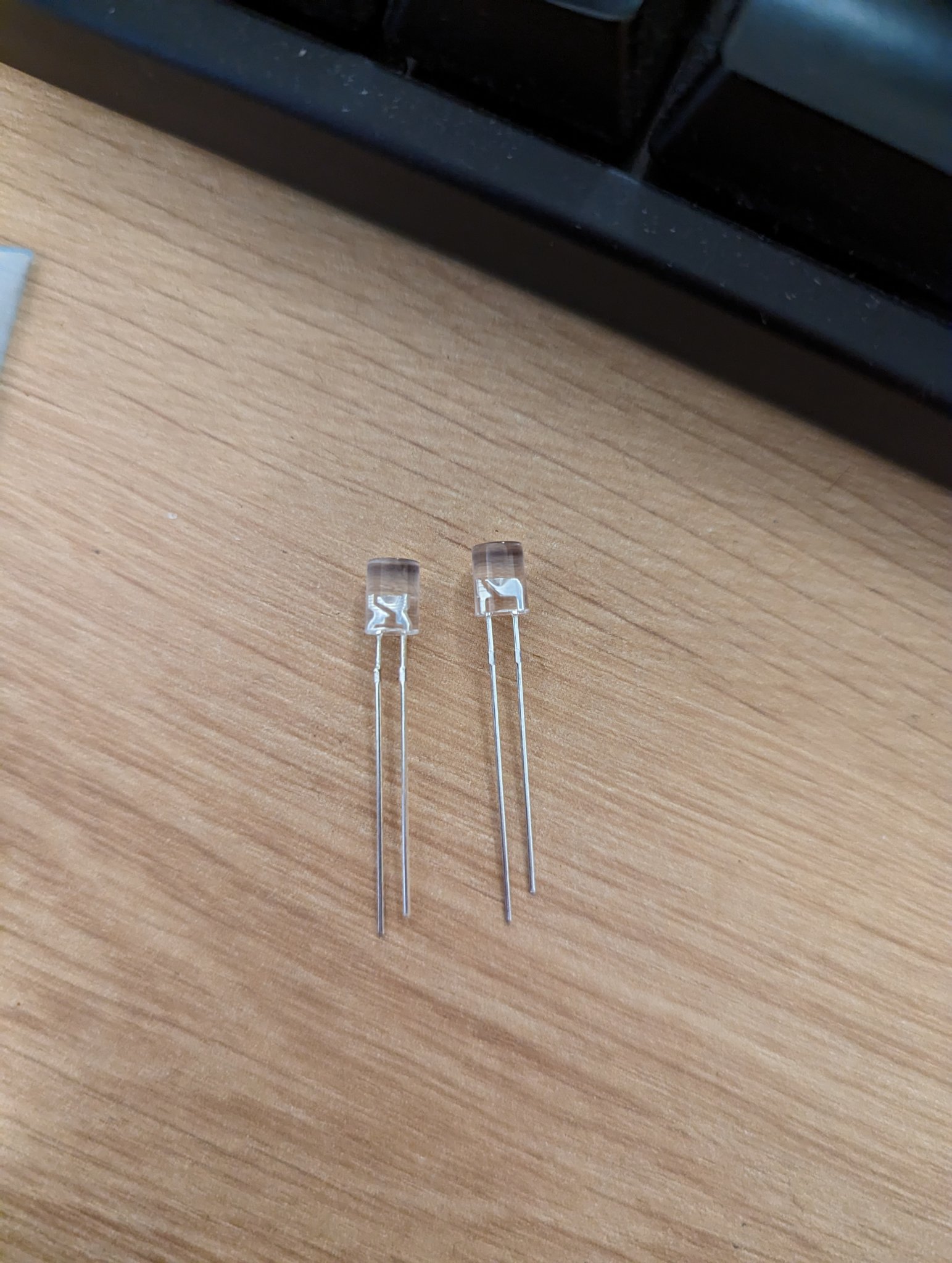

Turns out it was white, as I just found mine in the drawer. The forward voltage is slightly different (2.478v vs 2.208 for the green) but the form factor is identical (see attached - original on the left, green on the right).

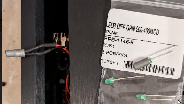

IMO, white and blue LEDs are too bright as power-on indicators. A small 10ma green LED with 5ma will give a soft glow.
I inserted the LED in a piece of cable jacket to insert it suggly in the panel. It can be unplugged for service. The green LEDs are generic 10ma. The short lead is ground, the longer lead is "+". The red wire goes to a 2700 ohm resistor which is connected to +15 or +22 at R10. The black wire goes to R9.

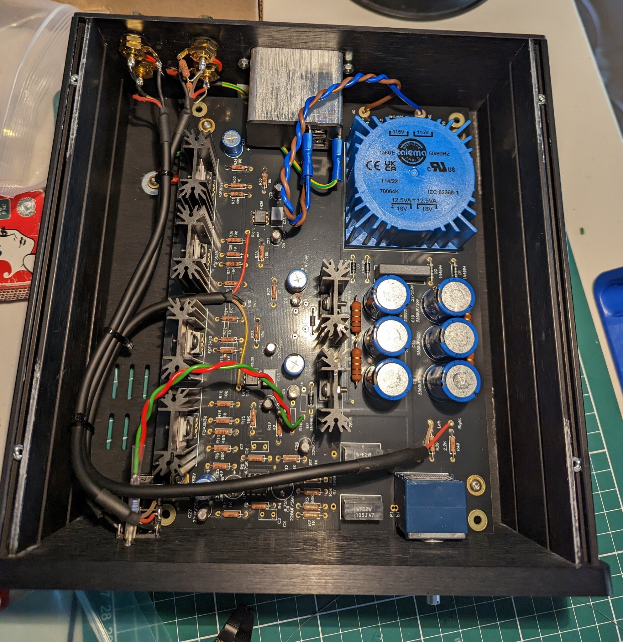

Just posting to say, after many, many weeks of chipping away at this between parenting, my Whammy is complete!
The slightly different components on the power section are due to my original board having a manufacturing issue (I got confirmation of a replacement board after I had completed and tested the power supply on the original, and replacement parts were cheaper than a desoldering gun). 😅
The removal of anodising near the bolt holes is intentional, fwiw, to ensure every panel is grounded.

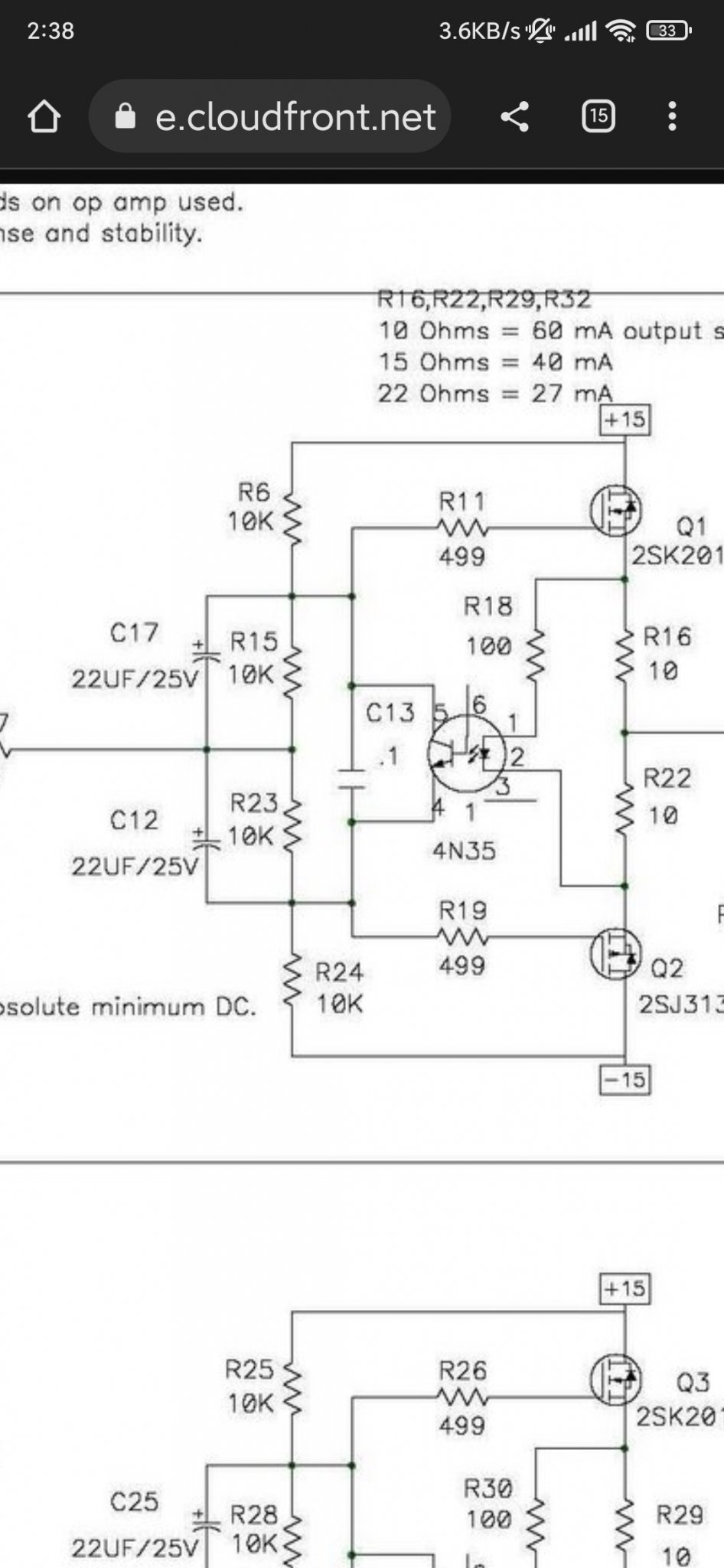

protect whammy opamp from overvoltage:
The Whammy build procedure gives 3 options for 7815 output voltage -- 15v, 17v, or 22v. This does not bother the MOSFETs but it could damage an opamp where the absolute maximum supply voltage is exceded. I believe that the opamp supply should be fixed at 15v so that variations in 7815 MOSFET settings or transformers do not cause faults.

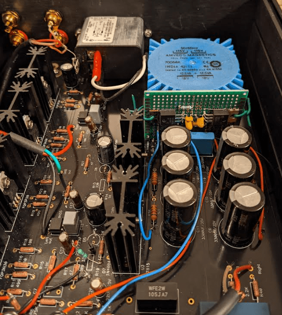

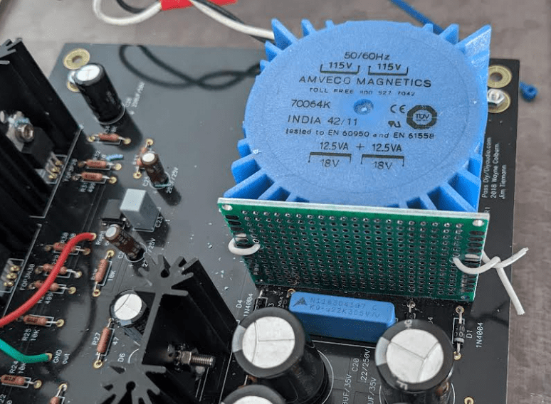

I modified the Whammy with 7815,7915 regulators just for the opamp. I installed a gridded PCB by drilling holes in the non-functional fins of the toroidal transformer. I lifted the hot side of R35 and R36 so that the opamp is powered by it's own regulators.
Be aware that the MOSFET regulators suffer more stress when a higher voltage toroid is used. This occurs because of the increased voltage across the linear regulators. Also, the vertical heatsinks on the main board are not very effective without a cooling fan.
