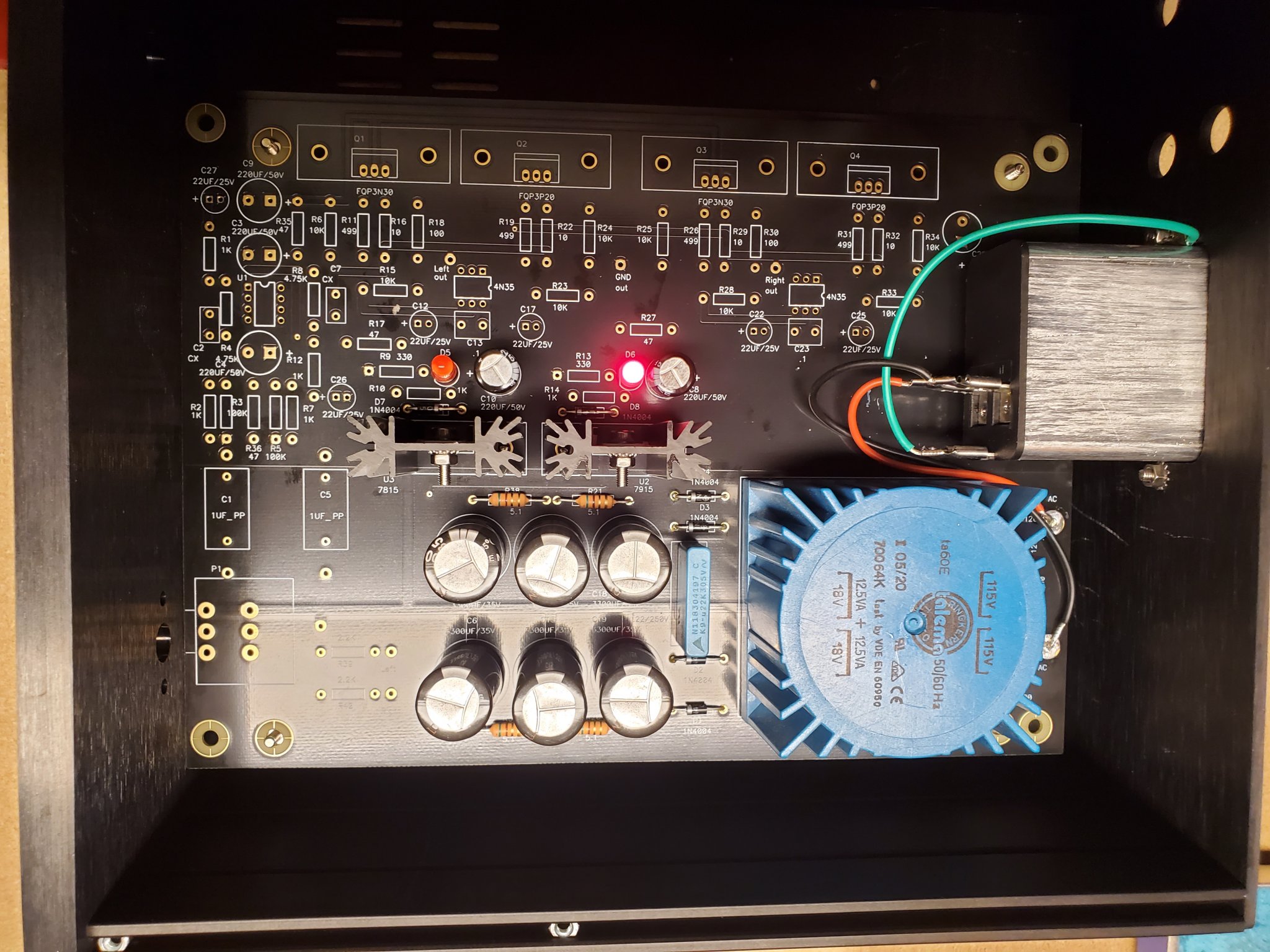

I need some feedback from someone with more experience regarding my project. I am constructing my recently purchased Whammy headphone amp.
The problem comes to light when I power on the PSU and check for proper voltage. The negative side reads -18.1 volts which I understand is great. The positive side however, shows 30 volts. Additionally, one of the LED's fails to light. I suspect the nonlit LED is on the affected circuit. Any suggestion what I might check before disassembling the affected side and replacing components? I have attached the schematic and a photo of the board under power. Thank you in advance for any suggestions.

Welcome to diyAudio 🙂This is my first post. I am a newcomer to the community, let me know if I am posting incorrectly.
Quick things to check...

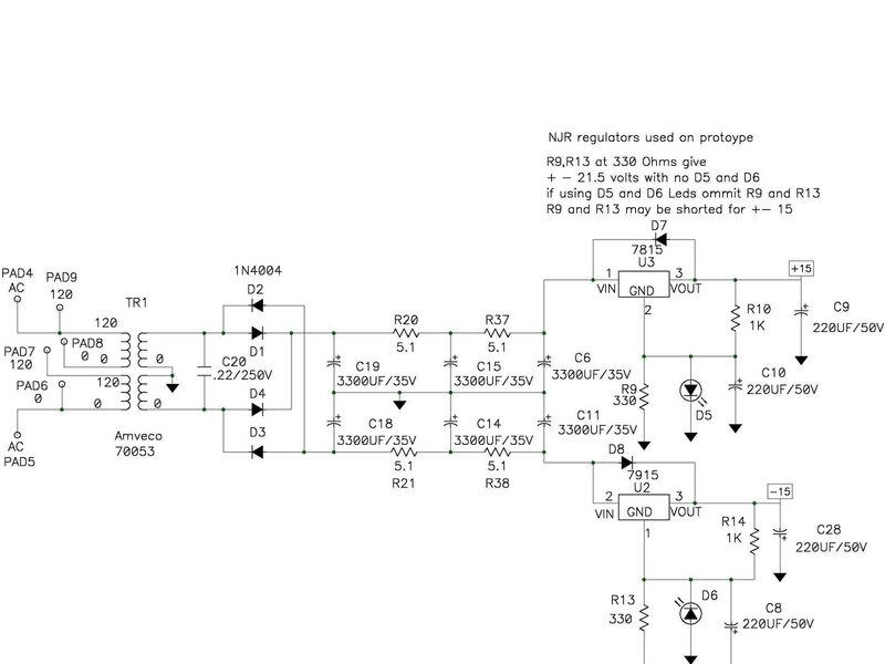

1/ That the 7815 really is a 7815. Look very closely at the markings. Make sure.
2/ That D7 is correctly fitted.
3/ That you have no shorts between any pins of the 7815
Things to measure.
With it on measure the voltage across R9. What do you see?
With it switched OFF check you have no short across D7.

OK 🙂 and good luck. Whatever is going on is probably something simple. There are very few possibilities really.

Interestingly, I had the exact same issue but with the opposite rail. The correct value on positive, but -30 volts or so.
I get the right voltage across C6 and C11. I replaced the 7915, diode, and LED to no effect.
I ended up abandoning that PCB and bought a new one from the store, and full replacement parts for the PSU. worked perfectly after that using the rest of the existing kit.
I do want to get back to solving it, as a personal challenge, but haven't had time. Hopefully the solution that solves yours, solves mine, too.

Just something to check... Look closely at the board traces (maybe with magnification?) for any unetched copper between traces that shouldn't be there. If it's coated it will be even harder to spot. If you don't find anything visually you should pull the parts off (carefully!) and check between traces with a meter. Also check that via's connect top and bottom of pads. I always solder both sides (where possible) to eliminate the possibility.
It's rare but can happen. I got one board a while back (out of many purchased, not Whammy) that had a tiny bridge of copper between 2 traces that wasn't completely etched away. Drove me nuts until I finally spotted it. It was green coated. Black is worse. Good luck!

This is a follow up to my previous posts. Regarding my Whammy kit with 30 volts on the positive rail. I checked the voltage regulator and it is indeed a 7815. Also, I found no unsoldered pins, nor did I find any solder bridges between pins.
In the interest of time, I have decided to order a new PCB and populate it with new power resistors, capacitors and diodes. I will also replace the voltage regulators. I will disassemble the original board at a later date and test each component to try and determine what is wrong. If I come up with anything I will post it for the benefit of anyone who runs into the same problem. Thanks again to everyone who responded to my post.

This has to be something simple. The regulator output is +15 volts added to whatever voltage the middle pin is at. Just connect the middle pin of the reg to ground and see if you get +15 volts.This is a follow up to my previous posts. Regarding my Whammy kit with 30 volts on the positive rail. I checked the voltage regulator and it is indeed a 7815. Also, I found no unsoldered pins, nor did I find any solder bridges between pins.
If you still see 30 volts at the output then either the reg is faulty, the ground around the reg is not ground (broken print... actually check that the middle pin has continuity to the print and make sure the pad is not broken or lifted such that it is isolating that pad from the print). The only other possibility is a 'short' from the input side of the reg to the output.
Check that pad first though.
