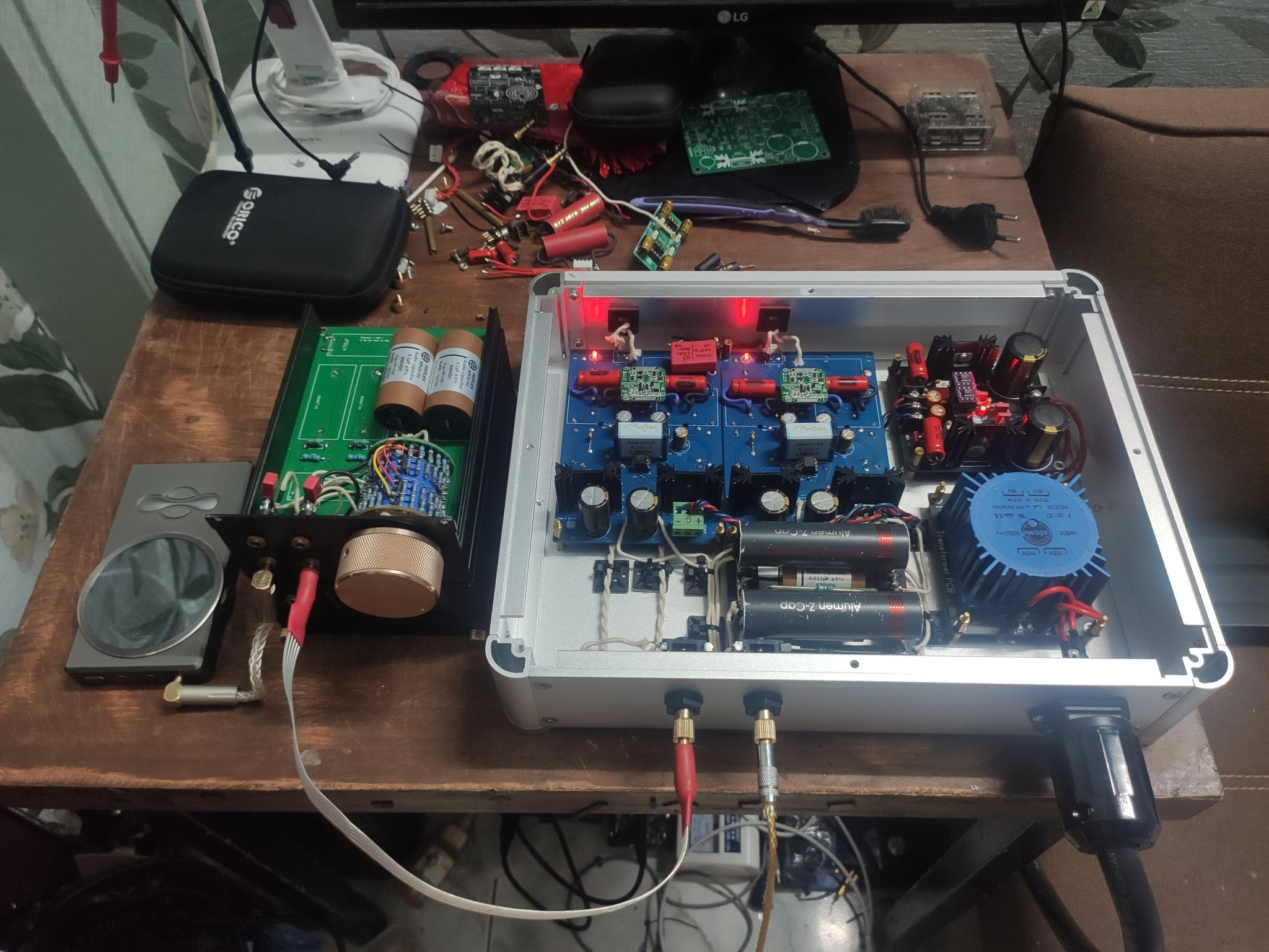

I like that enclosure more than the one in whammy complete kit. The 7815 and 7915 in the original get very hot when the unit is enclosed. This is due to voltage drop across them 26v-15v. Also I believe the PCB mounted heat sink plates are inadequate without forced air in the enclosure or a change in topology to improve convection cooling. I should mention that the headphone sound is enjoyable.Modding Whammy version, I am using LM317/LM337 DC servo for power supply. Anyone plan to upgrade old whammy version with new power supply part like Sigma 22 or others class A power supply
The linear regulators would run cooler if the VCC, VEE were raised to about 20vdc but the opamp would need it's own supply.
Is there a brand name of the enclosure? I like it too.I bought from my local store
