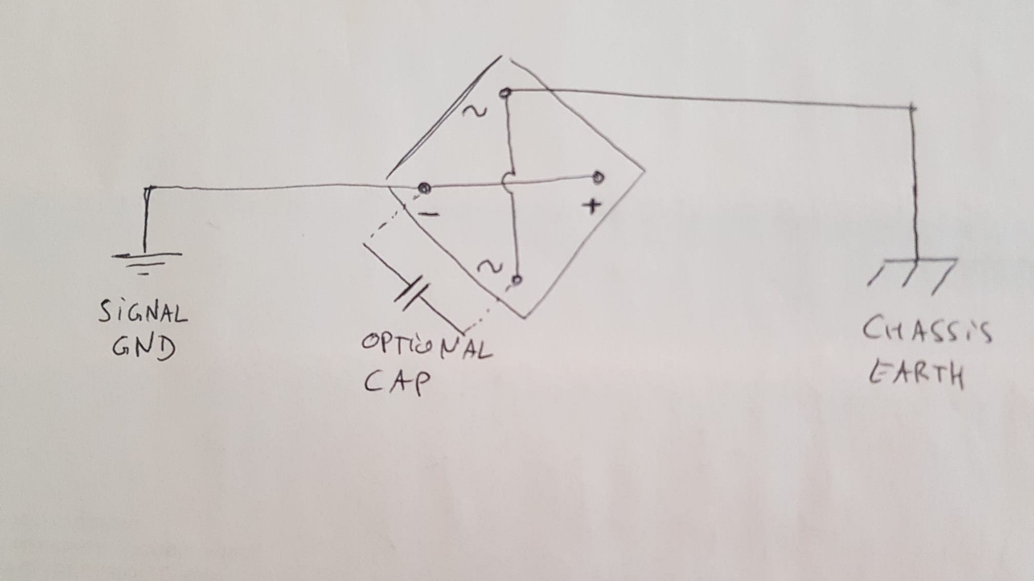

both AC terminals are connected together and go to chassis ground (the connection between both terminals must have the same wire gauge as the rest of the cable! Pos and Neg are connected together and go to signal ground (same wire gauge).
then, you connect your red cap between one of the AC terminals and one of the DC terminals (Pos or Neg, it doesn't matter since there are interconnected thanks to your wire).
Don't hesitate do post a pic here once you have done it so we can validate your wiring if you're not sure. This is a potentially life-saving circuit that must be done the right way.
