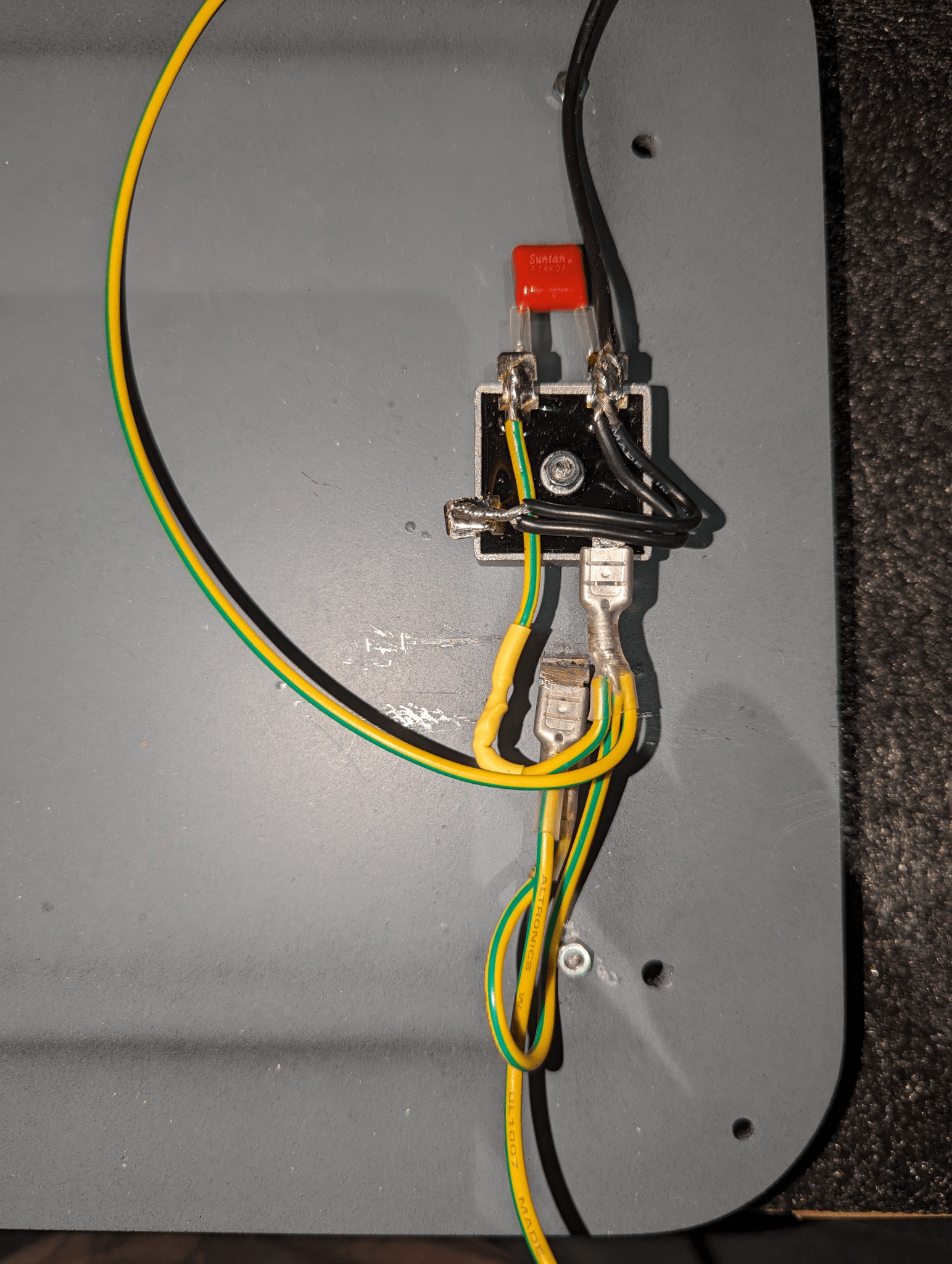

@Denis - do this go to earth on the chassis or the AC input on the bridge?btw, if you have shielding on your internal wiring (for instance if you run AC mains wires from the IEC socket on the rear to a power switch to the front), the shield must go to earth (chassis) ground, NOT signal ground.
it's basically the same, just do what's easier for you: on one of the AC terminals of the bridge, somewhere on the case (make sure you have good contact if the case is painted or anodised, though) or on the earth terminal of the IEC connector. The current from the shield to earth will be in the picoAmp or nanoAmp range, so it really doesn't make any difference. The only thing to take care about is to NOT connect shielding to signal ground, but to earth.

My build. Bottom yellow cable from power inlet into chassis earth. Left yellow cable to input cable shield. Black cable to input signal ground.
Works beautifully - I can turn the volume all the way up with zero noise. Impressive.

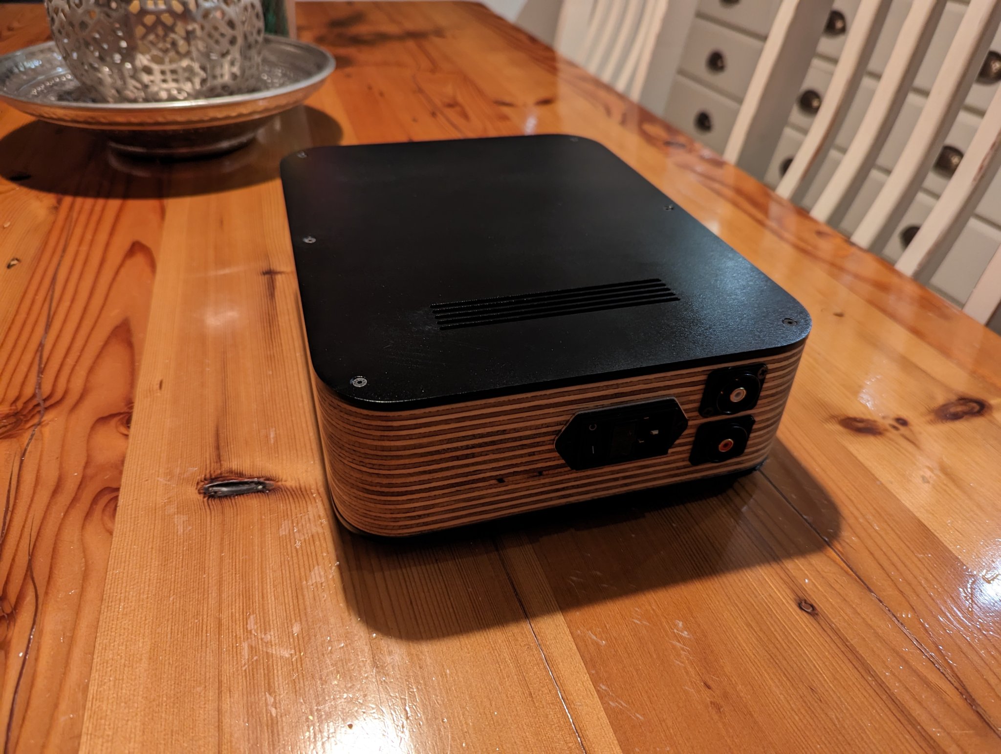

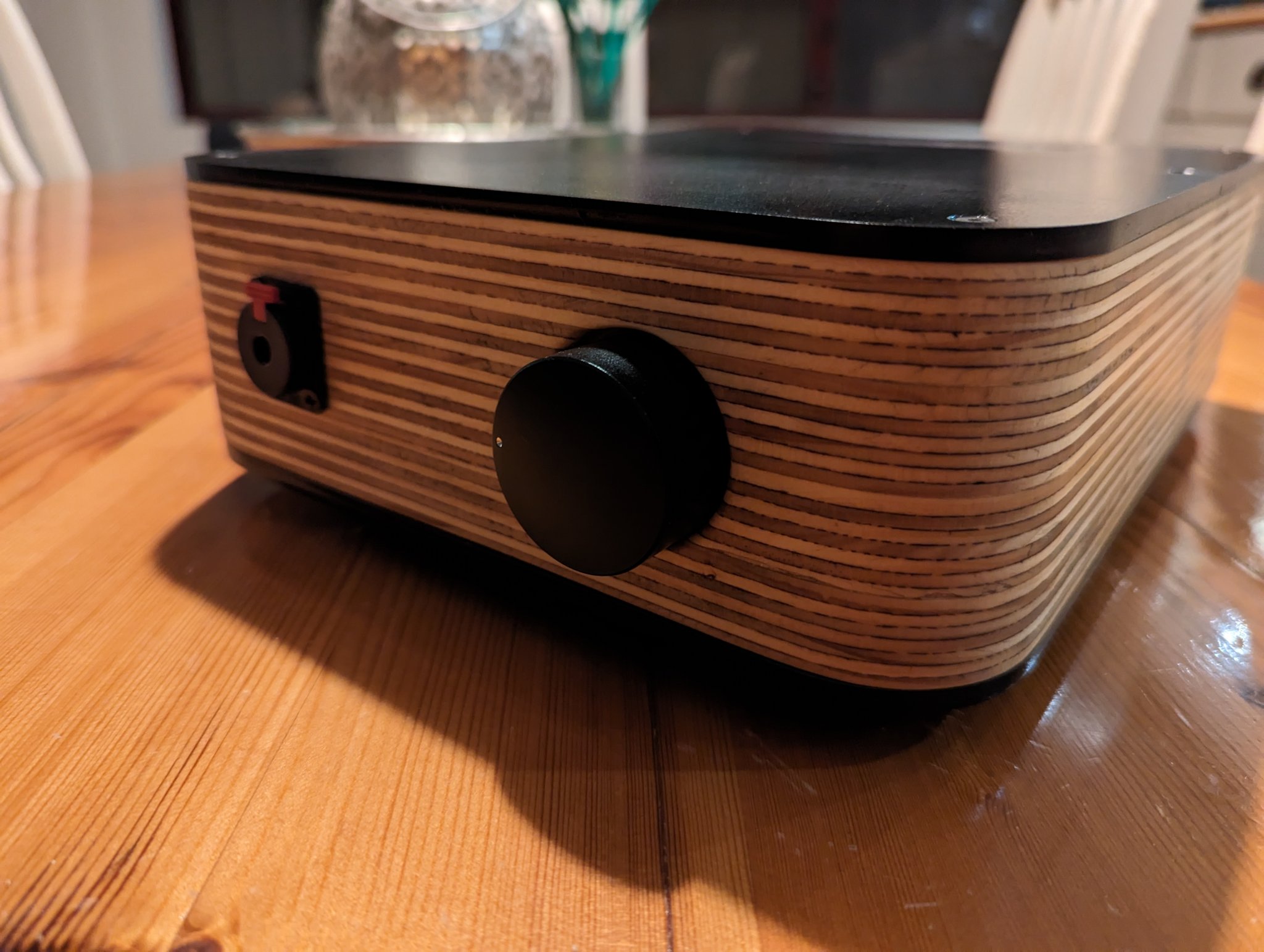

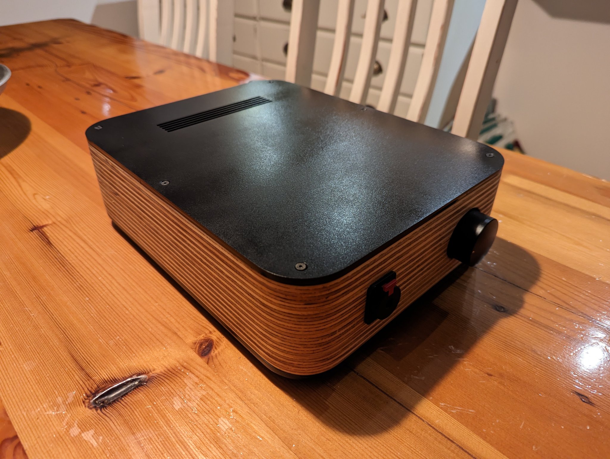

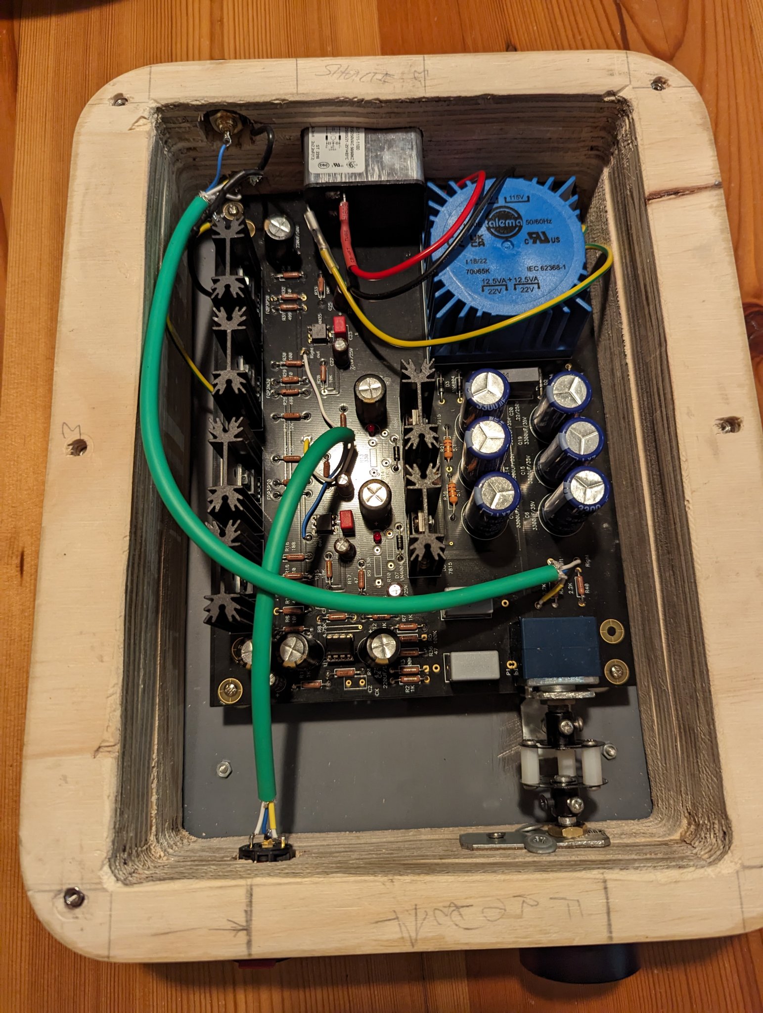

My build is done. Layered birch plywood, steel bottom and top plates. Worked first time - sounds amazing. Drives my Audeze LCD-X very well. Huge upgrade from portable DAC/Amp I used before. Changed the basic LM833 op-amp to a OPA2134PA - big difference, more timbre and sound stage. Very happy.
Congrats, looks good and safe! Enjoy your noiseless music experience!My build. Bottom yellow cable from power inlet into chassis earth. Left yellow cable to input cable shield. Black cable to input signal ground.
Very nice!! I didn't try the LM833, but other opamps, and I also settled on the OPA2134PA - to me (subjective) it is also the one that sounds best with this opamp, for exactly the same reasons you are pointing out. But other opinions may differ, of course!My build is done. Layered birch plywood, steel bottom and top plates. Worked first time - sounds amazing. Drives my Audeze LCD-X very well. Huge upgrade from portable DAC/Amp I used before. Changed the basic LM833 op-amp to a OPA2134PA - big difference, more timbre and sound stage. Very happy.
BTW, you could cover the inside of your wooden enclosure with tin foil (well, aluminium foil) for shielding. it should work beautifully with spray-on glue. (don't forget to connect the poil to earth.)
