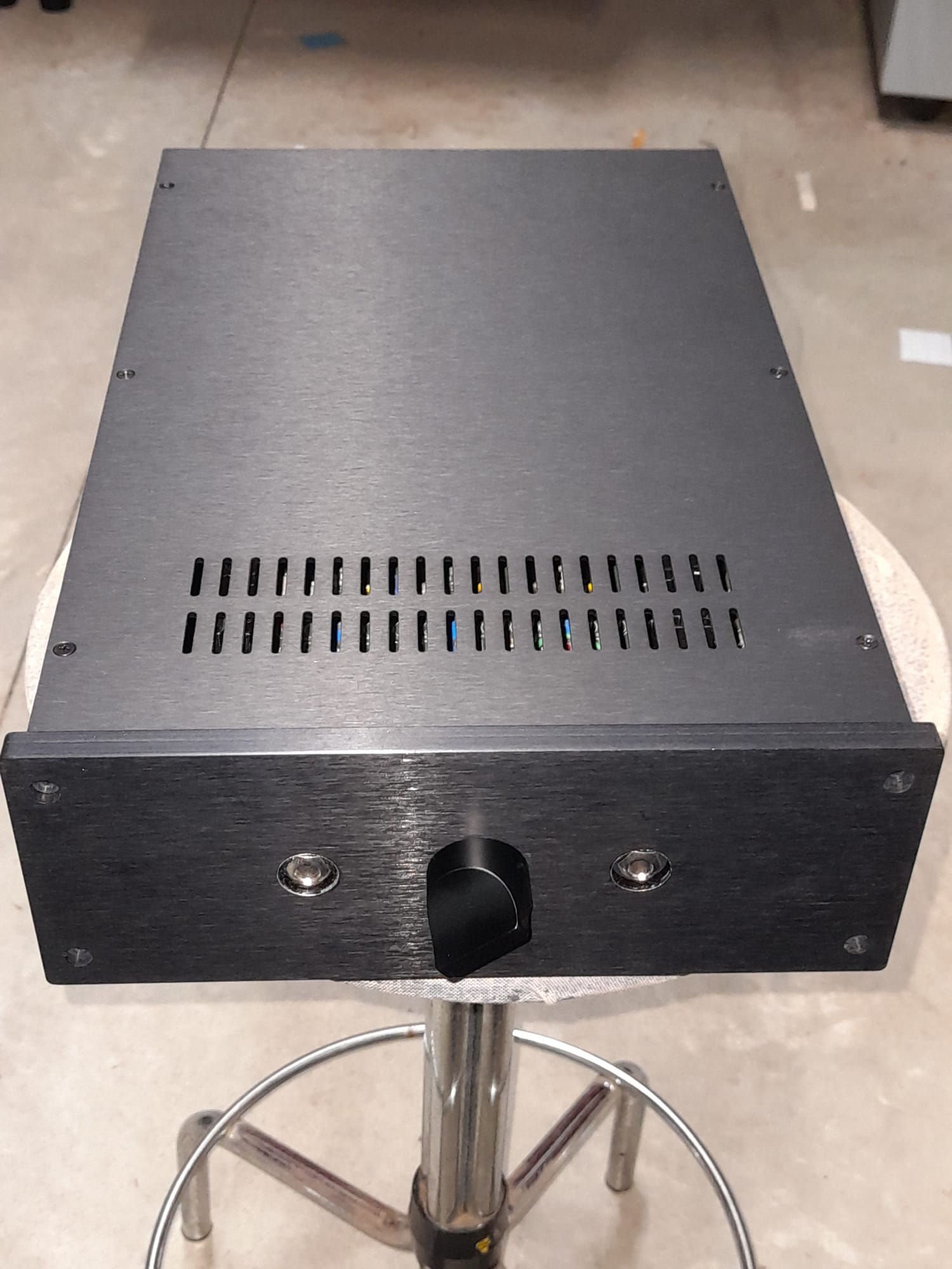

Long before the store had the Whammy boards, member Meldano made his own boards (I think it was still called the Pass HA at that stage). I bought one, including his universal psu, in January 2017. Today I finally finished it
First tests are that it sounds very relaxed, completely different from the scaled down Aleph I recently (finally) completed. So, now my wife has 2 headphone amps to choose from (until I finish another oldie, the Juma headamp; probably similar vintage) 😎

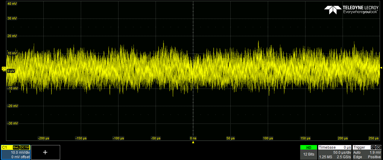

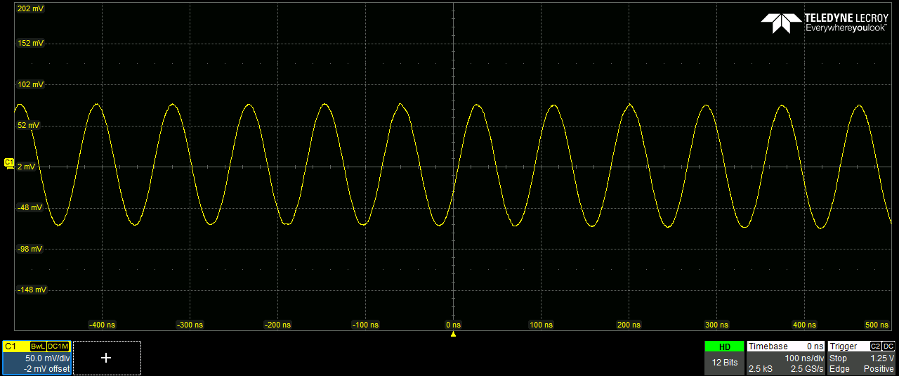

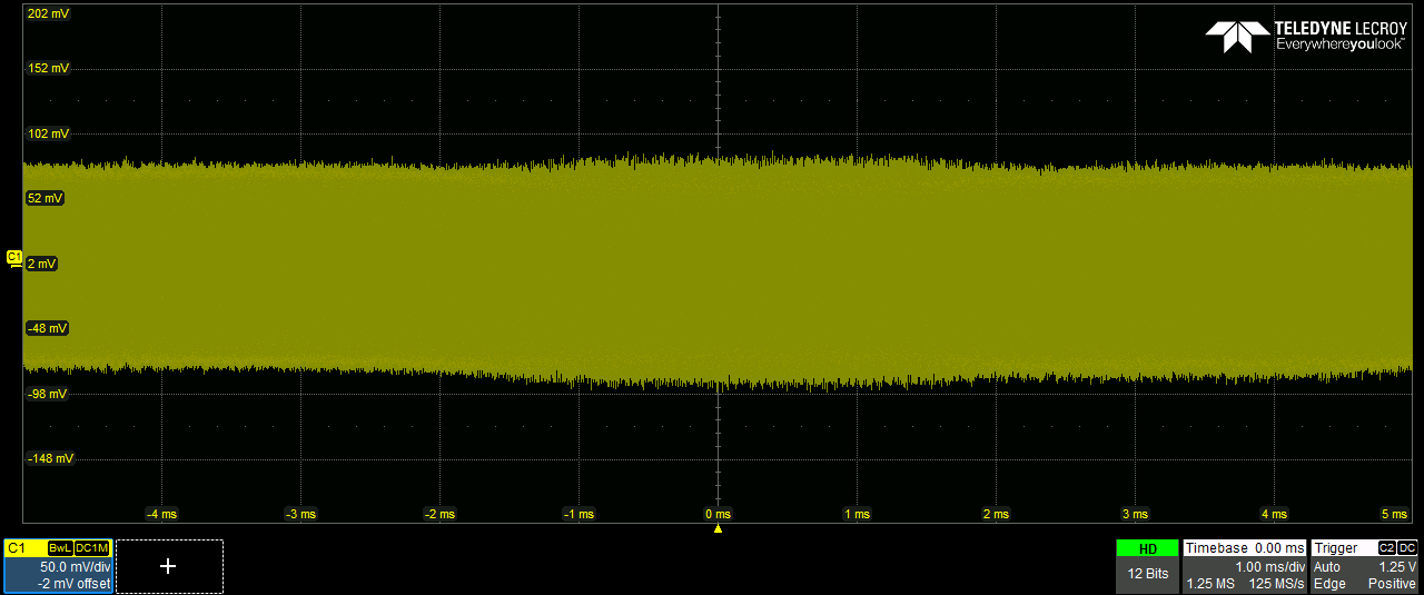

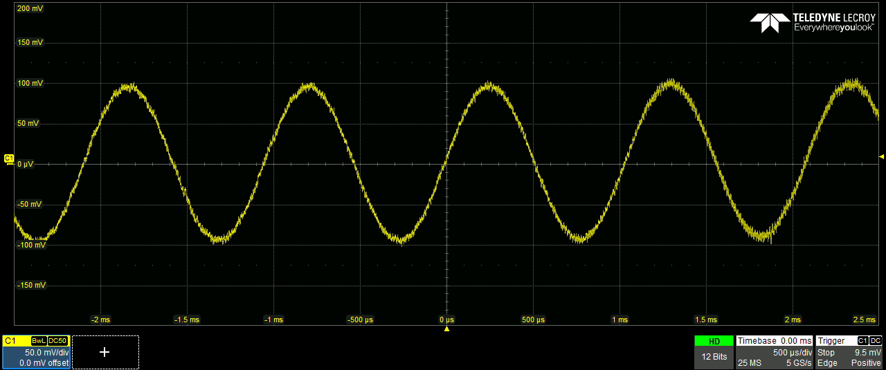

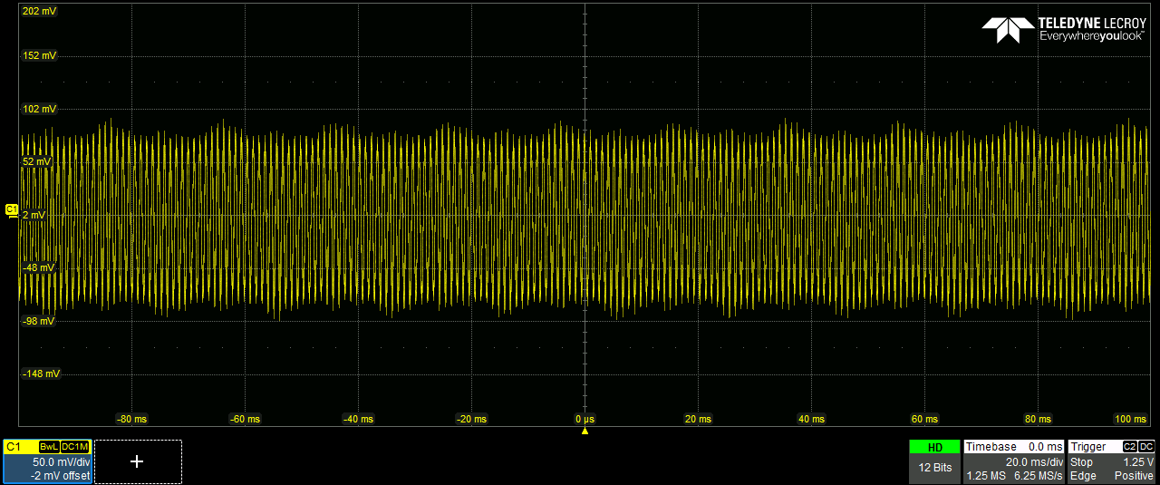

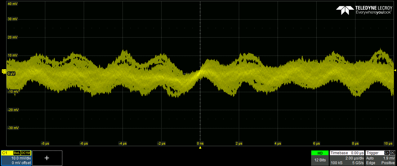

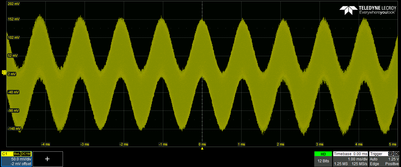

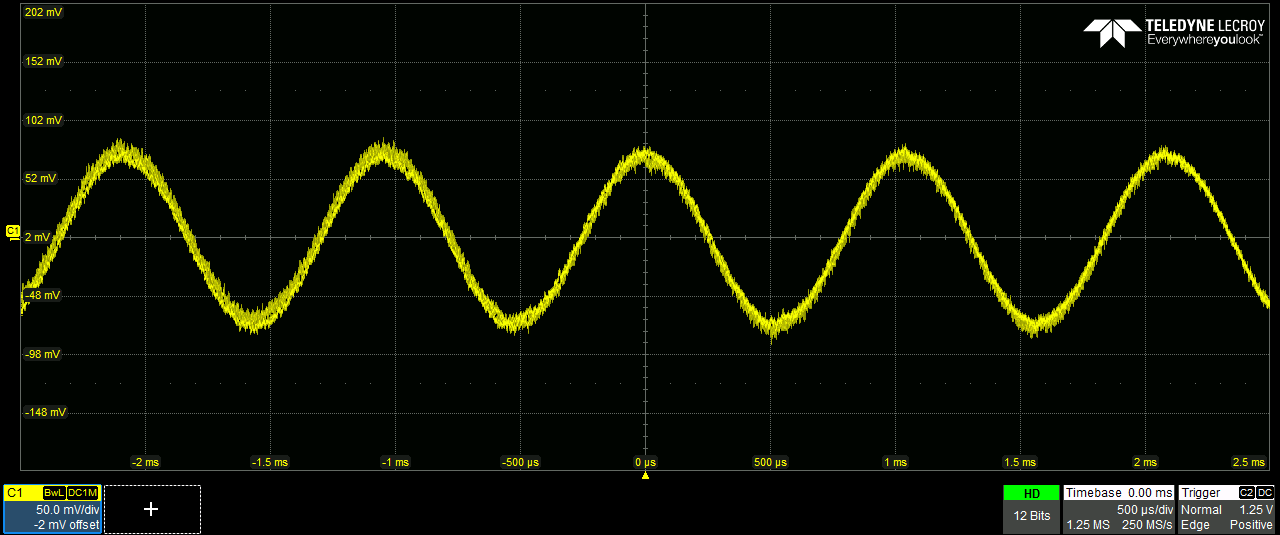

Hello guys,
I switched on the amp for the first time and I watched the output signal with a scope. Unfortunately I see some oscillation over the signal.
C2 and C7 are mounted and they are 100 pF. and the OpAmp is OPA2134. If I change the opamp and I use a LME49720 the signal is even worse and the output oscillates even without an input signal. I tested the amp without a load. The input signal is 1 kHz and it seems to be good on the pcb test point.
Please any idea?
Thanks!

can you post the noise output when you connect a shunter RCA plug on the inputs? (signal and sig ground connected together)?
do you have the same figures on both channels?
OPA2134PA should work perfectly, I have it in mine. LME49720 (which I also have tested in this amp) has a much higher BW, so it could explain why there are even more oscillations.
Are you using the officiel PCB and parts or did you add some modifications?
Cheers

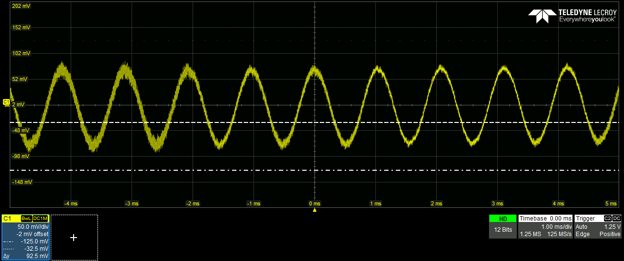

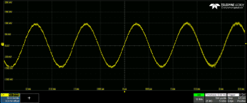

ok..tested with a 32 ohm load and it is better, I doesn't oscillate anymore, but still the signal is not clear, there is a modulation over the signal
Thank you Denis, I'm using the official PCB and parts, tomorrow I will take the signal with shunted inputsHi,

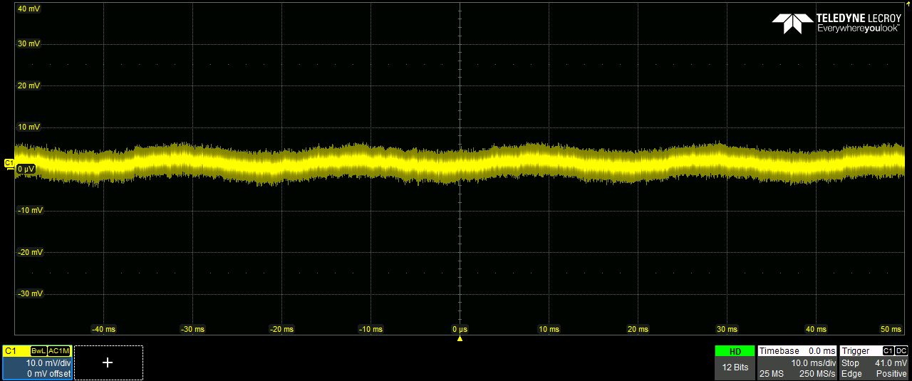

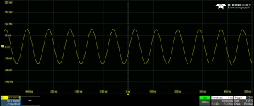

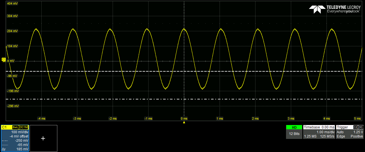

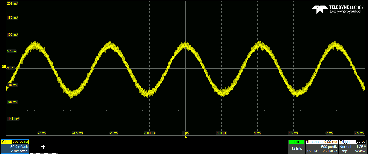

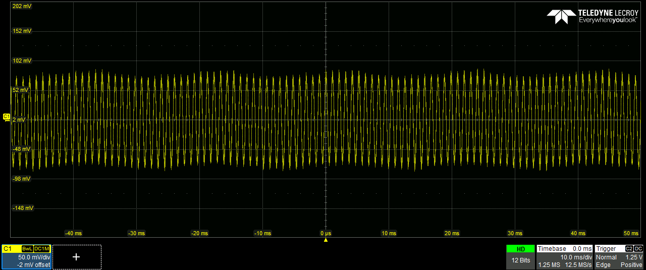

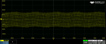

noise output with shunted RCA inputs. Both channels are the same.
Which MOSFETs are in the output stage? My WHAMMMY (the third M is for Mutant) shows good results with the IRF parts.same channel, both shunted, different horizontal scale

Yes, both channels show the same result.
I'm using the "naked" regulators and the output voltages are +- 15 V. The MOSFETS are FQP3N30/FQP3P20. I'm trying to understand if the noise comes from the power supply or it's picked up from some other reason
even though the LED version is the quietest of all, I don't expect the naked regs to be the cause of so much noise. What resistors are you using in the CRCRC of the power supply filters? what is the input voltage of the regs?
The yellow LED version approaches +-18v. Even +-17v is uncomfortably close to the "never exceed" rating of 2134 or 49720, and I prefer better margins in my circuits.
Just for grins & giggles, have you tried disconnecting the RCA and shorting the input to ground at the junction of C1 and R2?

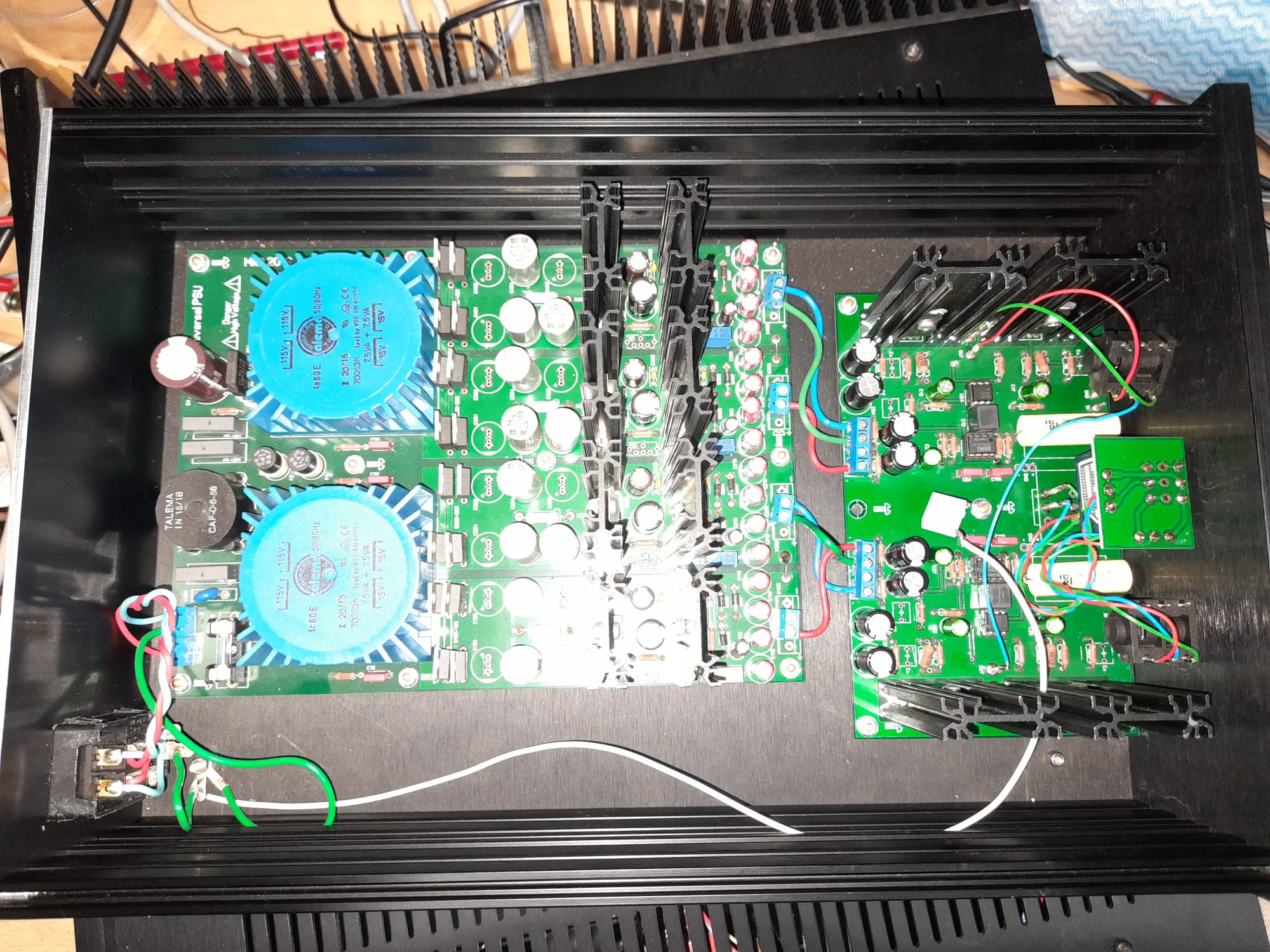

We might be able to see the obvious... if you cared to post a photo or 2, together with the CRO shots.
The output is likely a 1/4" stereo jack. If so, what happens if it's taken out of the chassis and hanging in the air? I wonder whether a funky ground might be causing issues.

As mentioned by Extreme_Boky and DSP_Geek, yes, proper grounding is key. Also, how are your chassis and signal ground connected to earth?
I think the noise it's just picked up from the probe. Connecting the output to the scope with a 50 ohm cable is much better. Also the amplitude of the signal wasn't very high. The ripple at the output of the power supply seems to be acceptable.
Anyway.. I think that a 12-bit oscilloscope can show you more than you can hear... With headphones I don't hear any noise at all and the sound of the ampli is very good!
