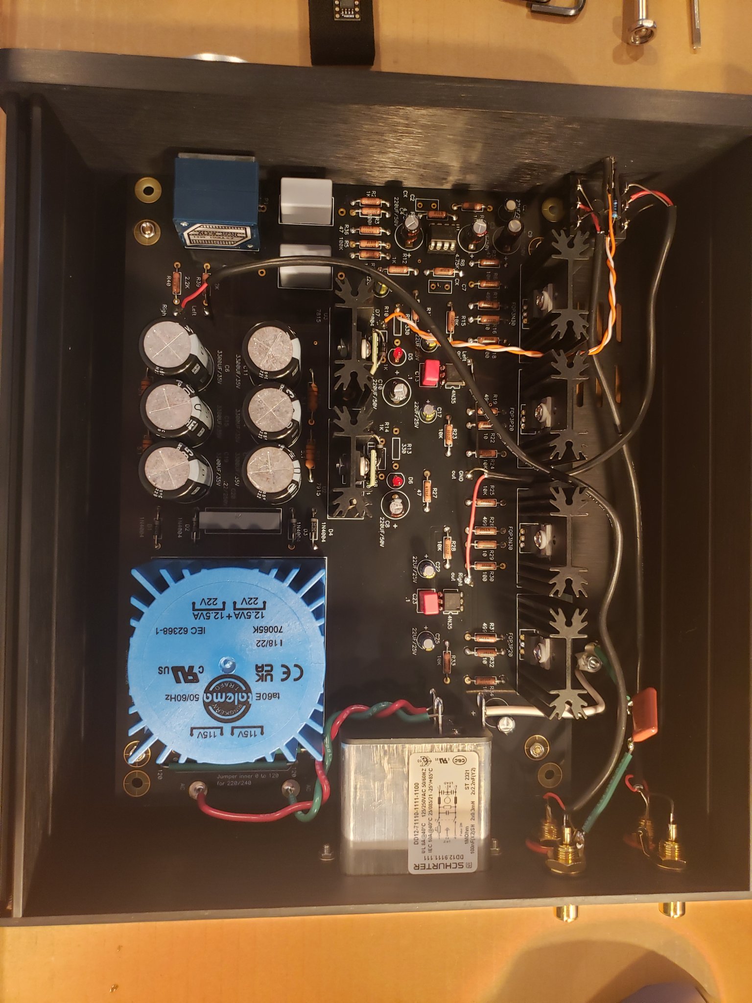

Hey there. I finally finished my Whammy after getting distracted by other things for a while, but I'm at a loss as to where the power LED is supposed to go. It's not on the schematic and there's no obvious spot on the board for it, though there is clearly a spot in the case. I'm sure I could kludge something together but is there somewhere that it's supposed to go?

In that review he talks about using a 20k resistor and wiring the power LED up to the C9 pads. Any issue doing that? The location certainly is convenient.
There isn't a dedicated spot for the LED on the boards. Powering from C9 is as good as anything!
another option is to connect an optical fiber to one of the voltage reference LEDs to transport the light from the latter to the front panel.

On the most recent kits, the 220uF/50v according to the board and the schematics were replaced with 220uF/35v and 220uF/25v. Can anyone please chime in on whether I should order replacements at the correct value or if these are ok. If replacements are suggested, which brands are recommended.
The 220s face 18 volts at the maximum with very little ripple current so you have lots of margin. I suspect the original schematic used 220uF/50v because Wayne had those in his parts box. 😉
Any of the above voltage ratings would be fine.
Only the caps C6, C11, C14, C15, C18, C19 in the CRCRC section between the transformer and regulators see about 33V. Here, you need at least 35V-rated caps. After these, the 7815/7915 regs lower the voltage further down for the rest of the circuit.
