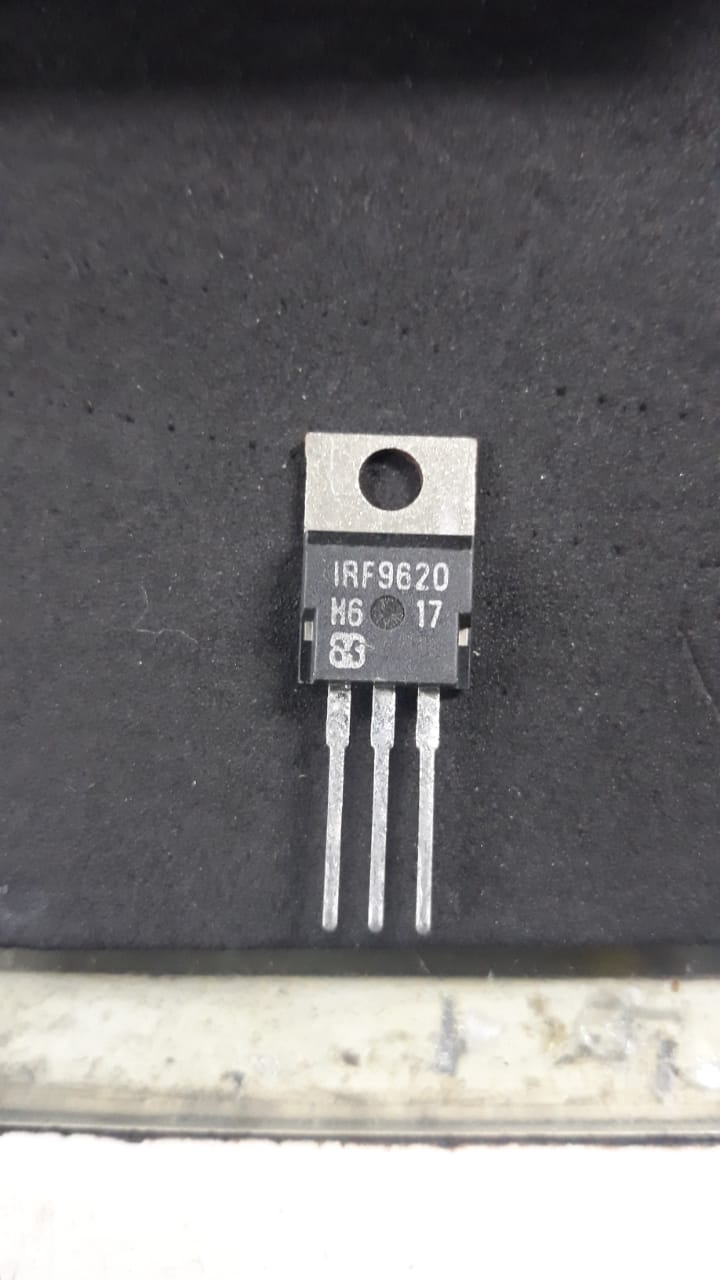

Are IRF630 and IRF9630 suitable for this project?
Sorry, actually i want to know if the IRF620 and IRF9620 is suitable here.

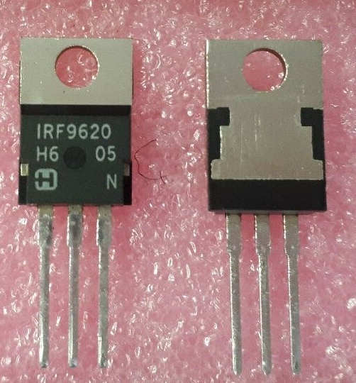

Not any more. Vishay and Infineon are licensed to build IRF devices. ON Semi and Harris also sell products carrying the IRF prefix, I don't know their licensing status. That photo appears to show a device featuring the Harris logo.

Sorry for the first post in Portuguese. I couldn't find the brand of these mosfets.
I thought they were harris, at first. They don't look like generic Chinese. But the Harris are these.
But now, looking closely, I see that they have the same design as the Harris and are not similar to other brands.

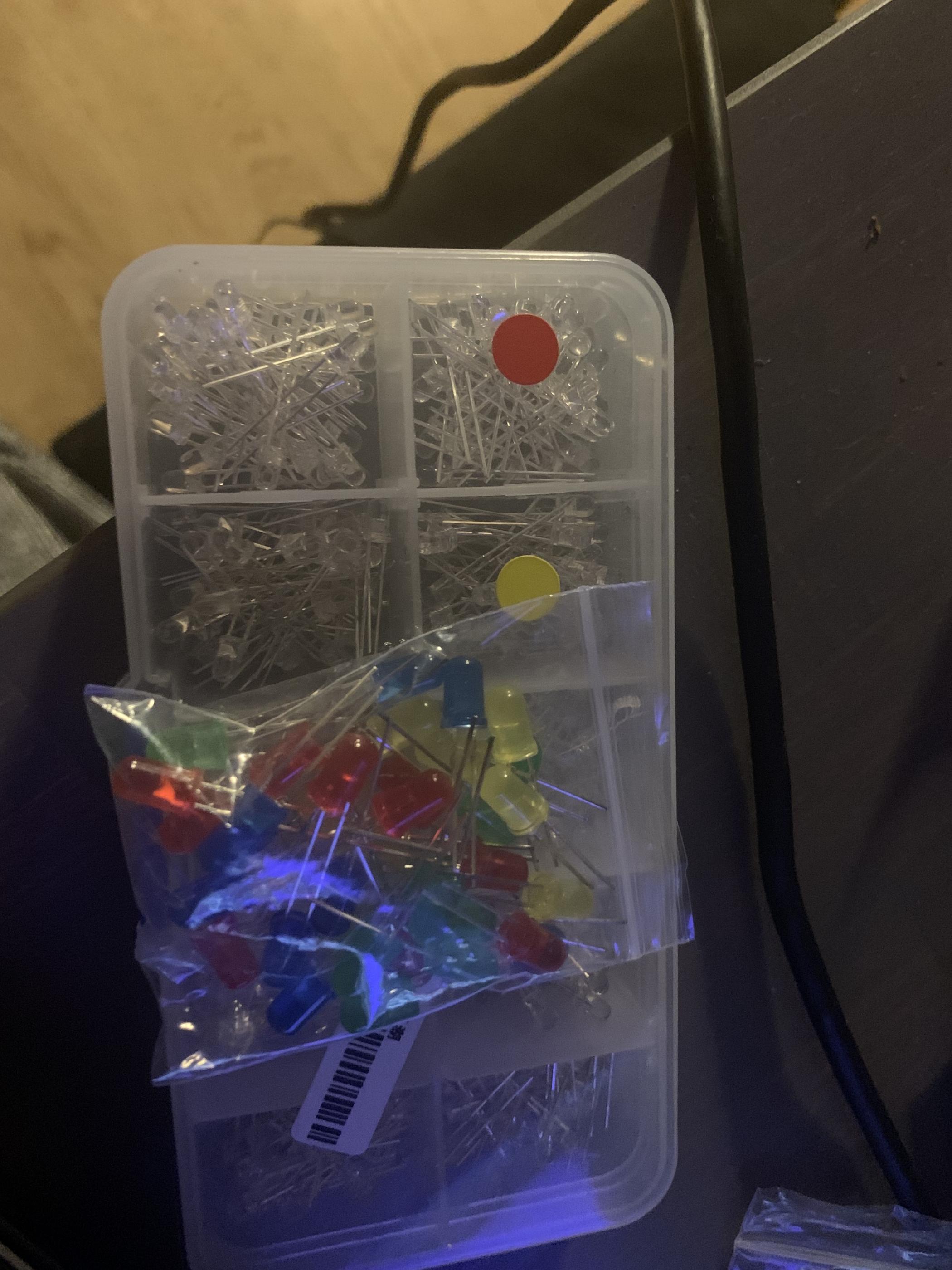

So since I gutted the old board to move the components over to a new I realised something, I won't be able to re-use the diodes because I can remember the polarity of them and have no way to check them. Now I have a bunch of these laying around the bag is from an Arduino kit and the box is from wish which would you guys think is the safer bet to use?

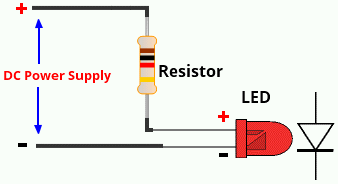

Most multimeters can test a led, if I am not mistaken. Also, a very simple led and resistor circuit to test them with any wall-type PSU would be simple to create. I’m sure others will have more pointers, but lighting up a led is really simple to do. You could do it with the Arduino you already have, but a breadboard would be simpler, I think.…I won't be able to re-use the diodes because I can remember the polarity of them and have no way to check them...

Test with 9V battery + resistor (nom 1K)
You can also identify the polarity of an LED by inspecting the internal elements, use a magnifier if you need to.
I just plug em into my Mega328 component tester and hit the button. Presto, the display tells me which lead is (+) and which is (-). The Mega328 is also quite useful to get the correct pinout of 3-terminal BJTs, JFETs, and MOSFETs. And it'll measure resistance and also capacitance, when the color bands are ambiguous or the printed values are small & confusing.
