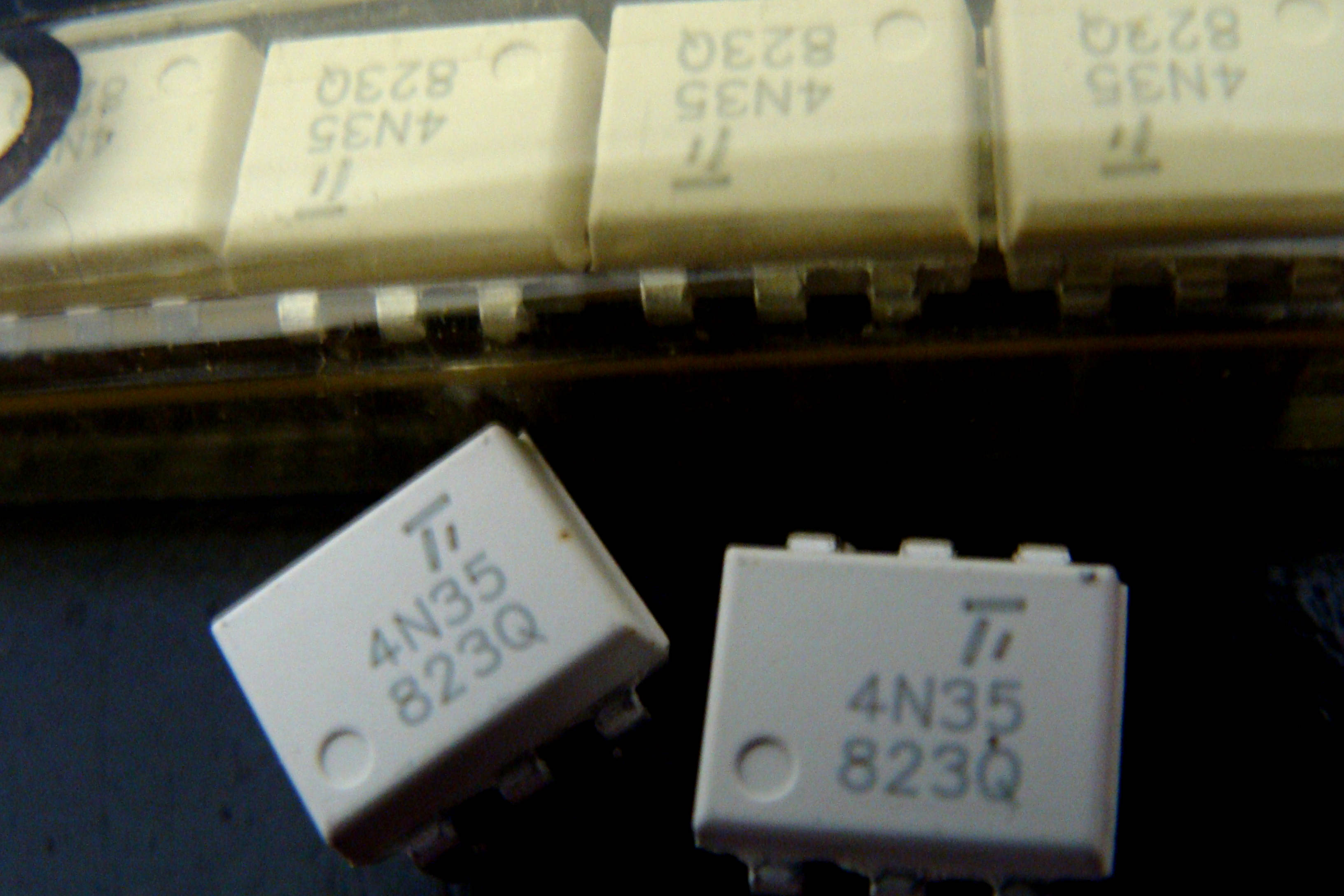

4N35
Does anyone know this brand of 4N35? Was it a Texas Instruments? Can I use it in my montage?

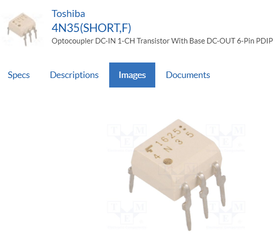

I did a google image search for 4N35 and the pictures of TOSHIBA 4N35s seem to match the photo in #3892. Toshiba has exited the optoelectronics business, those parts are old. You won't find Toshiba 4N35s for sale today on Mouser.com or Digikey.com or Element14
