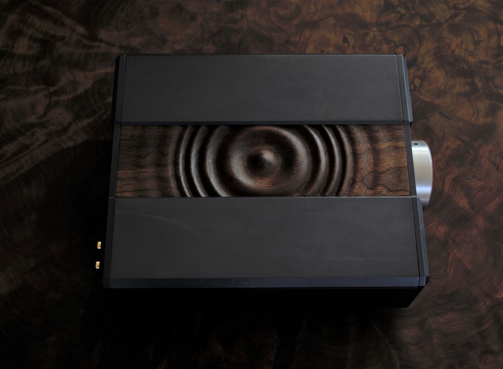

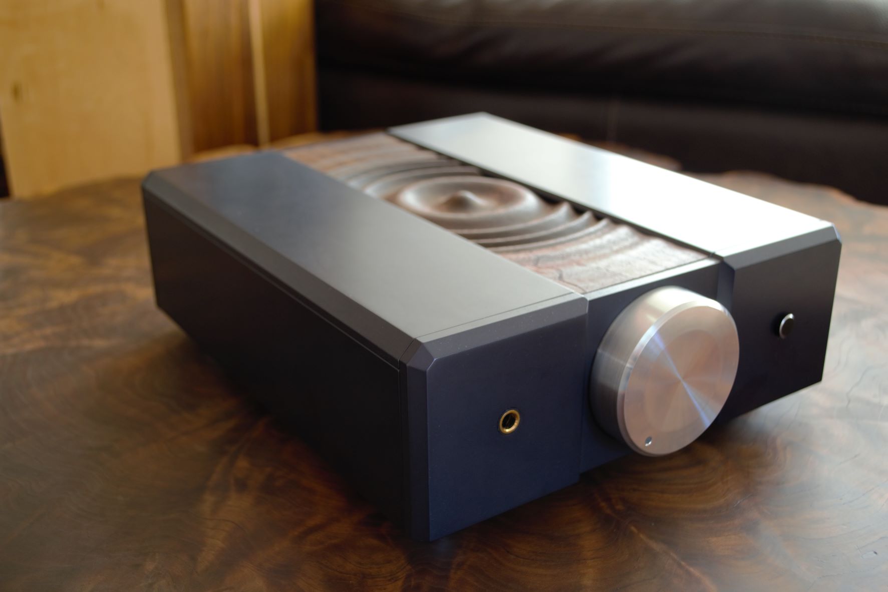

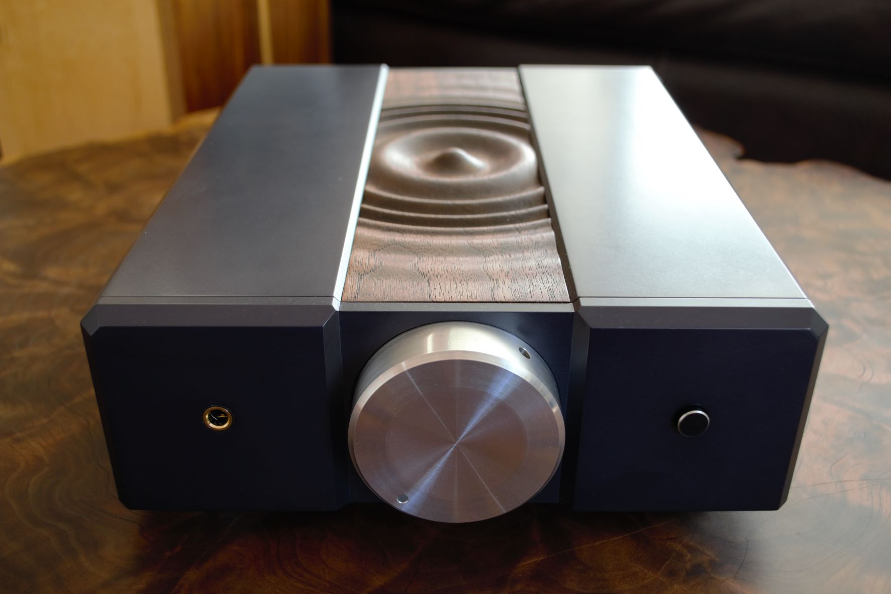

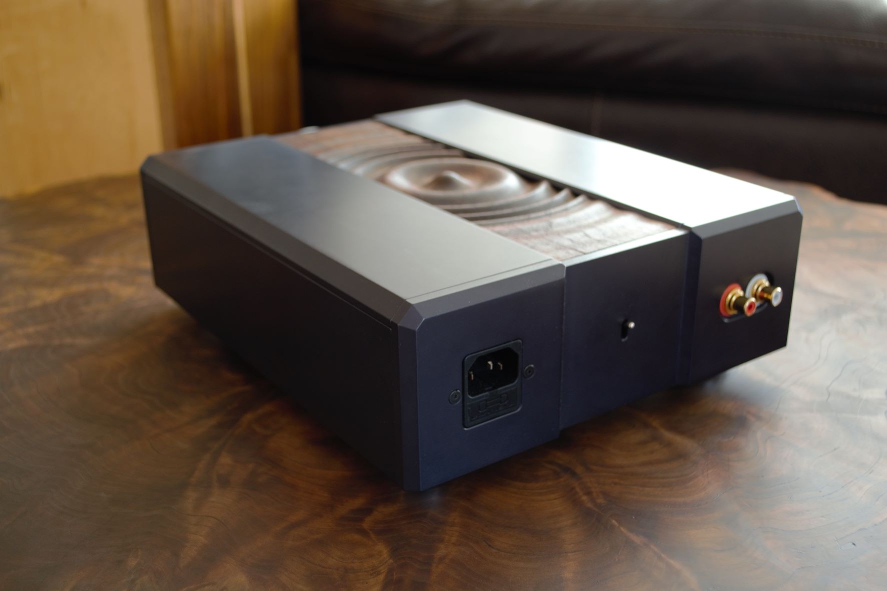

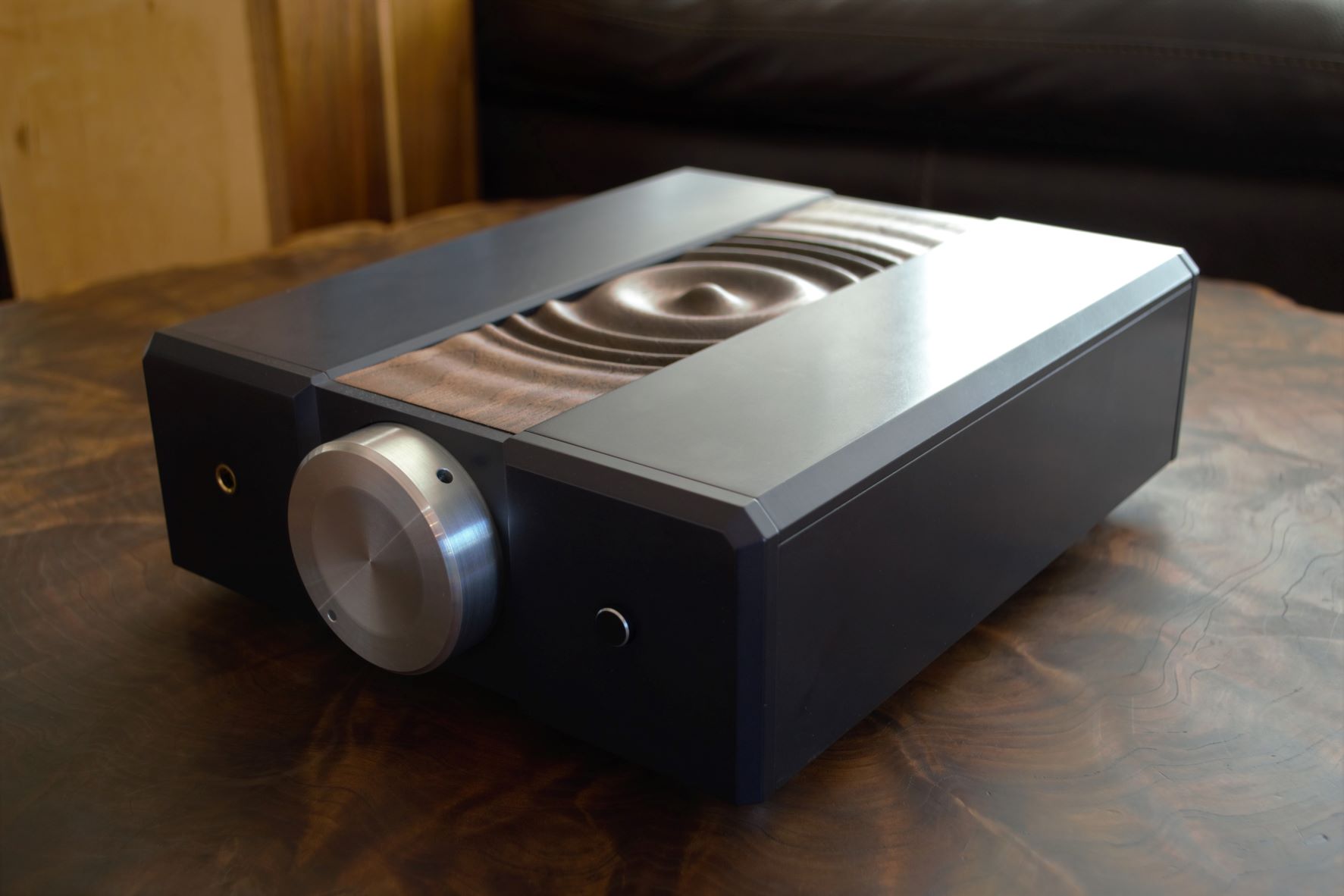

Yes, lovely casework. Where'd you get that wavy top? What is the rest?
I designed and built the whole thing myself. The main case is CNC machined aluminum that is gun metal grey anodized with a bare aluminum volume knob. I modeled the ripples of a drip of water in CAD and then CNC milled the walnut.
Very nice Puck77!
Do you have any more pictures of the build process? What kind of CNC machine are you using?
I am actually planning my second Whammy build and I was thinking of doing some similar casework (machined and anodized aluminum).
I am interested in how you are holding the individual panels together, the usual internal brackets with screws and shallow threaded holes? I was thinking of maybe using magnets or something clever so that the top could be easily removed.
I didn't really take any pics of the build itself. I realize now that I should have! The walls are pocketed on the insides so that I could put through holes in the pocket walls for screws that then mate to tapped holes in the other panels. The board is mounted on standoffs "upside down" to the top of the case. The bottom comes off with 4 screws for easy access to everything. I also cut mounting parts for the switches and headphone jack that mount to the inside of the end panels so that everything can be cleanly mounted so no nuts are visible from the outside.
I cut all the parts on a 3 axis CNC. It's a Hurco.
