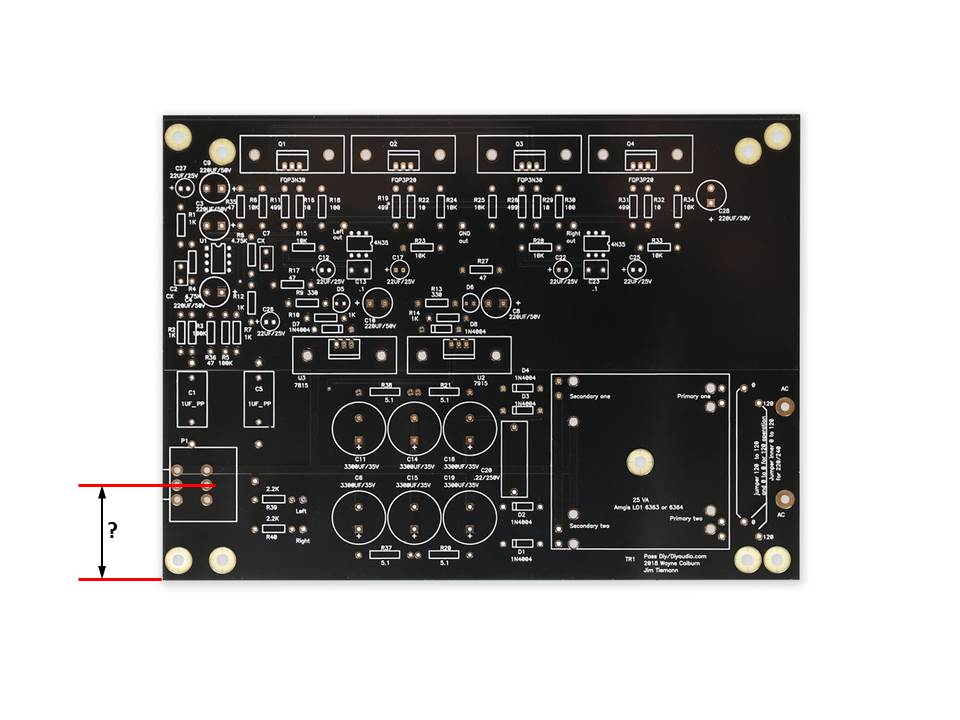

Hi all,
Does anyone have the latest version of the unpopulated WHAMMY PCB from diyaudiostore.com and a pair of vernier calipers sitting in front of them? I'm looking for a specific dimensions for the design of a custom front face.
I'm still waiting for my PCBs to arrive (long postal transit times are one of the downsides of living in New Zealand), but need to get cracking on the custom front faces if I'm to get the completed item to my brother in Singapore in time for his birthday at the end of August.
To that end, I'm looking for a specific dimension (preferably in millimetres please!)from the side of the PCB (as you look at it from the top) to the centre line of through holes on P1 (the attenuator). I've included a photo to explain it better than my words can.
Once I have this dimension I'll be able to dimension the front face cutout for the attenuator.
Thanks in advance 🙂

It is not necessary to mount the RK27 Alps pot directly to the PCB. In fact, floating it on leads allows it to be centered vertically on the front panel and (in my opinion) makes drilling and mounting it easier.
