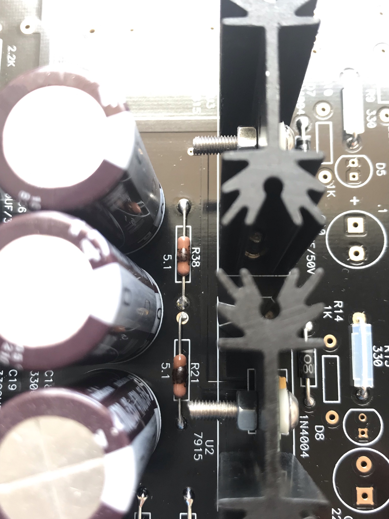

some help !
Hello,
so, I started to stuff the circuit and I stopped at the power part as planned and luckily because I blown two resistors.
I am almost sure of the reason, but I would like to have confirmation of it. The resistors that have burned out are R38 and R21 and I think it is because of the scratch I made on the circuit board. My soldering iron slipped and this is the result.
If it is because of that what should I do, change the PCB?
do I have to check, too, the capacitors and diodes? (by the way if someone can explain to me how)
small precision, Snubber capacitor C20 0.22uf 275v 4700uf 35v for crcrc and for regulators,

I just realized that my photos are not visible, sorry we would have to explain that to me too, noobie until the end.😱
Those resistors might be too small. Are they 1/2W at least?
Where's the scratch? In any event, removing some of the solder mask shouldn't cause that kind of problem unless something touches it.
I think those may be the incorrect resistors, I believe they should be 1/2 W rated or larger.
Also, check the orientation of your diode at D7, it looks like it is the wrong way around, hard to see in the photo though.

it works
I wanted to thank Rikiheck and Jermnz again because thanks to them my psu works.
Like a perfect beginner idiot I had put 3 diodes upside down and resistors not suitable for the CRC.
I would pay more attention to the rest. The new test went well and the measurements are correct. 😀
I even started to fill in the rest 🙂
