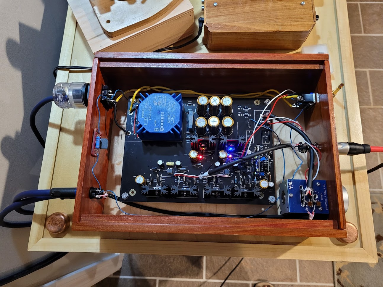

If you use something other than the ALPS pot, then the best thing to do is to run the input cables directly to the pot, and bypass the connection on the board. Then run the output of the pot to the CENTER pads where the pot would go, and the ground 'output' from the pot to the LEFT pads (looking at the board from the front). The RIGHT pads will then be unconnected: those are the output from the board to the pot. (The grounds from the input jacks can still go to the same place on the board.)
This skips the traces on the board, gives you one fewer mechanical connection, and makes everything quite a bit neater. (I've built four Whammies now and have tried a lot of different arrangements!)
The only thing you need to consider here is the 2.2K input resistors on the board. Wayne said in an earlier post (I asked about this) that, in most cases, it's fine just to leave them out. In the end, though, I just soldered them to the pot input and connected the input cables to the resistor. The Whammy already has a lot of gain and leaving them out could make that worse. Use a bit of heat shrink over the connection to the resistor and it's very solid and safe.
You can see it in the picture reasonably well. On the pot, the inputs are the bottom; the output above that; the ground outputs are hidden under the black wire.
You should run a wire from the pot body to earth ground. In the picture, that is the thin blue wire.

on the other hand if I wire the pot with short shielded cable, as close as possible to the board and that I wire the pot to the chassis ground on the rca input with the small capacitor would that be okay? the pot would be on a support with an extension of course.
I'd wire the pot to the other side of the cap.
Note that, in wiring the pot to the board, you basically have to do the same thing I described. You just have another wire: the one for the input to the pot.
