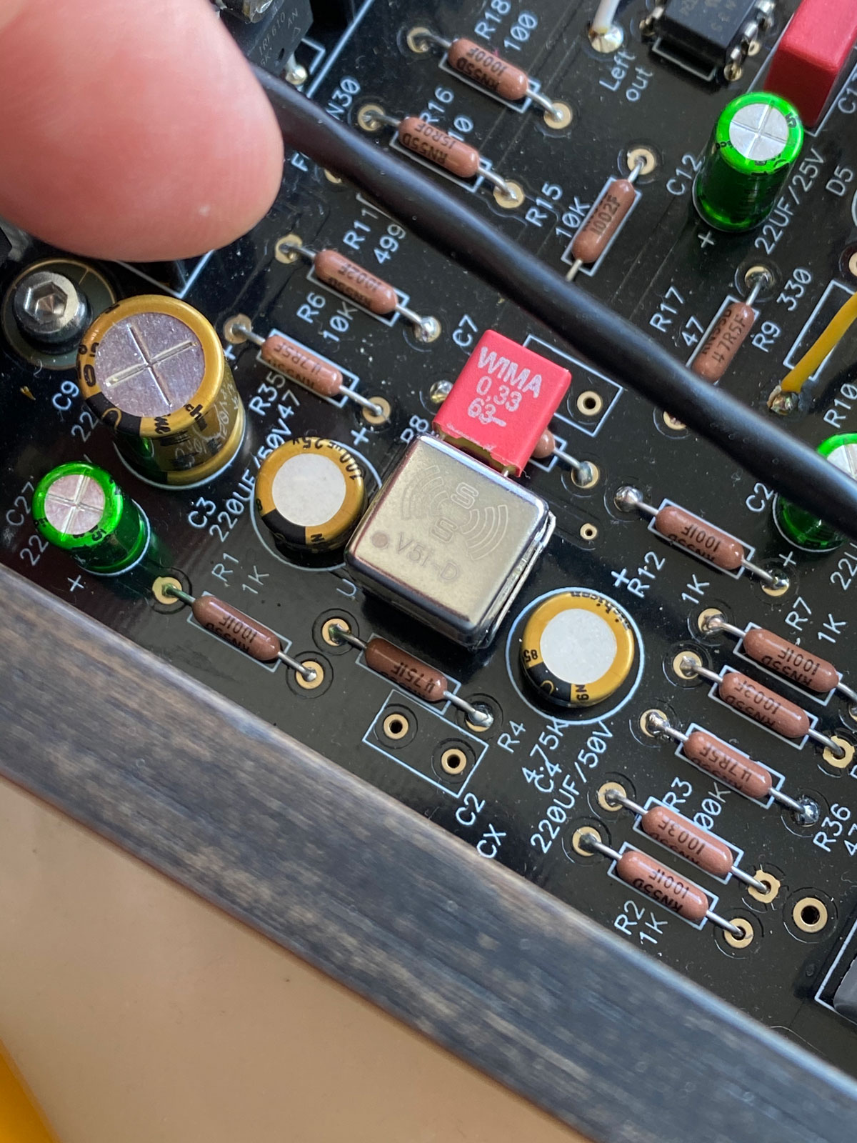

This mod? See pic. I did that to keep the voltages within the Burson spec per some of the previous posts in this awesome thread. The amp was quiet before though... so that's probably not helpful! My other amp—the one I'd send you—doesn't have that mod... it's ghostly—can't really use the term "noise floor" with it....post some interior pics of your build...
What're those low profile Nichicon 100uF 25V caps next to the Burson?This mod? See pic. I did that to keep the voltages within the Burson spec per some of the previous posts in this awesome thread. The amp was quiet before though... so that's probably not helpful! My other amp—the one I'd send you—doesn't have that mod... it's ghostly—can't really use the term "noise floor" with it....post some interior pics of your build...
Technically under the schematic spec... but been working out just fine—and easy access for opamp rolling...(I'm not sure if they made it into the new/forthcoming chassis parts makeup kit...)
Yup that mod. Will post pics when I get home.

This is really interesting. I was sent both the V6 Classic and the V5i to try out on the WHAMMY. I have delayed a review because the V5i does not work as expected. It gives out some weird "robot like" sounds... remember the drone that lands on Hoth on Empire Strikes Back? That kind of sound. The V6 is DEAD SILENT!This mod? See pic. I did that to keep the voltages within the Burson spec per some of the previous posts in this awesome thread. The amp was quiet before though... so that's probably not helpful! My other amp—the one I'd send you—doesn't have that mod... it's ghostly—can't really use the term "noise floor" with it....post some interior pics of your build...
If I click the top of the Burson's metallic casing, I can "change" the blip's characteristics. So there is something amiss. Also, I mentioned I have an 18V rails (led reference regulated PSU) and it was mentioned here that it would be a little less on the rails of the OpAmp, so that "I was good to go".
So, I am looking at fixing and really "trying" the V5i, so I installed a 0.1uF between pins 4 and 8, but I don't it made any difference.
You have gone much higher with 0.33uF. I don't think I have those at hand, but I would measure the V rails properly and see if this could be the source of my problems.

Hey Rafa, you were the one that turned me onto the cap mod to bring the voltages into spec. At the time I was unaware of the Burson voltage requirements. I ran it without that mod for days, and really only did it to make sure it was good for the long haul since I really like it. I too evaluated the V6 and V5i. Much preferred the V5i! But they are both great—my sorta mini review is many pages back in this thread. No issues with weird noises with the V5i....Perhaps you need them to send you another for eval? I had the .33 on hand... not sure it would make a huge amount of difference?

Regrettably, I don't have another equipment that uses an OpAmp where I could test it. Maybe I can create a small test bench to see if the issues reside within the specific V5i I have or if it somehow related to my Whammy implementation. I did not install C2 and C7, maybe that could make a difference?

On the plus side of "installing extra things to try a particular OpAmp...", I believe decoupling caps for opamps are a common practice. A 0.01uF or 0.1uF shouldn't be an issue with any of these common opamps, right?
